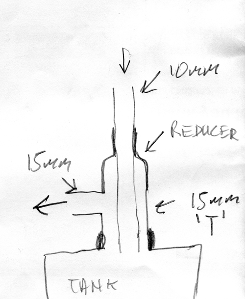

Ive been slowly building up the bits to install on board air on my pajero. Im going to try using the AC pump and a converted gas cylinder as the air tank. I've got a 120psi cut off switch, 150psi pressure release valve and an inline oiler for the inlet.I think im going to use push fit 10mm air line to run outlets at the front and rear.
Don't forget that any oil sucked in will be blown out - not ideal if you're inflating tyres with it. You may need a filter on the output.

is that a solder fitting
