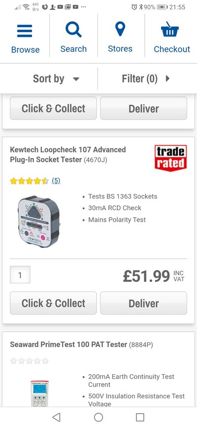

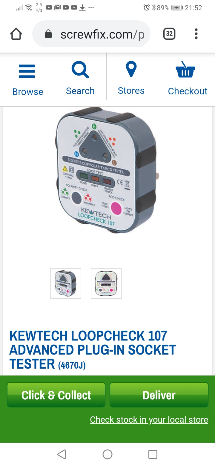

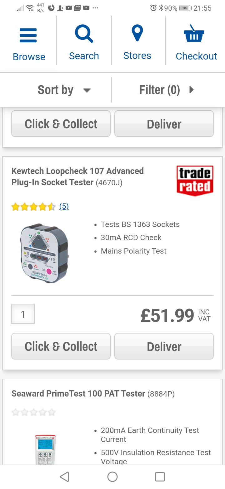

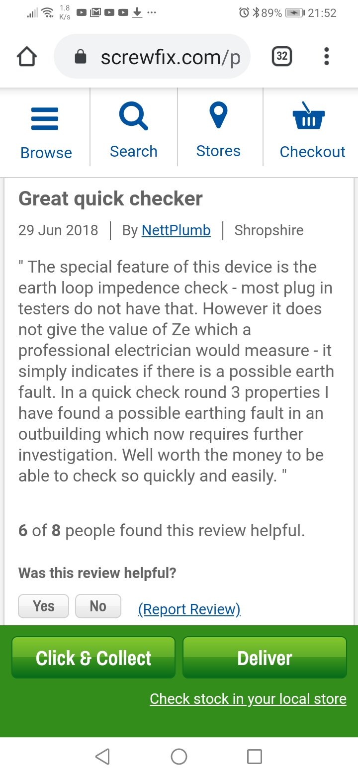

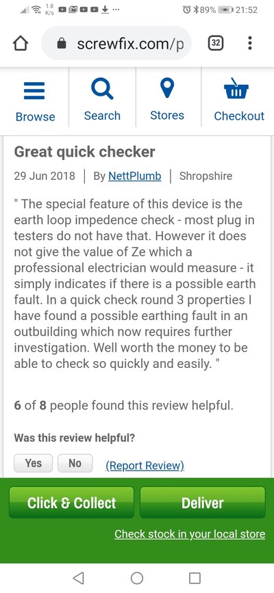

if your getting a shock of anything plugged in to sockets and touching the sink there possibly is an earth come adrift and you would get 50 volts across them even without any faulty appliance id just have a check done that your sockets are properly earthed and make sure your gas and water are bonded and the mains earth is correct
