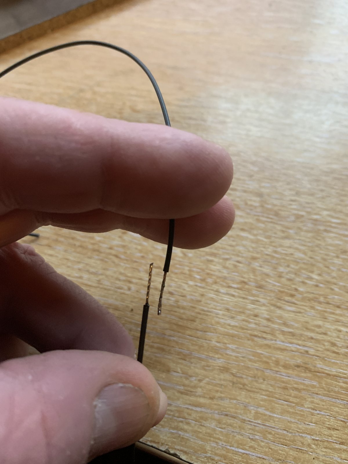

Grasp one wire between index and middle fingers, the other wire between thumb and ring finger. You'll find you can move the wires into position nicely. Just don't hang around with the iron, heat travels up the wire if you do.
