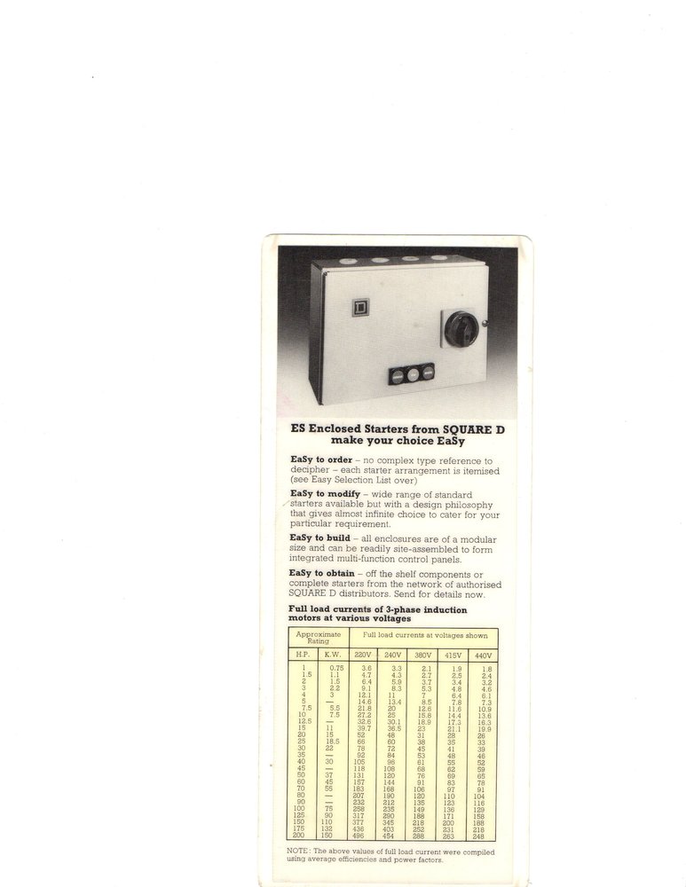

Very useful for future ref!This is a useful chart from Square D motor controls from years back, 4hp 3kw motor @ 415v is 6.4a per phase
4HP is 3kW?
3 phase is fed by three conductors?
1kW per phase?

Do any of these calcs take into consideration startup current or longer leads
