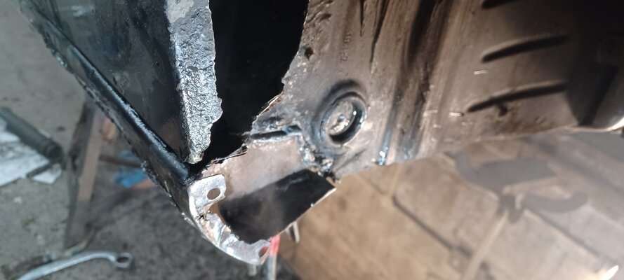

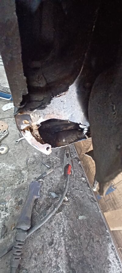

3 hours work later and one corner looks a lot better...going through the mot faliure list of a customers audi a5 3.0 quattro.
arms and welding.
welding might take a while....
and that's just the obvious bits.
they're FAI arms, btw, not autodoc specials, i just needed the torque settings and autodoc club is the easiest place to get them.

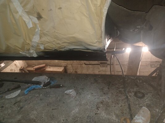

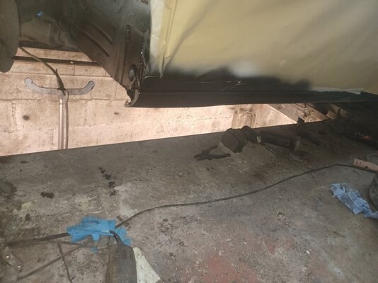

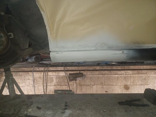

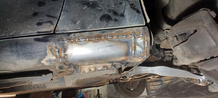

question... what freaking moron decided to line the insides of the sill with 5mm thick rubber..... makes welding... interesting.
rear sill returns welded in, all underside rust and scale flap wheeled, needle gunned and wire wheeled back, covered in rust reform and painted,3 hours work later and one corner looks a lot better...
