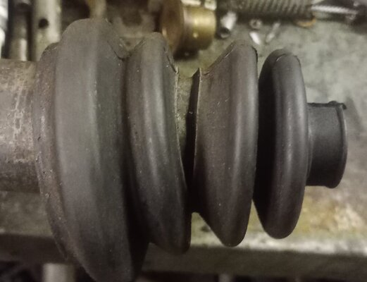

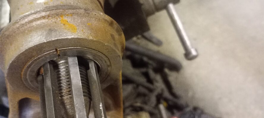

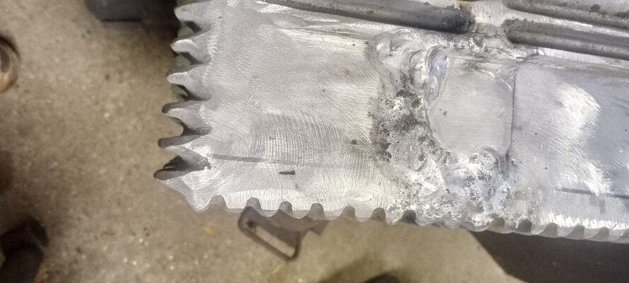

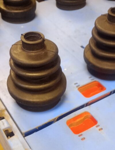

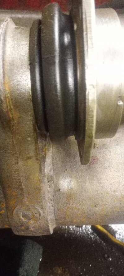

Should have called the puller manWell I tried everything I could think of including welding a puller to the split collet thingy but it would not budge, broke the welds and then the puller, I had bought a box of 20 or so CV boots from Ebay, £20.00 delivered so I chopped one up and did manage to get it over the ball and flange, worked a treat, two done two to do! I think the bit I cut off may do a TRE boot!

If there is something to grip, the collars would not take a mig weld, no penetration, maybe cast iron??Aye, me.

I've got a different type of expanding collet pullerIf there is something to grip, the collars would not take a mig weld, no penetration, maybe cast iron??

Nothing to grab onto from what I could see, flush outside, almost flush inside plus a chamfer, Drilling it through might have worked but Halfords are out of stock and I would have needed to drill out four and remake..................... I think they could have been very hard rather than cast............. anuhow I worked arounf them.Never had that done,is it costly?I sent four of the six wheel cylinders and the master off to Past Parts last Friday to be sleeved in stainless, got the back a week later (two rear cylinders were ok after a hone)
