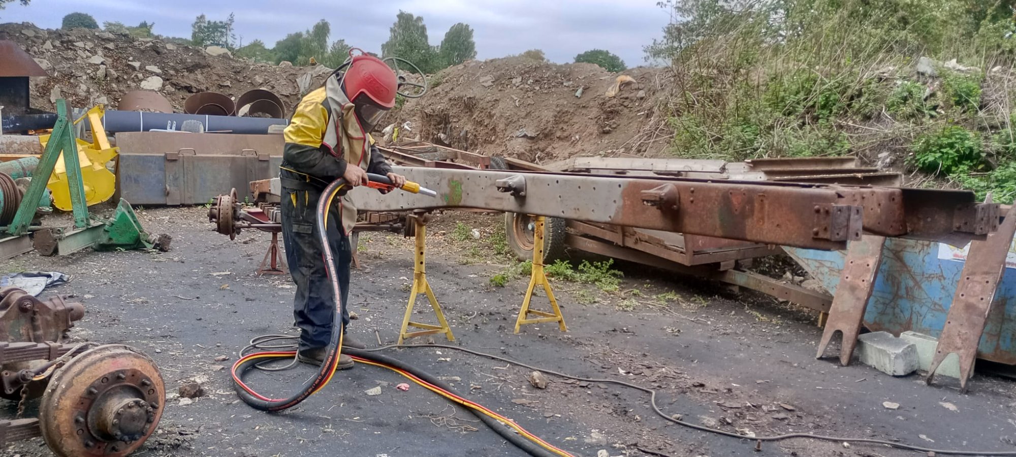

Made from virgin steel, not re-melted rubbish!I cant believe how little rust there is.
REME was formed on the 1 Oct 1942,You might find REME at work pictures using them around October 1942 at El Alamein

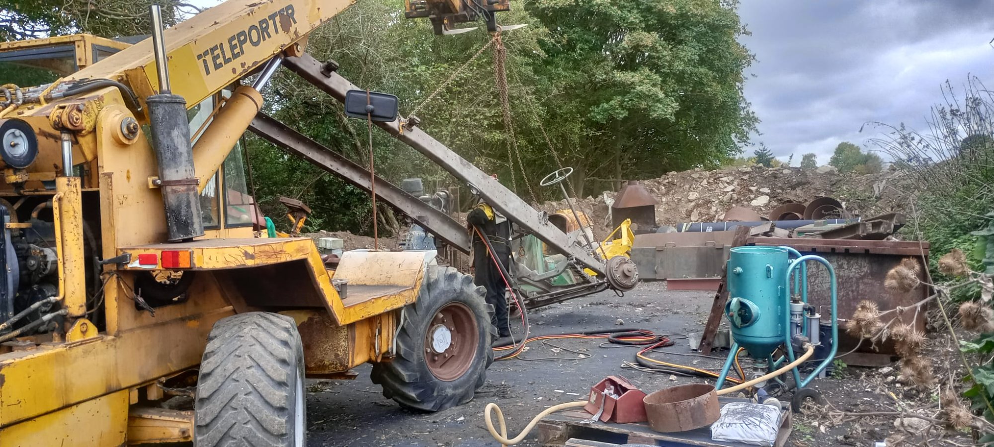

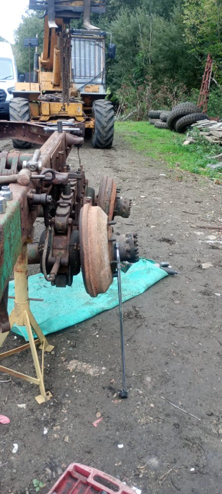

Your garden's looking a right mess, PatView attachment 513053View attachment 513054View attachment 513055 I had to remove the rear suspension to tackle some rust between layers where the chassis was double skinned for the axle mounts!

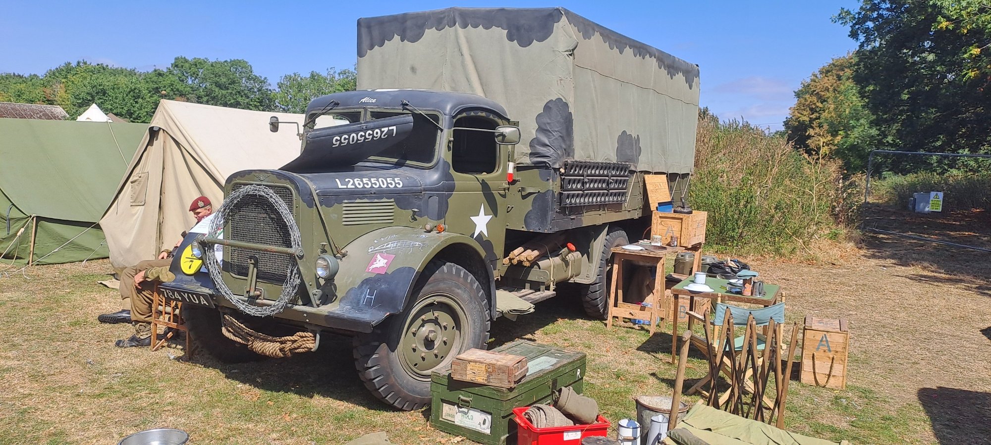

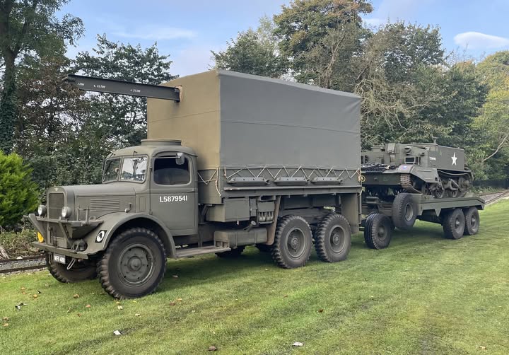

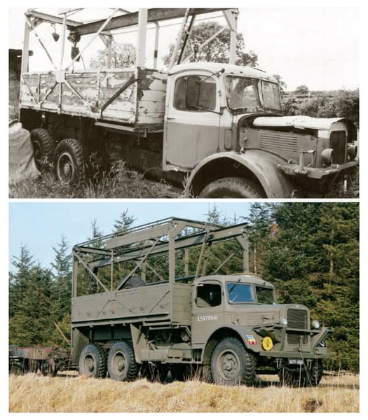

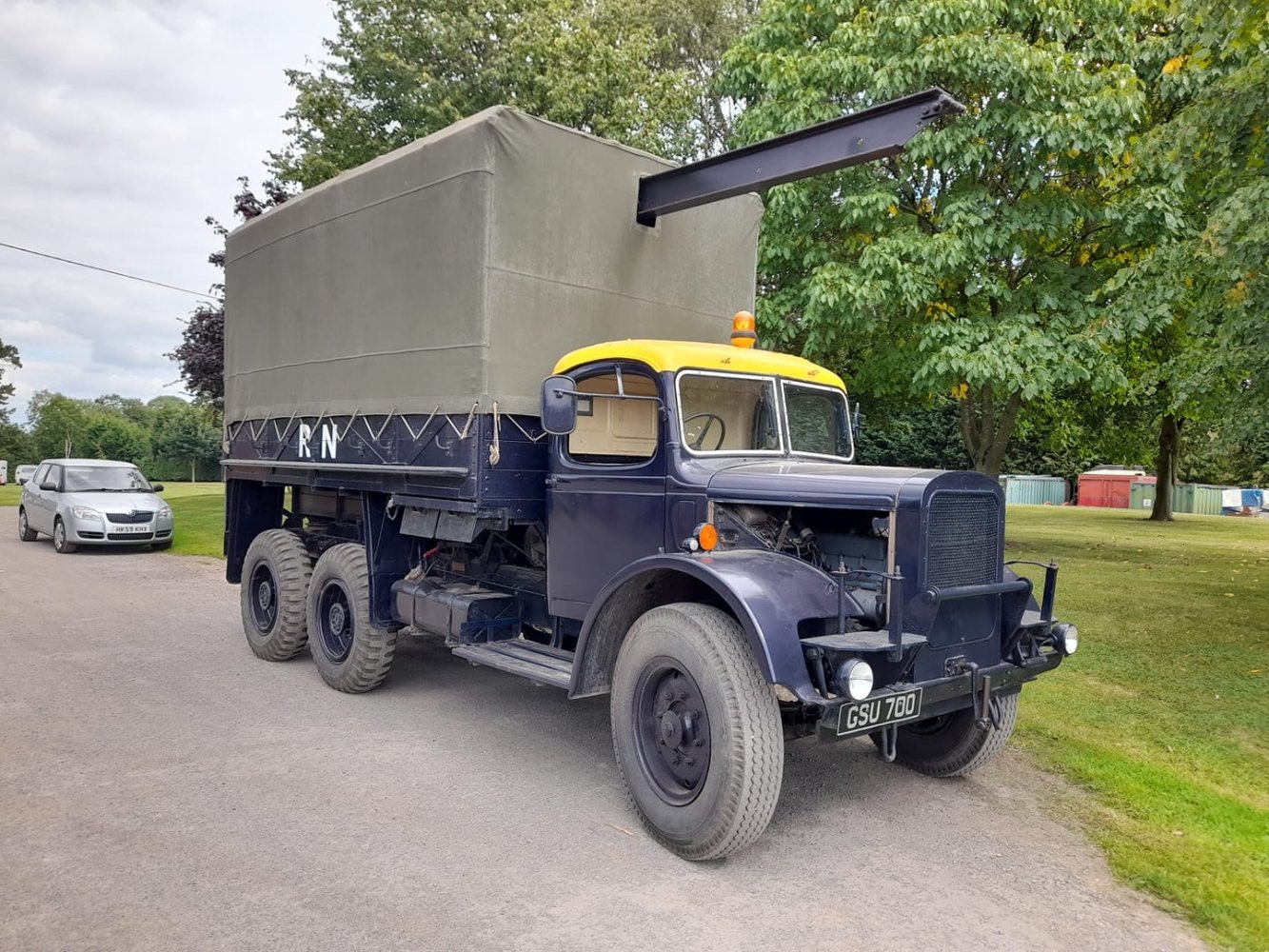

Mine was originally a gantry truck, but all the gantry and support structure was missing when I got it, still had the 5 ton winch, I will be building it as a GS lorry as I could not get a gantry truck through the access into my garden / workshop! The first 3 pictures show gantry lorries, the last something like what I am aiming for, except my canvas rear body will be lower, maybe raiseable once in my drive! the very high floor level on the gantry trucks is due to the massive winch mounted on top of the chassis but under the body floor.I've got a sneaky feeling that the K6 was also used as a military version of a machinery wagon , used to repair battle field tank & armoured car etc. casualties & engine rebuilds in the field out of the battle area ..it would have had a change wheel lathe in it too . There might have also been a Morris' one tone gantry crane for the same reason

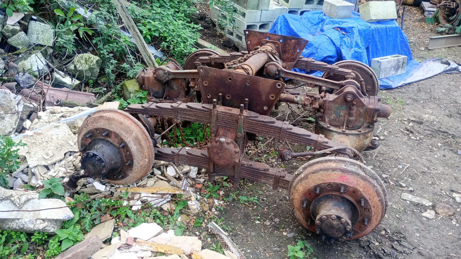

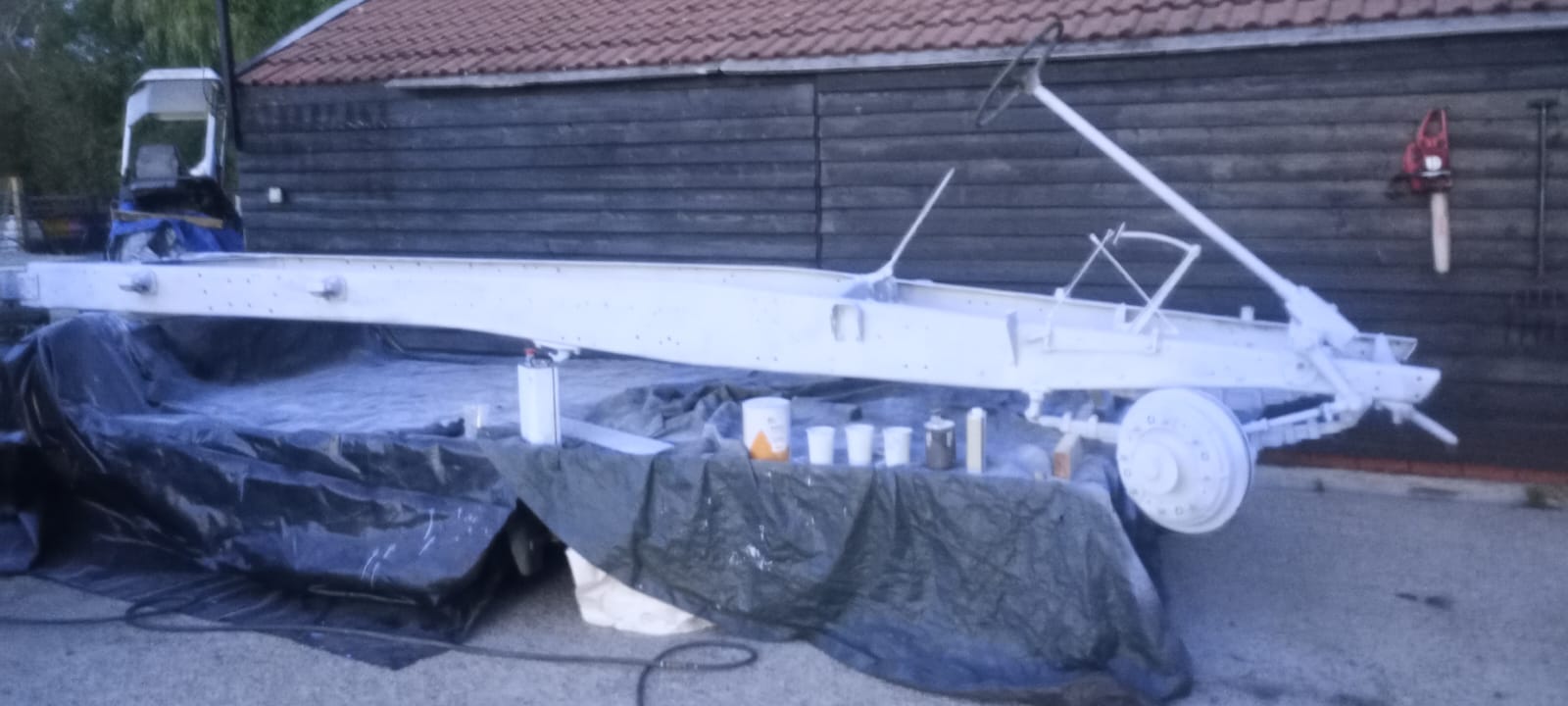

The whole rear bogey pivots around the central shaft, I have a couple of issues to try to solve, first I have removed a ton or two from the rear of the vehicle, the massive winch. the pulleys at the rear and more, I have also removed the weight plate mounts from the front, they were only fitted to the gantry models, so it will be a lot lighter empty, plus it will never get to carry much of a load as it will be running as a historic MOT exempt vehicle, not allowed to carry goods, or bombs, I think the rear springs will not move much, if at all and that gives me two issues, ride quality and height, I am very tight on height into my rear garden and under the car port, I am thinking of removing most of the leaves from the upper springs, maybe leaving only the bottom two, mainly as link arms to keep the axle in position, they could be easily replaced if for some reason it does not work out. What do you think? The vehicle in the last picture is not an Austin but does show the rear suspension design in action!Likely came from 61 Station Workshop REME Strensil when it closed down ???I can remember there being a Gantry truck at the transport museum at Beverley before it closed. It was complete with lathe and other workshop equipment and was set up as a field repair station display, I mainly remember how tall it was.
Bottom picture could have been a painted up Navy jobby as there is no cupola hatch for a top gunner and no jerrycan rackMine was originally a gantry truck, but all the gantry and support structure was missing when I got it, still had the 5 ton winch, I will be building it as a GS lorry as I could not get a gantry truck through the access into my garden / workshop! The first 3 pictures show gantry lorries, the last something like what I am aiming for, except my canvas rear body will be lower, maybe raiseable once in my drive! the very high floor level on the gantry trucks is due to the massive winch mounted on top of the chassis but under the body floor.

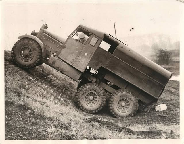

It's a Scammell Pioneer R100 artilery tractor. Looks like a prototype being evaluated by the army.Bottom picture could have been a painted up Navy jobby as there is no cupola hatch for a top gunner and no jerrycan rack
Proper thick paving slabs are good , they're flat and easy to deploy in the load area and still leave a flat surface for 'stuff' ..I would ballast the rear,I dont think fiddling the springs is as easy.
Nice thick plate on the deck,add plates as needed.
I have used Jones springs for my Iveco helper springs and springs for my 1914 Indian,Have a chat with these guys, they may be able to advise.

If I were to take a stab at it (which I'm not!) I'd be considering something along the lines of removing every other leaf from both springs?
Are you able to make a reasonable estimate of the weights before and after you've removed everything?
