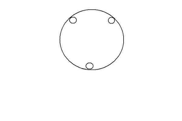

I have a need to cut 2" and 2.5" holes in 8mm mild steel (possible in 8mm stainless too) to make some exhaust flanges.
