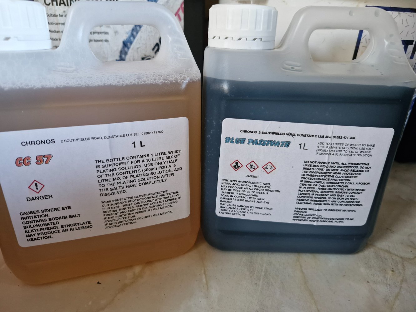

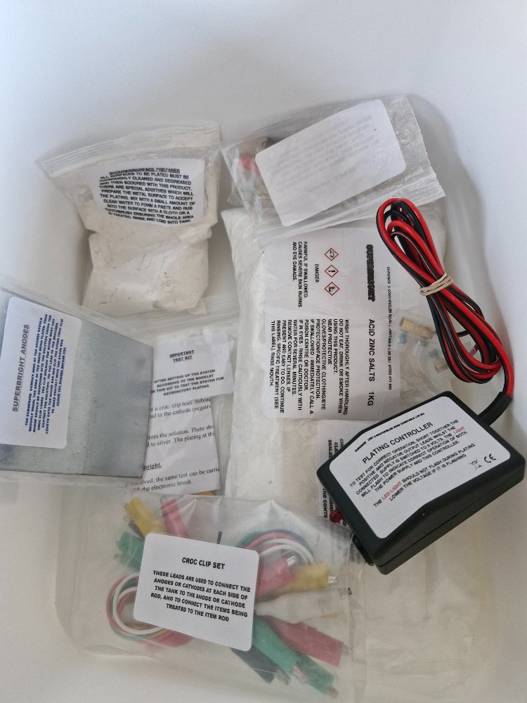

My kit arrived this morning, ill open it later when I get home. https://ebay.us/m/GnEl5n

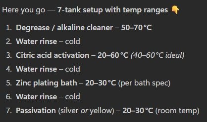

I think I will have the folllowing:
Degreaser tank (heated?)
Prep tank - citric acid (heated)
Rinse tank (unheated)
Plating tank (heated + air pump for agitation)
Passivate tanks (heated)

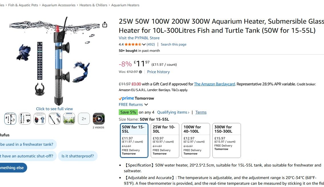

I think the above covers it and is my interpitation on heated tanks OK? Would a 50w heater be OK in each one or go larger for quicker warmup?
