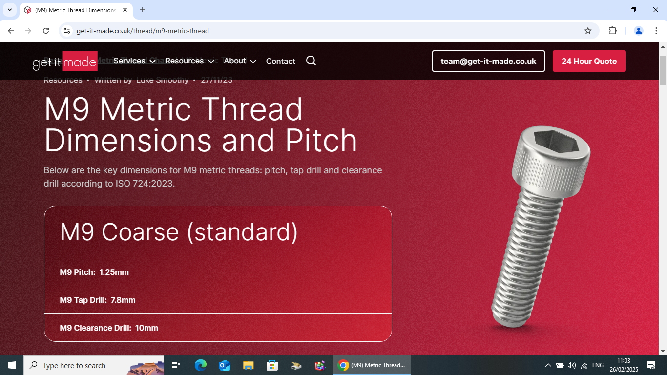

Are they common to any other Citroen's?Hello, typical Citroen DS, I need a couple of M9 x 1.25 studs about 50mm long.
Unobtanium
My Zeus table doesn't include M9 threads.
Would I be able to use a die on 10mm diameter rod? Or should I thin it down a bit in the lathe?
Thanks
Assuming they follow the ISO standard:My plan was to reduce 10mm bar in diameter in the lathe.
Should I reduce to exactly 9mm or go a bit further to make life easier for the tap?
Would 8.8mm be too far?
Last 1/8th of thread depth on a male thread is truncated
D maj = D so 9mm is the top of the flat on the thread, not the projected top of a sharp v-thread.
Knowing my machining abilities, it will be undersize anyway.

Thanks for typing all that out Pete, l was just about to including Tracey Tools!Turn the stock to 8.8/8.9 and run a split die down it. If you're struggling let me know I believe I may have that size die, otherwise tracyools.com
