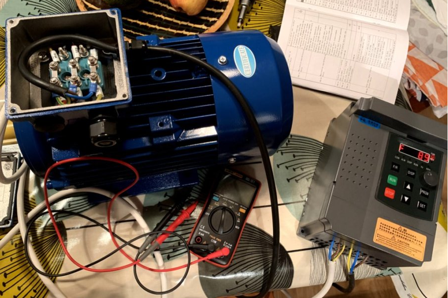

Playing with the shiny stuff on the kitchen table, and it's all going reasonable well:

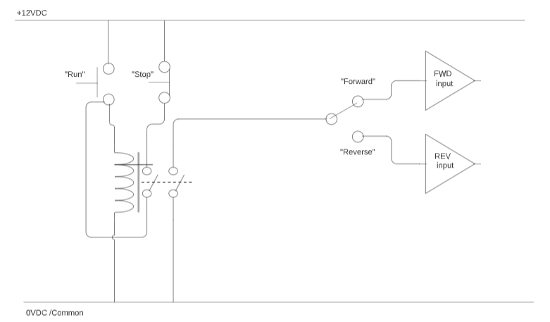

But I can't figure out whether the YL600/YL620 (this is a 600) can use momentary switches for stop and start.
I've been fiddling with P00.16, P00.17 and P00.18 but can't get it to do anything other than run when the buttons are latched.
Here's a link to one of many manuals (all slightly contradictory!): YL620-A-Inverter-Manual.pdf (bulkman3d.com)
