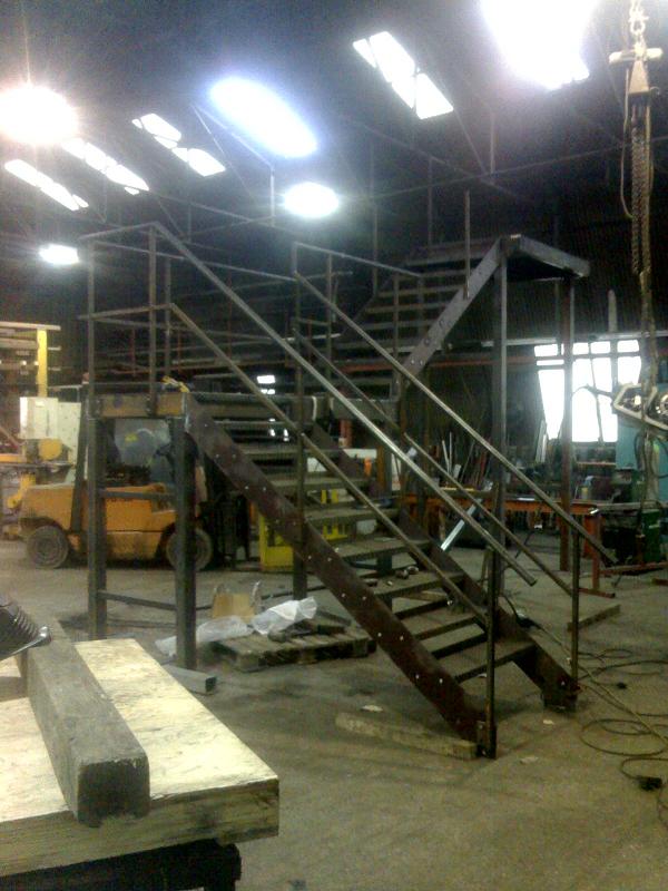

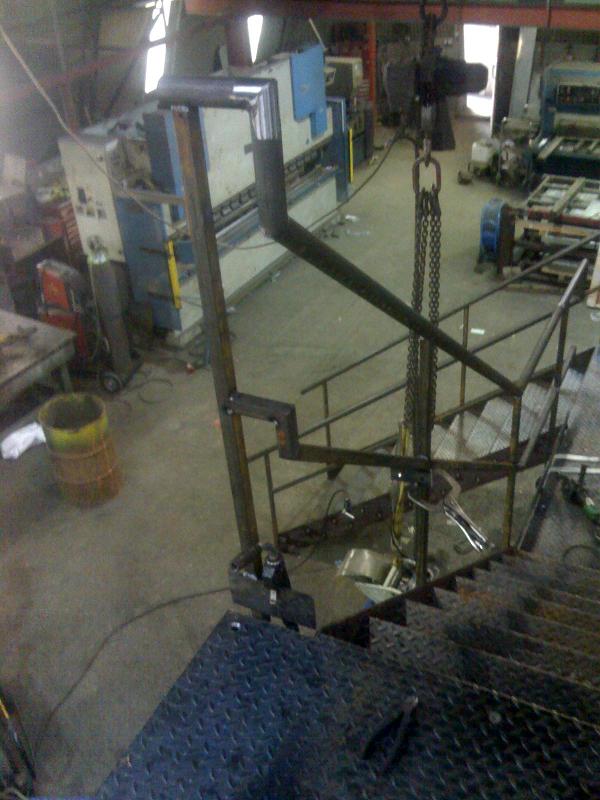

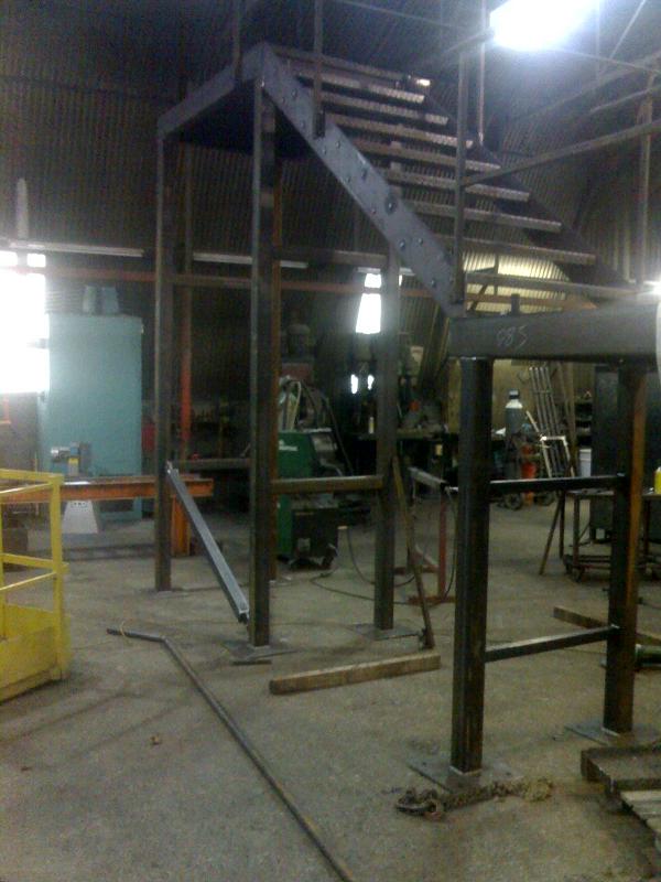

It would have stuck out too far Steve, it would have needed a landing in the middle, then the final tread would have been probably about 500mm past where the corner one finishes, plus then you would need another 1200mm clear pedestrian walkway. Making it a bit tight for artic unit to get round the corner and onto the weighbridge.
