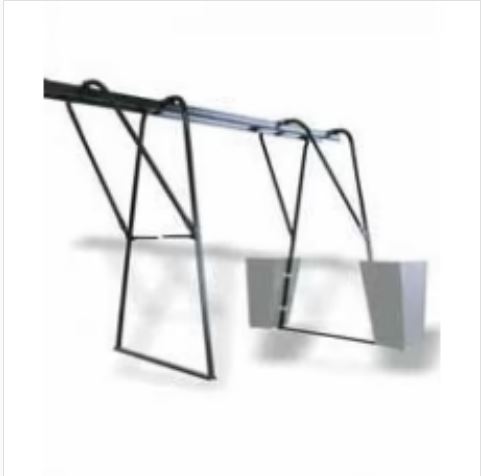

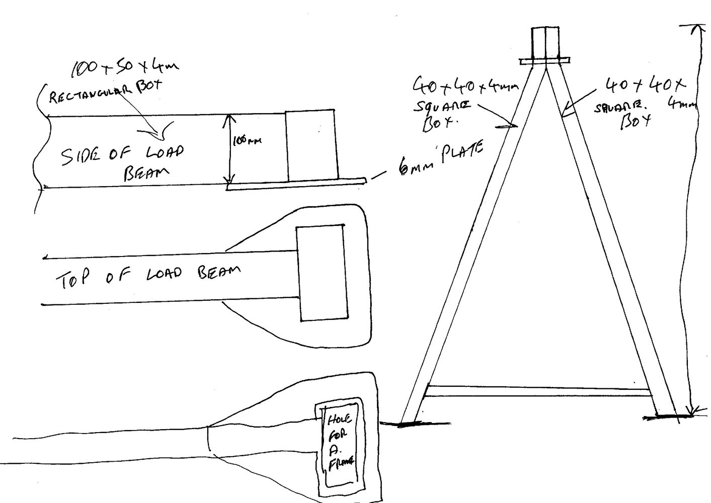

Hi everyone, I've should have build one years ago but never actually had the time materials etc.
Yesterday my friend and me killed our backs while unloading the comet cold saw from the van and we had to put it on its stand too.
Here born the need for it.
I've decided to make a parallel thread to other one started by another member because I have specific needs and I essentially need some advice as I don't really know what can work for me or not.
Starting from the design I've thought about an A frame with gussets to the top beam.
Load capacity at least 500 kg but if it's not possible I would accept a lower lift capacity.
As light and portable as possible, and this mean I can't really use heavy materials, and components can't be longer than 2.5metres long so I can get it into the Vito once disassembled.
It has to be a little bit off road capable as I need it in my property and there's not concrete floor, it's kinda rough terrain but not impractical, I just can't use small or narrow wheels.
I prefer a fixed design as I don't really need to be adjustable.
I have 3mm thick rettangular tube and 48mm diameter 3.5mm thick pipes (the ones used in construction for the scaffolding)
I'm not sure how too build it really never got deep into various designs.
