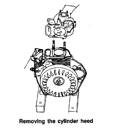

Looks like I've got the Geordie version of the manual. That's okay, probably the best version :-)
