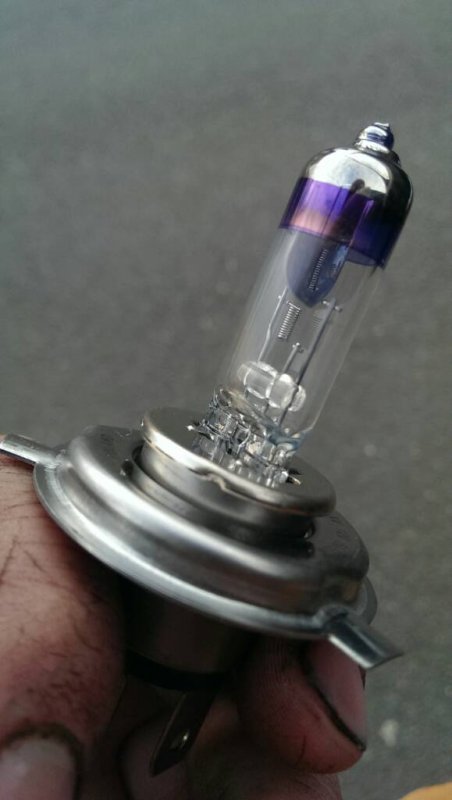

do does that mean my lights are projector because they have a metal cap on the end of the bulb?

With the exception of 'reflector optics' aka free-form headlights the lens and reflectors both play a role with regards to beam pattern. As said projectors use a shield (can be moveable for dipped & main beam from a single source) to set the beam cut off while with reflector designs the lens plays a bigger roleam i right in thinking projector lights beam is governed by the glass at front and a reflector is governed but the reflectors behind?
True the way beam cut off is done improves things but the light sources and focal lengths are still completely different resulting in glare and brighter isn't better if the beam pattern is screwed up as a result i.e. the area of the road they actually light. All covered in detail in the link i posted with my origional rant... http://www.danielsternlighting.com/tech/bulbs/Hid/conversions/conversions.htmlNo one has mentioned projector vs reflector lights. Beam pattern in a projector (even one intended for halogen) is still quite good with HID retro fitted. It's hopeless in a reflector, granted.
