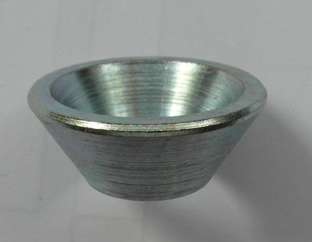

Yes. Front wheel, which had been doing 70 the evening before.
The wheel had been off a few times shortly before this and nothing was visible to give warning that this may happen. The nuts have never been run slack and they've not pulled through the rim but the taper part detached and was still securely clamped in place.
