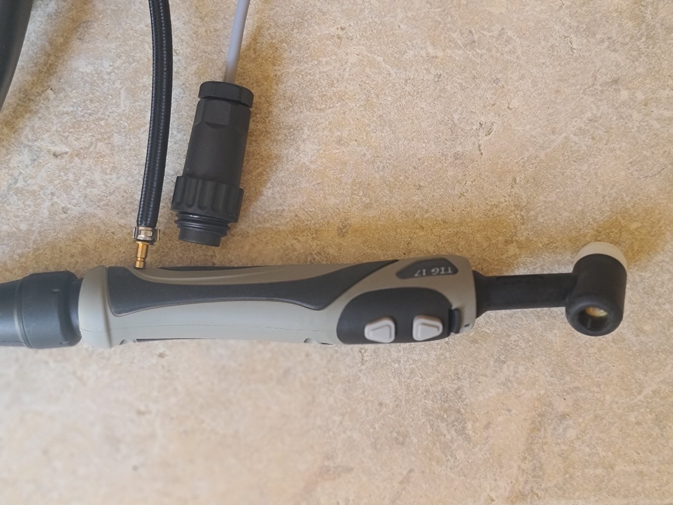

The Tig 17 double button torch supplied with this is a little clunky (2nd image below)
and I'm after a wp9 for most of my welding (thin stuff and prob no more than 60A most of the time).
I'm looking at bargain basement torches to get me going and might upgrade later.

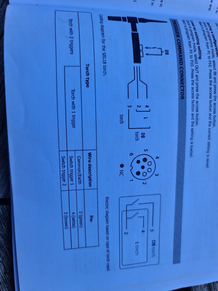

The DB torch does have a function on the secondary button when in 4T log, but I'm willing to do without that for the moment and work in 2T/4T for simplicity (so only 2 control connections to make rather than 3).
So....Amazon have cheap torch......

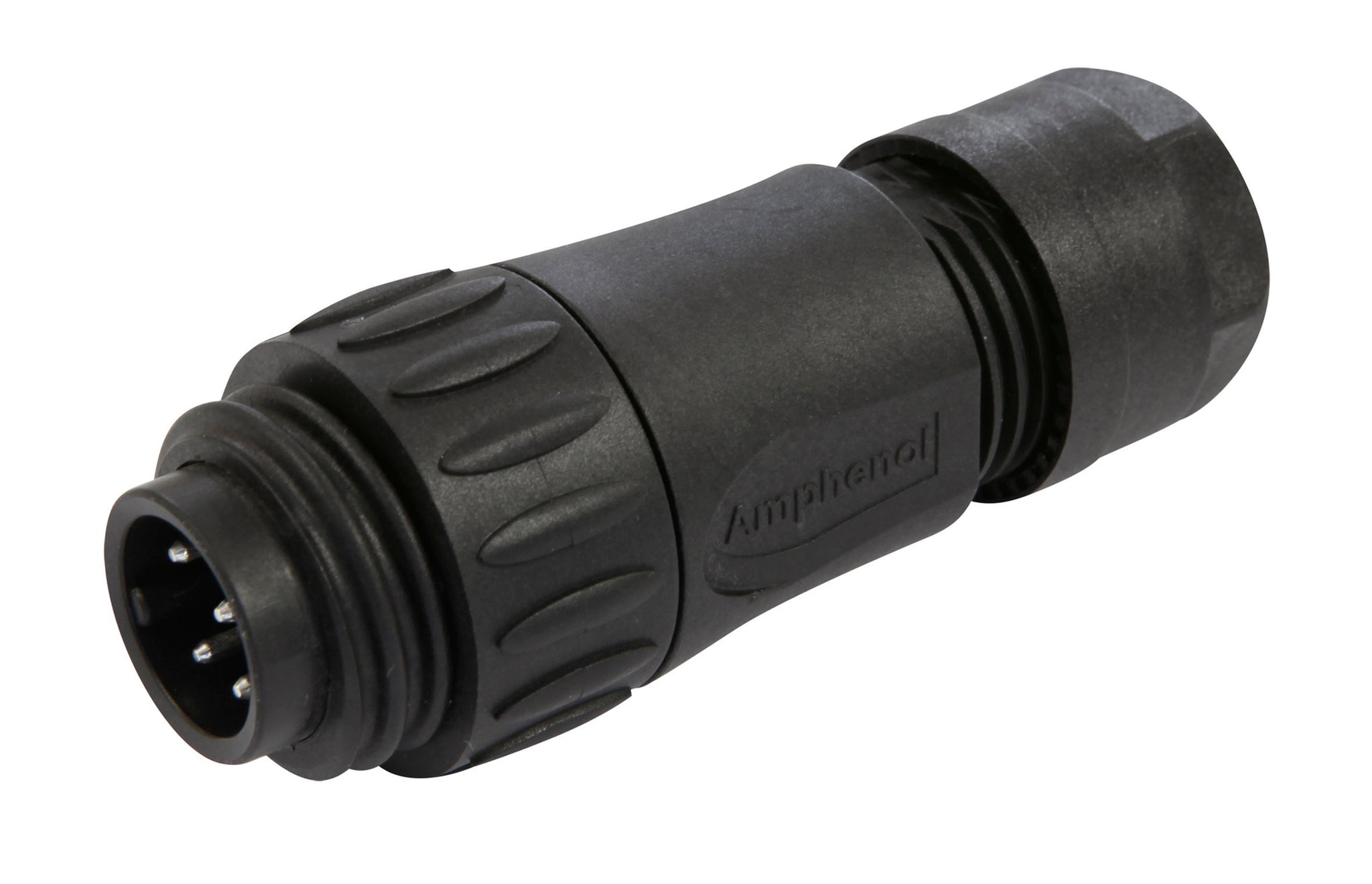

And I just have to find a 7 pin weipu control connector to link control cable to machine.....and some kind of control switch to strap to the torch.....(And of course a stubby gas lens kit)
..that's where I'm stuck......the switch is one area I don't know about...what kind of switch is best, and I could do with some user experience...what works and is usable..and what isnt so good...I'm thinking a flush button atm but I have no idea really ....any comments welcome. Thanks
