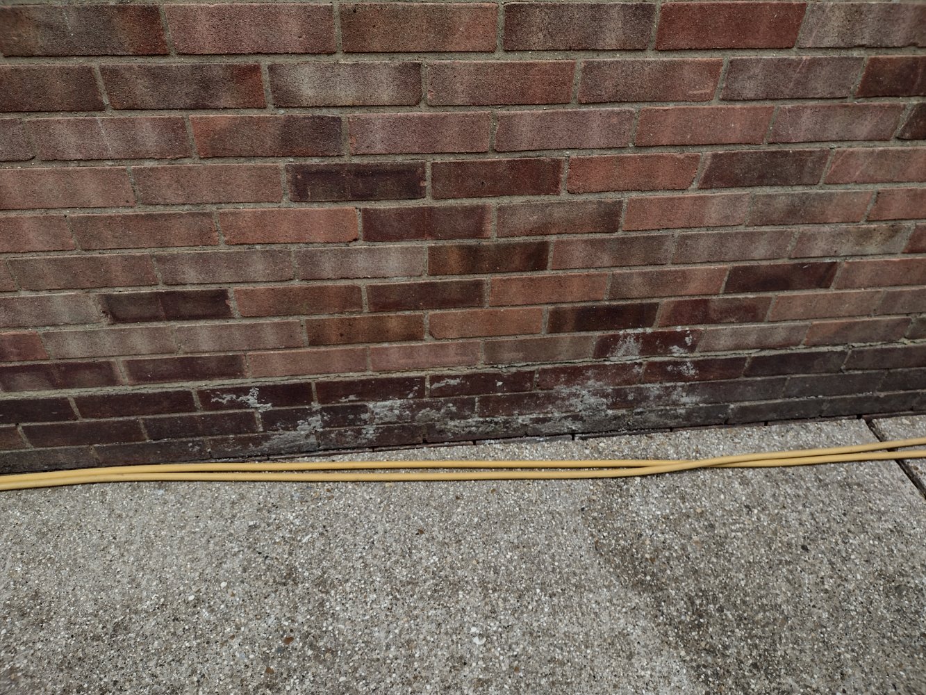

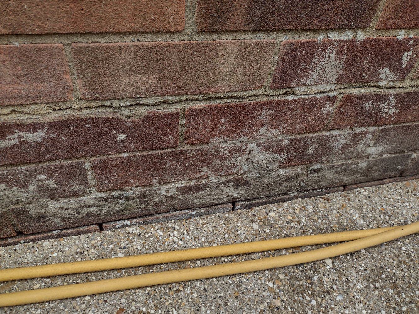

my domestic one doesnt touch it , and im not bothered about it enough to get a pro onto itPressure washing may well be able to shift some of it. Try using a pressure washer capable of 140Bar or higher.
Poly discs can be good, the ones for stripping paint, although they don't last very longI had very similar at the front of my garage.
Brick acid moved some of it, brick acid and an angle grinder with a wire wheel moved most of it.
For the latter, just me sure you are well protected from any spray that occurs.
My house is built with “rustic bricks” which are contoured and made removing all of it tricky as there was a limit to how much pressure I was prepared to put on the wire wheel.
Please dont do that, not at the same time atleast.brick acid and an angle grinder with a wire wheel moved most of it.
I've got 32%, which was sold for cleaning drains. No longer available without a licence
