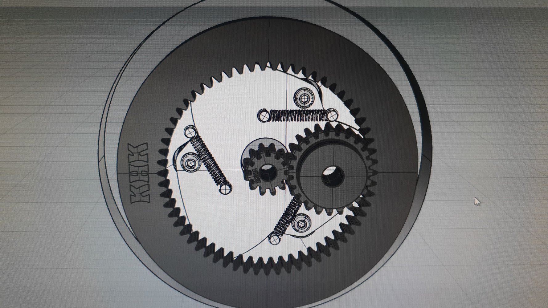

I know the smaller the mod the smaller the teeth usually are and mod 3 from what I can see looks about right...
Go here: https://trublueclimbing.com/trublue-auto-belay and read the specs. for overall size (380 mm x 320 mm x 140 mm). Download the manual: https://cdn2.hubspot.net/hubfs/5957...ue/EN_trublue-trublue-xl-operation-manual.pdf and import page 12 into your CAD program and scale it to that size. Go here: https://atomikblob.blob.core.windows.net/atomik-live/images/thumbs/0016314_trublue-2-auto-belay.jpeg and do a bit more scaling.
Gears are measured by pitch circle diameter. a 1 tooth gear of 1 MOD has a pitch circle diameter of 1mm. a 60t gear of 1 MOD has a pitch circle of 60mm dia. A 60t 3 MOD gear has a pitch circle of 180mm dia. GearDXF (http://www.forestmoon.com/software/geardxf/) will make you picture of one.
