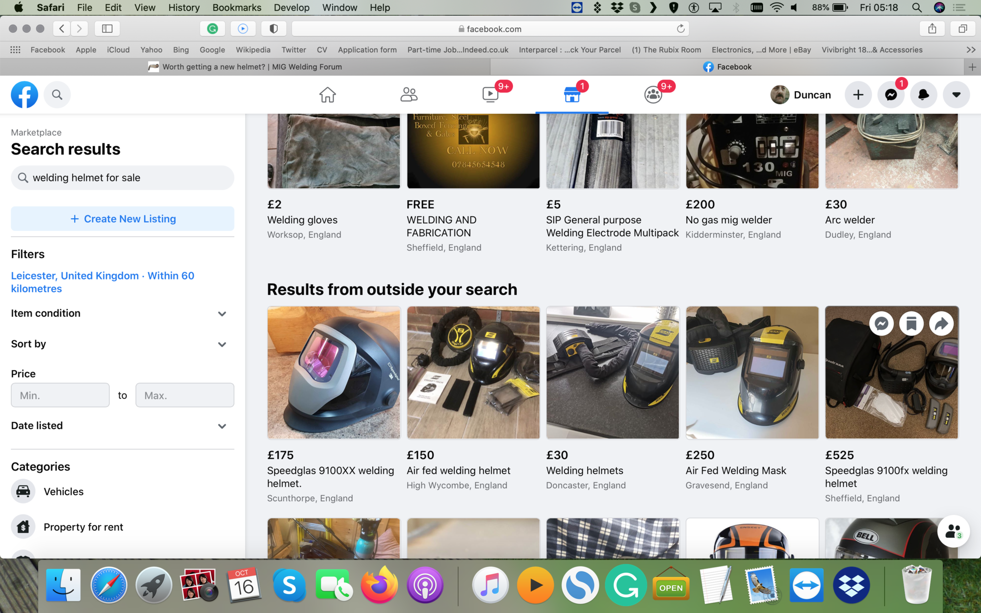

    yeah mate if you look on Facebook you might drop on a bargain thats where I got my A50 sentinel from I got it for £110 and it like brand new with everything lenses etc I've seen plenty of bargains on there
