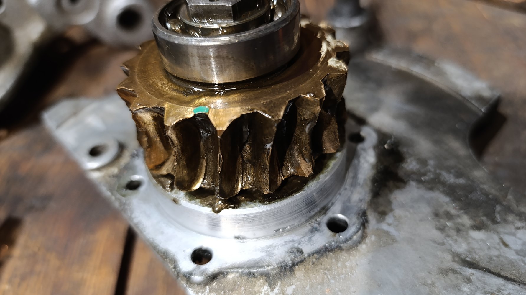

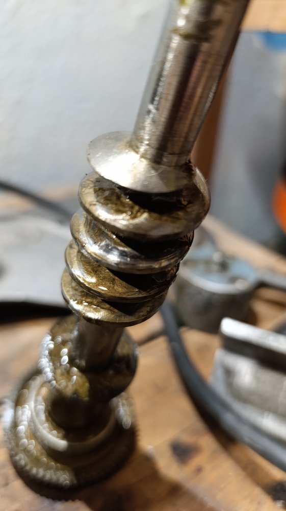

I'm in the process of restoring a BAIER EHS1 hand held cold saw.
It has a worm gear transmission which has been neglected apparently (maybe not enough preload on the bearings)
I've took measurements, made calculations etc but apparently you can't machine this part.
As from the measurements you'll never be able to reproduce it exactly.
Now from the measurements it's impossible to recreate the brass gear on an horizontal milling machine as I was thinking about using my lathe for the purpose (easier than you think)
And that's why

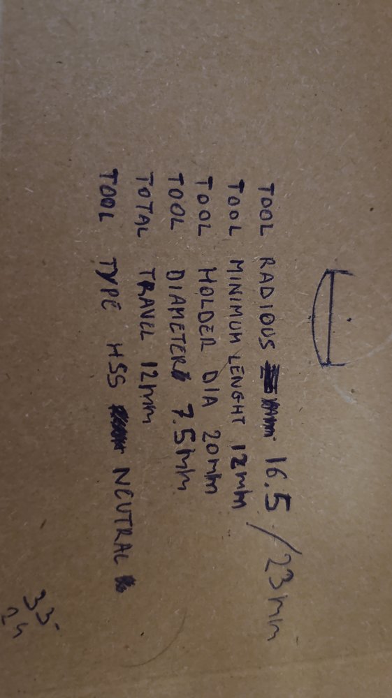

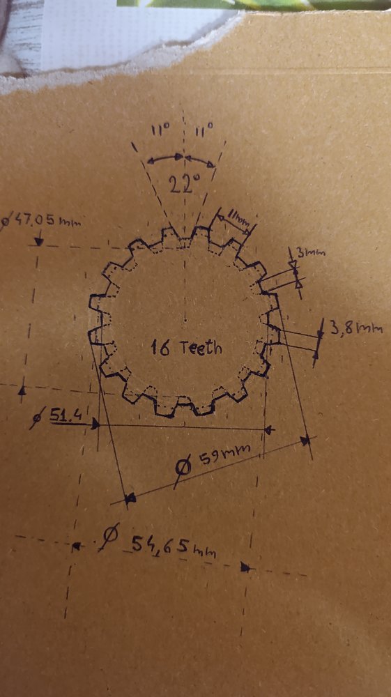

16 teeth 22.5° included angle 11mm pitch
59mm nominal outside diameter
47.05 on the smallest diameter
51.40 on the smaller outside diameter
54.65 in the middle of the edge of the tooth where the screw gear core is rubbing against.
Now to achieve the correct roundness you should use a 16.5mm tool radius
But you won't be able to do that as you have not enough rigidity or space on a driveshaft to drag the tool .
Which has to be 7.2mm square to machine the complete tooth once at 12mm dept of cut .
To do that you'd need a 23mm swing radius.
But the smaller outside diameter would be 2 or 3mm undersized.
It's impossible from what I've been able to see to reproduce the exact shape following a perfectly circular tool path.
Now it would work even with the 23mm circular radius but how they made it originally.
I think it might have been cast or they used some type of off center machining technic
The only option is a 46mm slitting saw spinning on a 9mm shaft which would instantly snap
