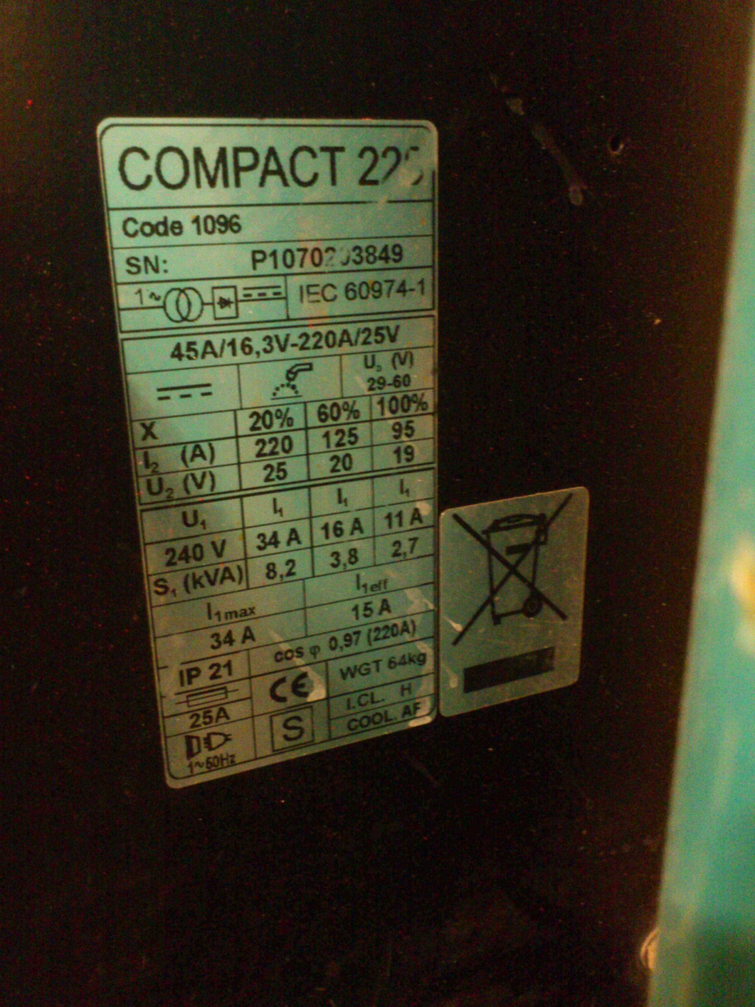

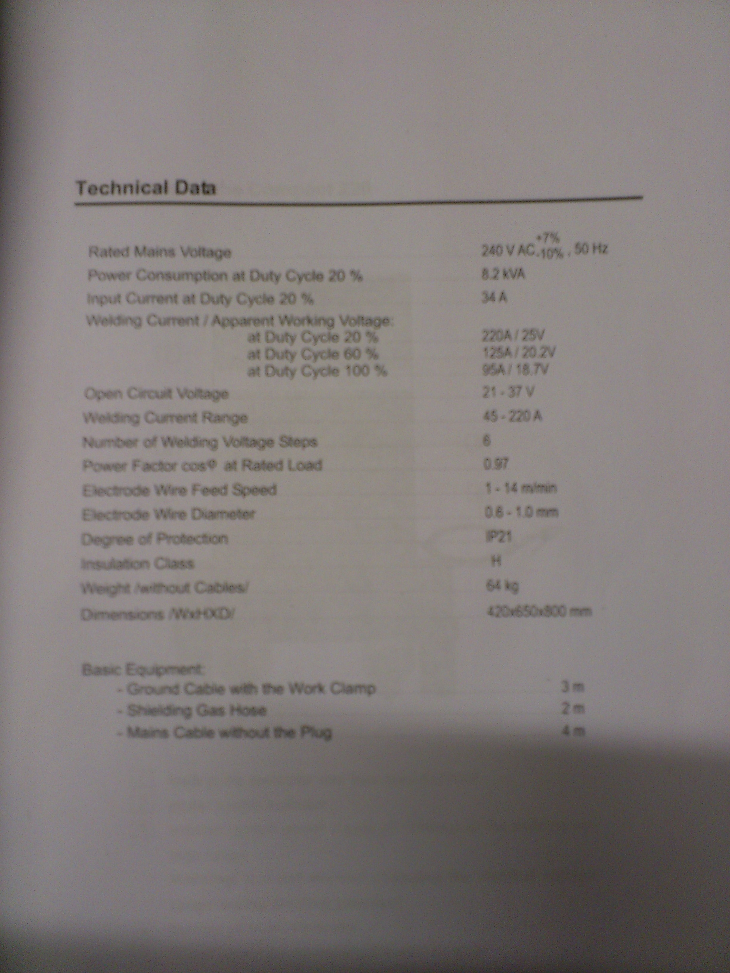

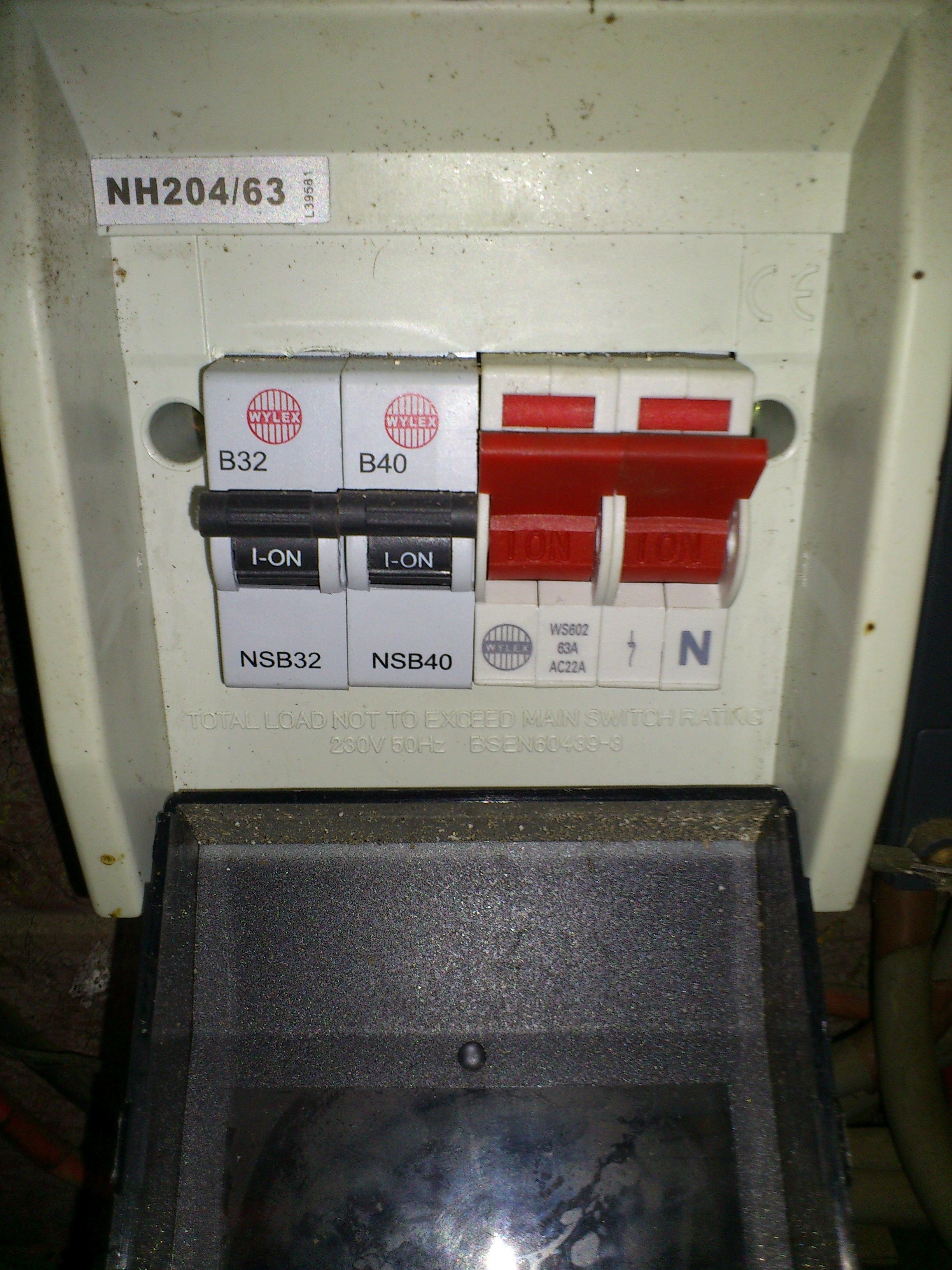

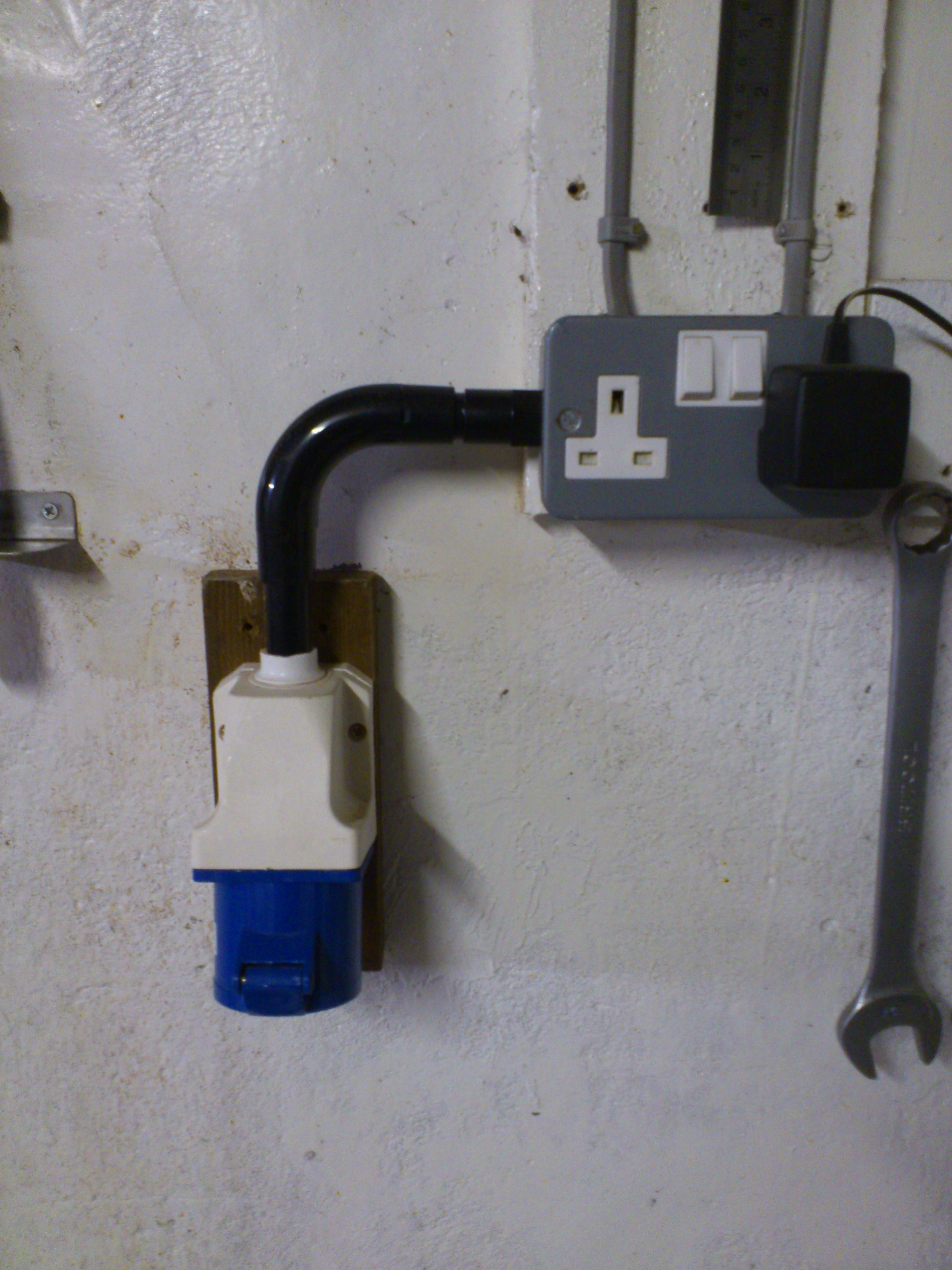

the type isnt a distribution board its the individual minature circuit breaker type , all 3 types will fit in . without going to the far end of a fart change the 30 amp breaker in the db to a c type and where u have takenIn summary using the 40A breaker in my existing box is a no-go, it has to be a Type C Unit? I take it this means I'm going to have to install a new box
Argh!
Jordan
the 30 amp socket off incorporate it in to the ring rather than spur it off with a single cable and that should work fine and safely even though it isnt the correct way and as for getting all work signed off u can do whatever u like in your own home and theres nothing anyone can say or do about it .and as long as the work comply s its fine. u can get a periodic test done on your wiring and a test cert supplied at a later date if u need to
