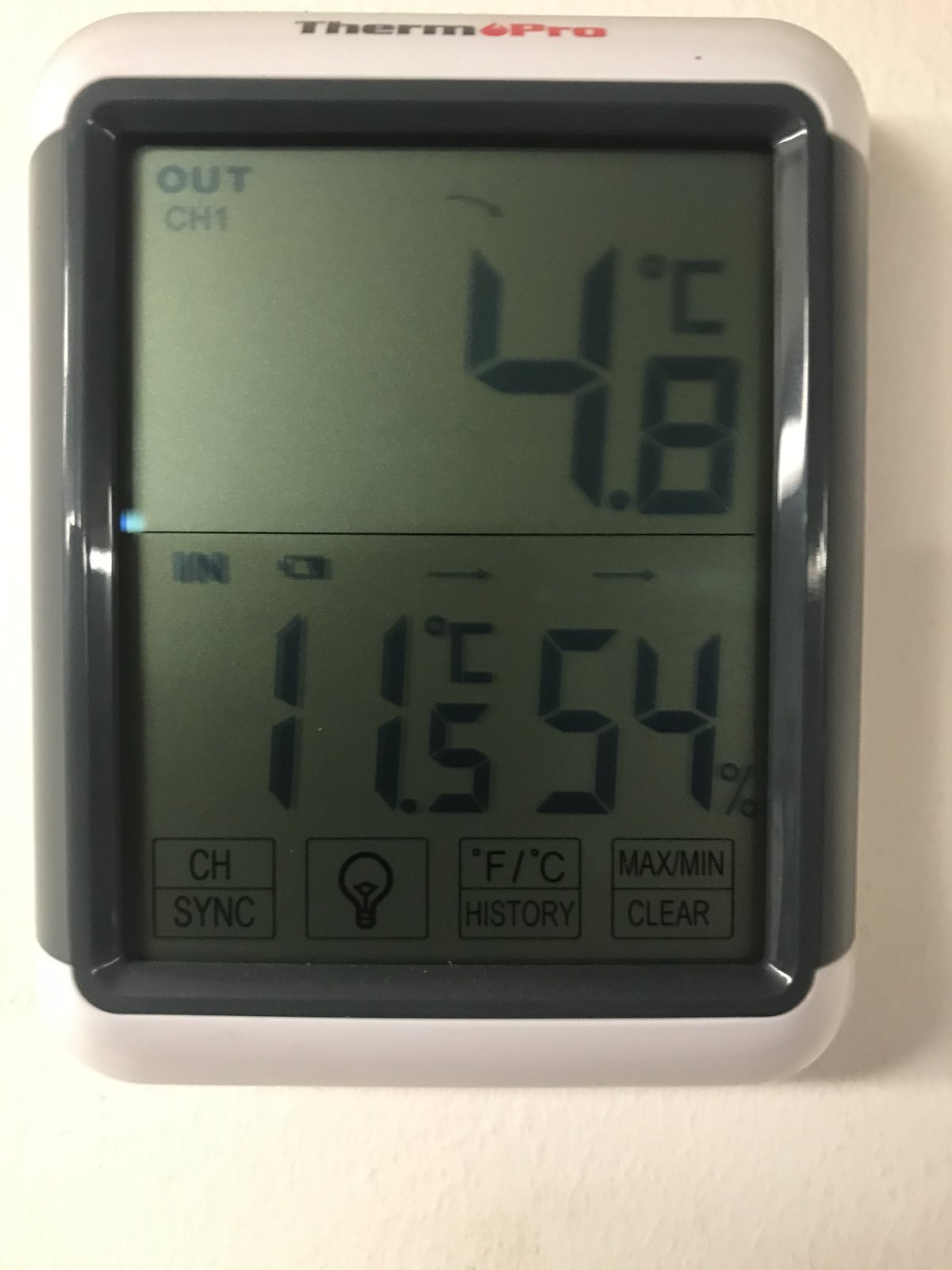

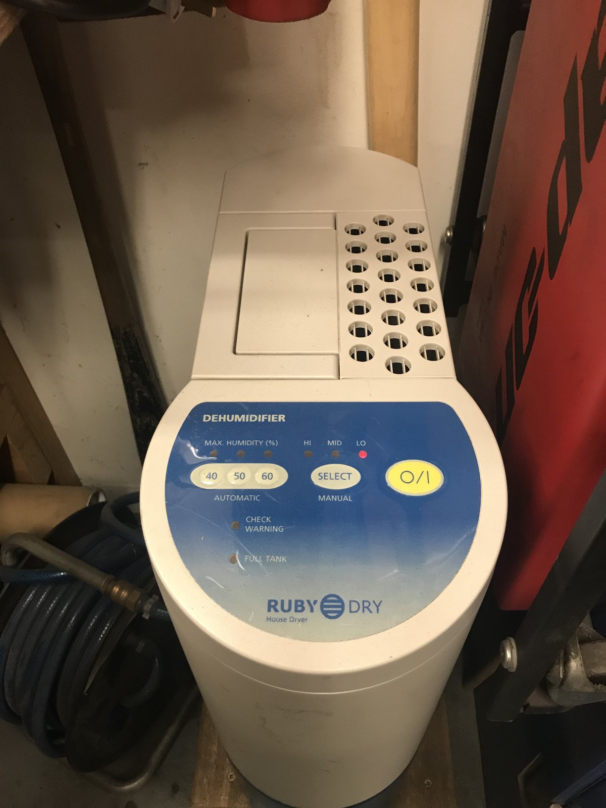

Problem is that if you don't warm the air then your dehumidifier will bottom out at approximately 65 - 70%RH at 7°C since that equates to a dew point just above freezing.
Warm the air and you'll be able to recover more moisture.
