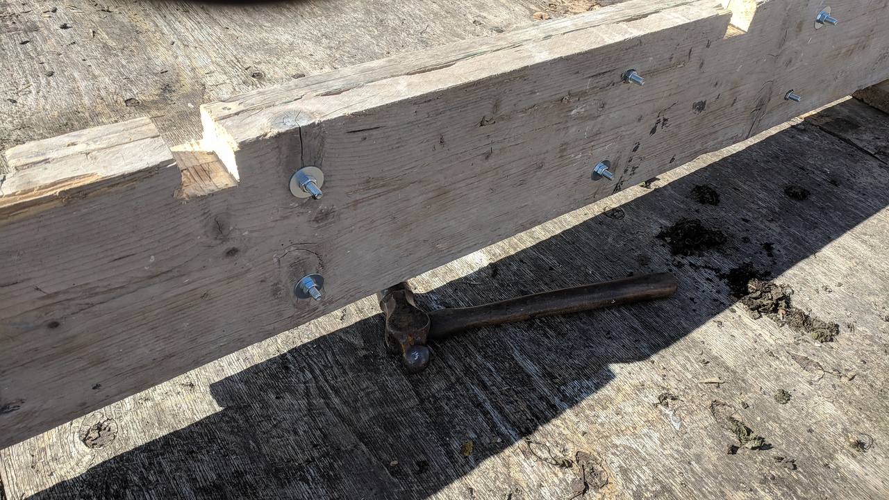

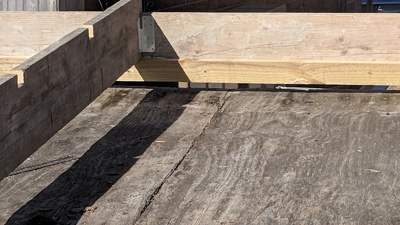

bigegg Scream Not Working Because Space Make Deaf Messages 9,663 Location Leeds, West Yorkshire Oct 1, 2018 #21 I went with straight beams at 6.3m, and used bolts, connector washers, and gorilla glue. to get the extra slope, I supported one end on a piece of 3x2, again bolted and glued. the other picture shows the amount of bow In the roof.

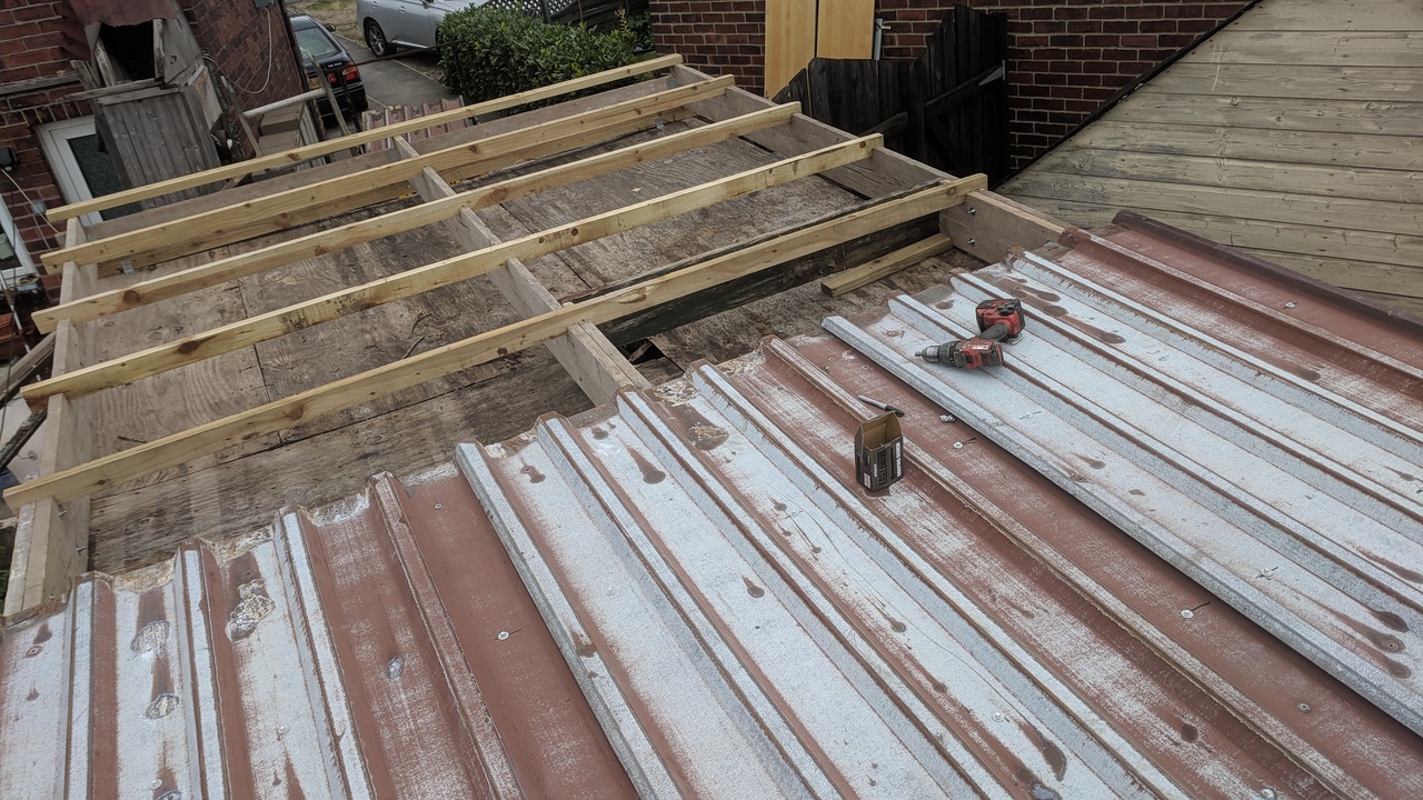

Afterimage Member Messages 235 Location England Oct 2, 2018 #23 This is a welding forum - why not make roof joists from used pallet racking,doubled up one above the other for extra strength. Cheaper than timber too.
