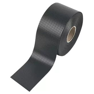

need to do some repair work on our wooden shed , the wooden bearers/crossmembers sit on concrete , would i be best to put some dpm barrier between the two surfaces
wouldn't the timbers still wick up water off the DPM?Yes. Anything to stop the timber wicking up water.
...............ive got mine sat on spaced out pieces of slate the width of the timber base.
yeah did cross my mind.....then i cant use creosote /engine oil on the timberMight be worth running a bead of Sikaflex EBT+ along the outside base of the wall of the shed and the DPM, to stop water getting in between DPM and shed base.

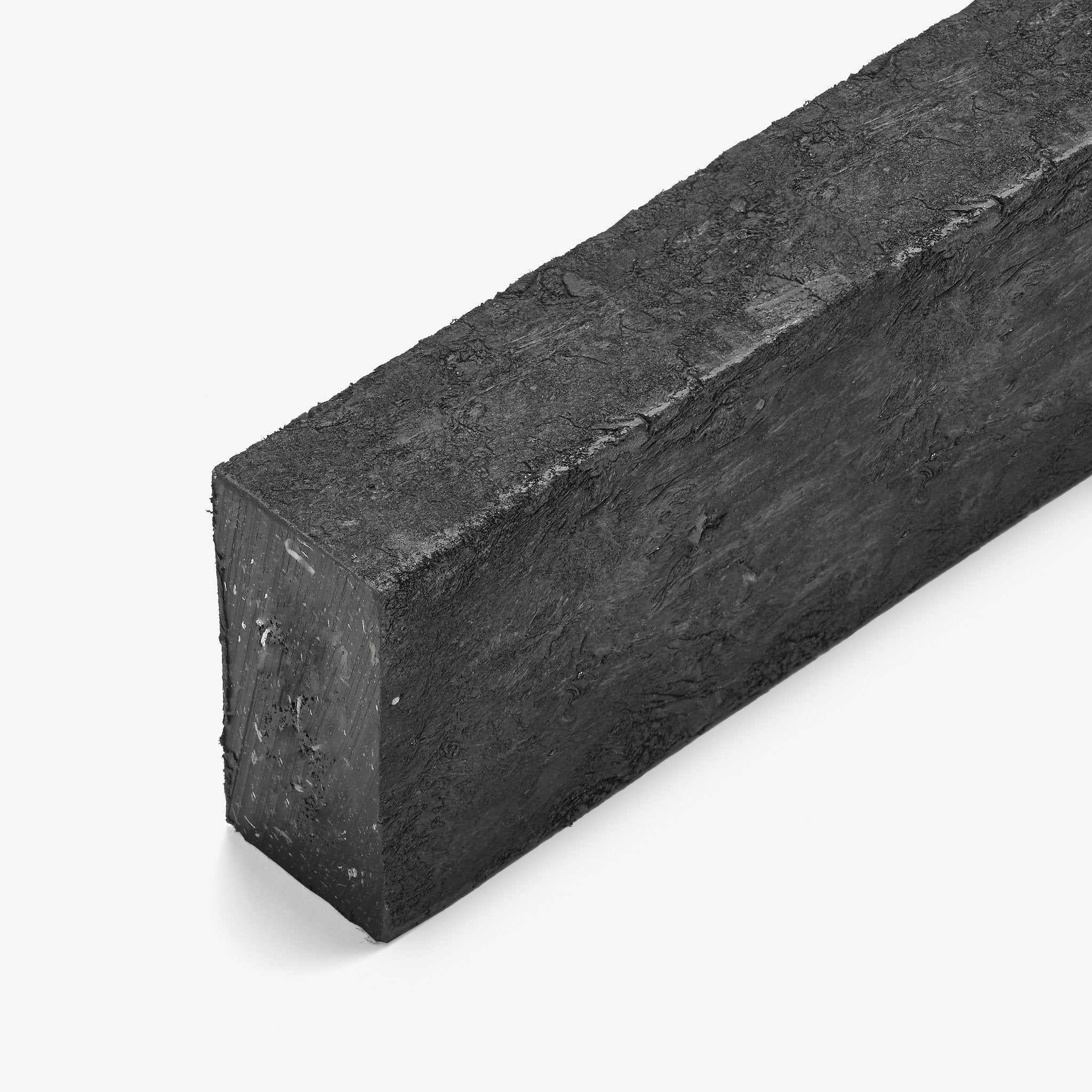

there also composite instead of wood
Plastic Lumber Joist 50x100mm | EnviroBuild
Heavy Duty support for your deck using Manticore Lumber recycled plastic joists - 50x100mm available in 3.4m lengthswww.envirobuild.com

yes they need chopping out with a metal blade in a chopsaw as they can have metal shards in themare those solid plastic? I thought about using plastic decking to lift a walk in freezer off the floor - but a mate told me it's not solid plastic it's more plie plastic+mdf?
Yes basically thick gasket material. Just lifts thewood from the concrete and helps seal the tamped surface. Where as using recycled bale wrap, ie stock board, or the posts, is quite hard so can allow water underneath espescially on a rougher concrete finish^ whats that please 1/2 inch? neoprene ? is that the stuff light gaskets are made from etc?
