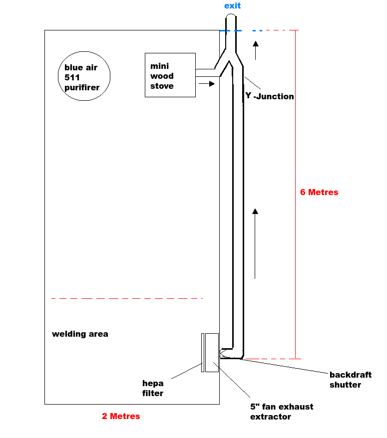

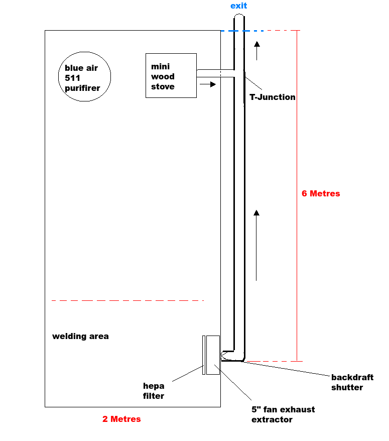

Sounds sensible to run the extractor out of an open door, they can shift a lot of air and in an otherwise reasonably well sealed shed, could end up drawing back through the burner chimney without good inlet area.im guna go with a clarke with those plastic 12" ducting and stick it out of garage door for the fumes.
for the wood burner will use some proper chimney pipe and drill a 125mm through wall.
so will warm garage up turn burner off. and then when welding use the clarke ventilation fan.
