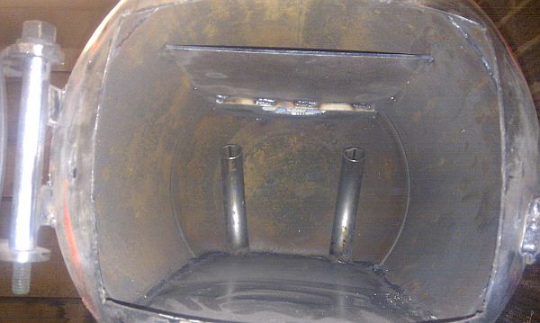

Here are some more pictures from last night. All I managed to do was line up and weld the door frame to the bottle.

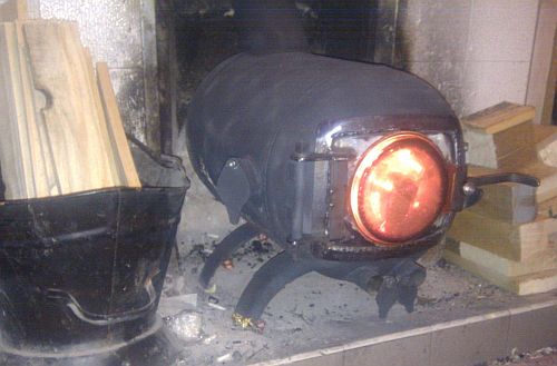

Here it is lined up and tacked into place.
Once that was done I welded the sides into place. There was a fair bit of a gap, so bridged the joint first.
Scuffed that down and then welded again over the top to again help ensure water tightness
And the other side
Then the bottom
Then the top
I am going to start work on the baffle and secondary air intake this evening.

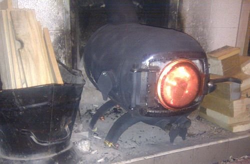

And the other side
Then the bottom
Then the top

I have had to move wood away from ours, I put it there to dry but it started smouldering. This was nearly a foot away.
