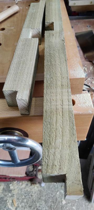

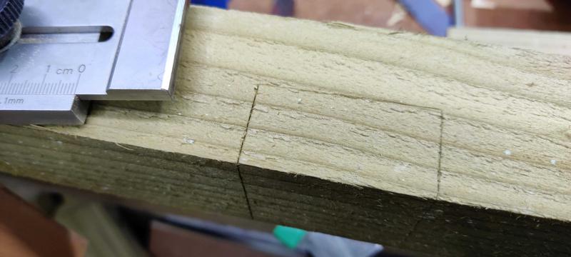

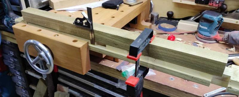

The (almost) final job was to sort out the cross-pieces themselves.  I started by marking up the cross-pieces using the side pieces for reference:

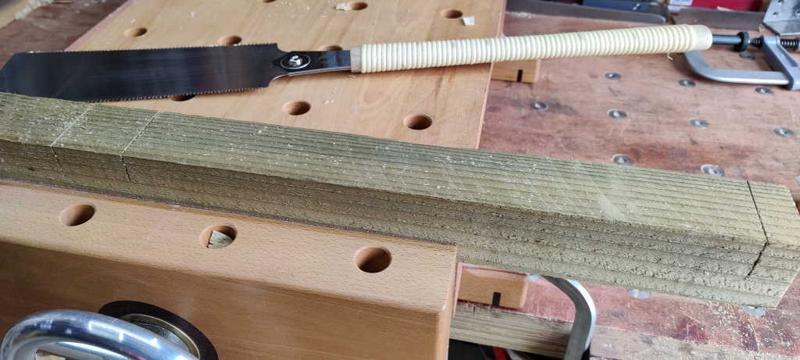

I then cut the edges of all the joints with a hand saw:

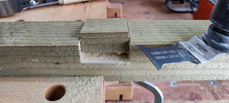

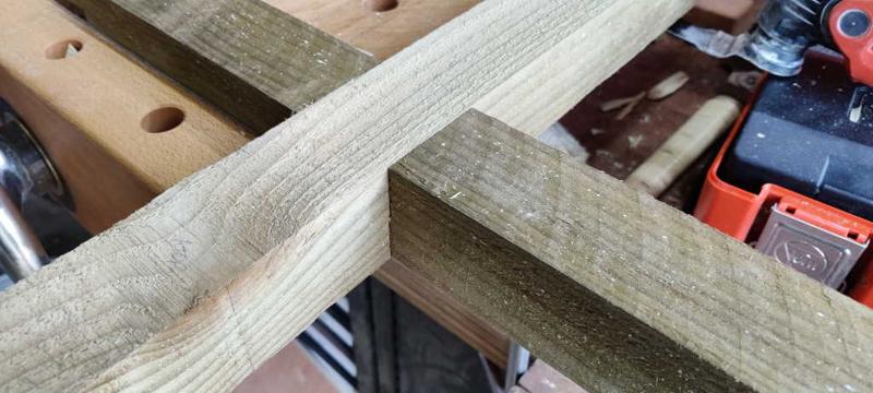

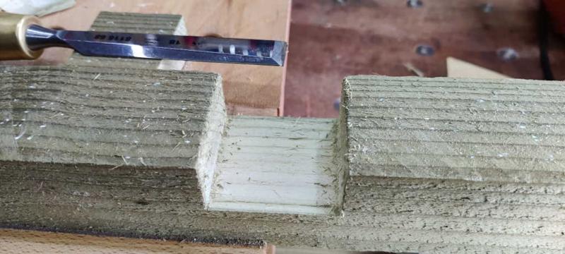

For the ones in the middle of the cross-pieces (where they cross), I wobbled out the bulk of the waste:

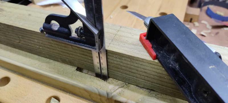

Then finished with a chisel:

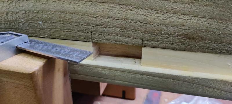

A quick test of the fit:

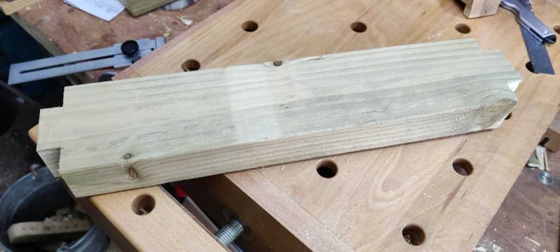

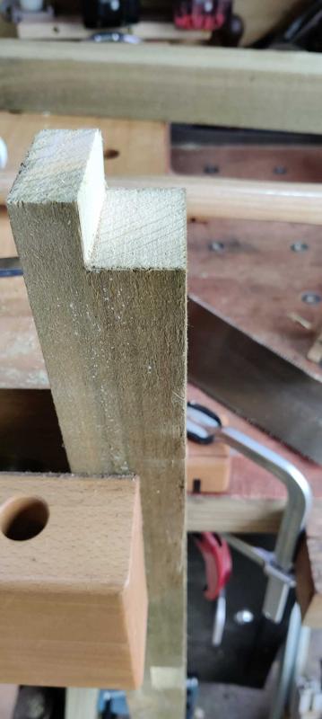

For the end rebates, I just cut them out with the hand saw:
Here are two of the (six) finished cross-pieces:

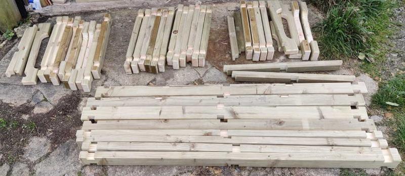

With that I thought I was finished (apart from treating the wood and assembling everything), so I laid all the parts out for a photo:

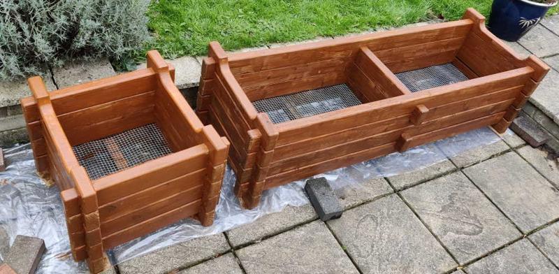

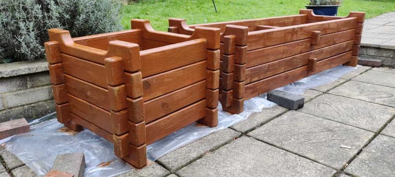

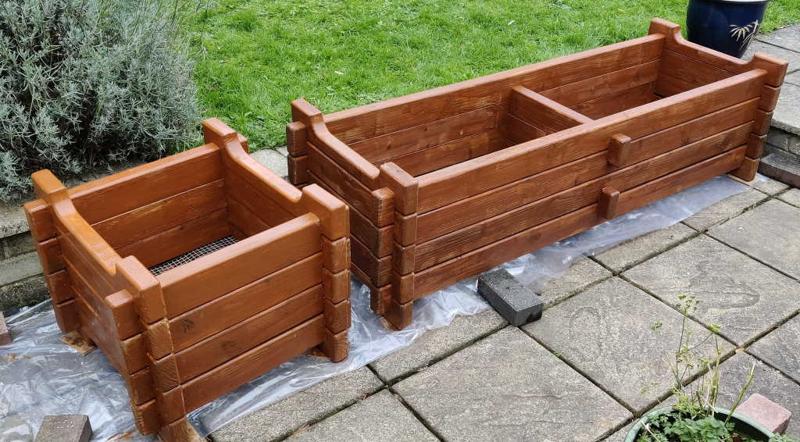

I then decided it would be a good idea to try putting the planters together for a trial fit. Here's the big planter after the first couple of layers were added:
... and here they are fully assembled:
For now I've just covered them with a tarpaulin and whenever the weather next looks like it might be dry for a few days in a row I'll take them apart again and start the dull job of treating the wood.
