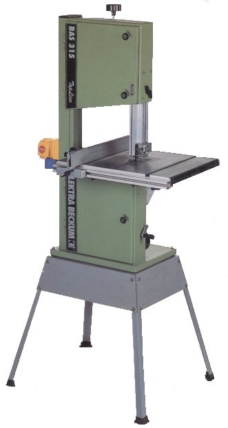

I have an elektra beckum wood bandsaw that owes me £40, I had aspirations about converting it to metal cutting.

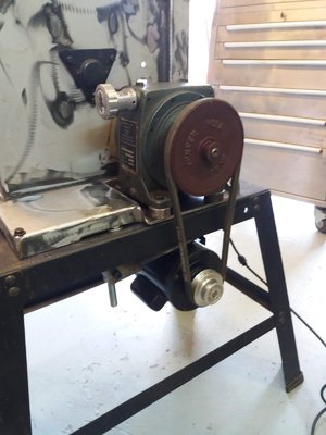

It had a 3/4 hp motor on it which I have swapped with a 1.5hp Treadmill motor with a PWM controller.
In my haste I didn't do any maths and unfortunately even at it slowest it's still a little too fast at about 430 FPM.
If I squeeze an intermediate pulley in there I can probably get it down to about 180 FPM which is fine for the vast majority of steel/aluminium etc but still a little too fast for anything more exotic like stainless.
If I make some elaborate system with an external second intermediate pulley that would get me to about 45 FPM...bingo...but I don't want to do that.
Making some sort of sleeve to increase the diameter of the pulley on the band wheel is a possibility but I think I only have enough room to get to about 100 FPM....which could work...if I do have the room.
Other options from the hive mind? Worst case scenario is I have a variable speed wood bandsaw.
