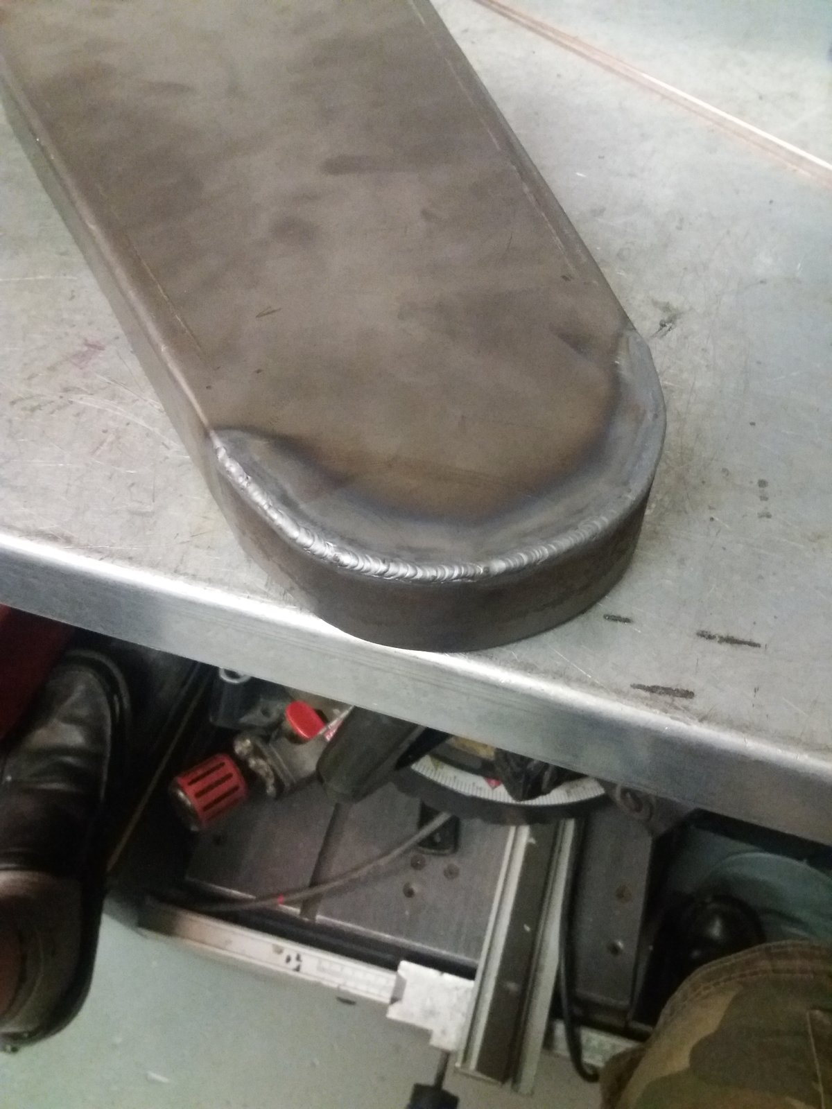

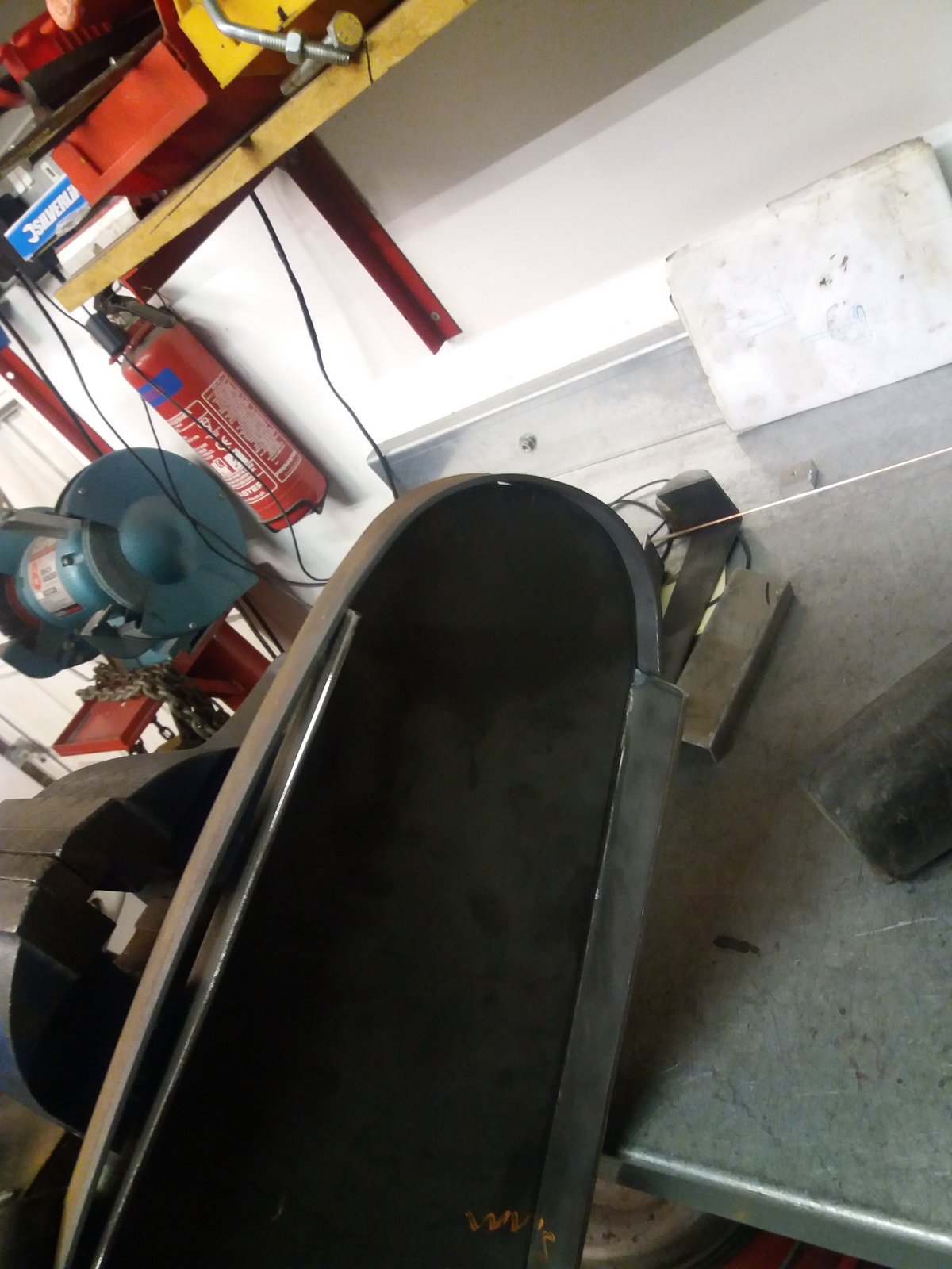

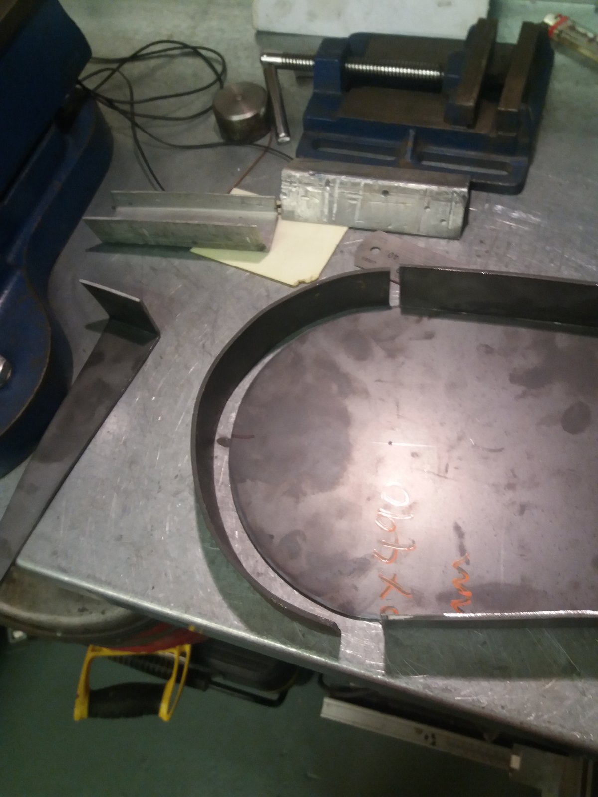

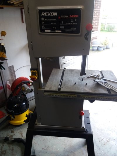

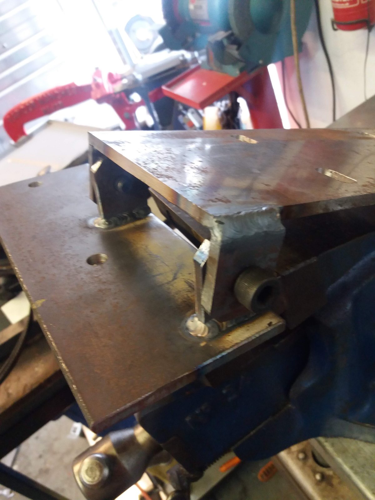

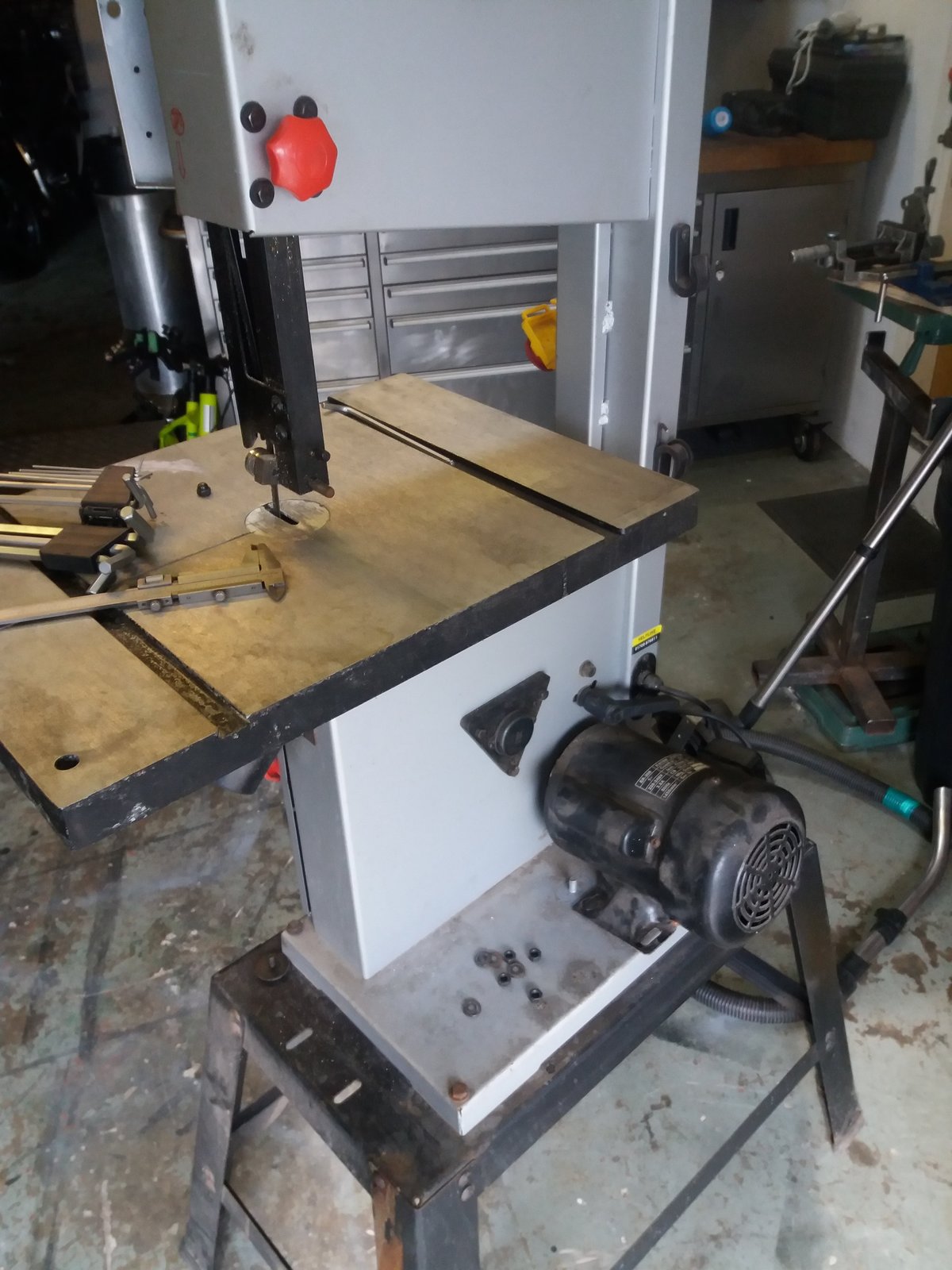

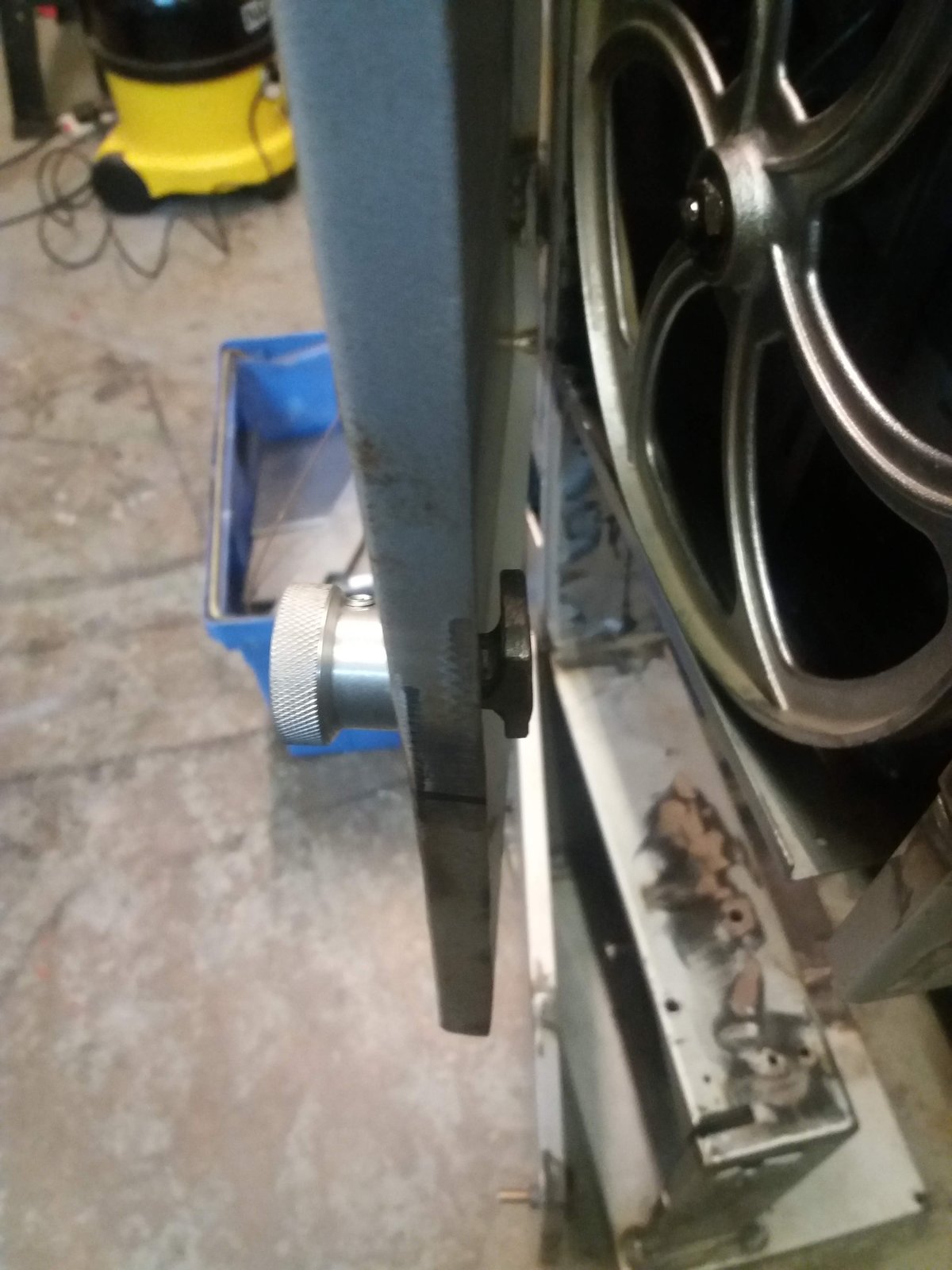

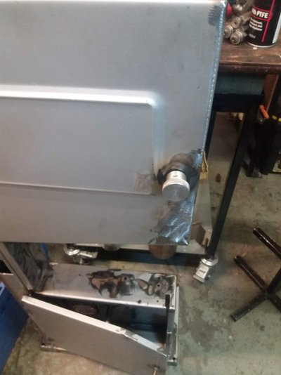

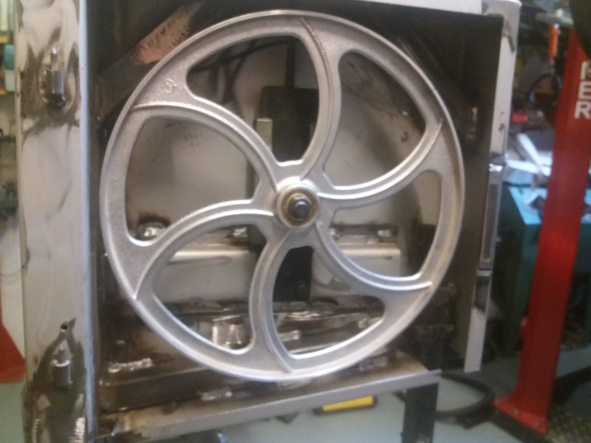

Good evening all. This is my latest project
It's a rexon wood bandsaw I am improving and adapting to cut metal.
The quality isn't too bad for a Chinese machine and spares are available but like a lot of Chinese products I have noticed the quality drops in areas that require workers skill rather than a machine doing the work, welding and cutting being an example.
So here it is before.....

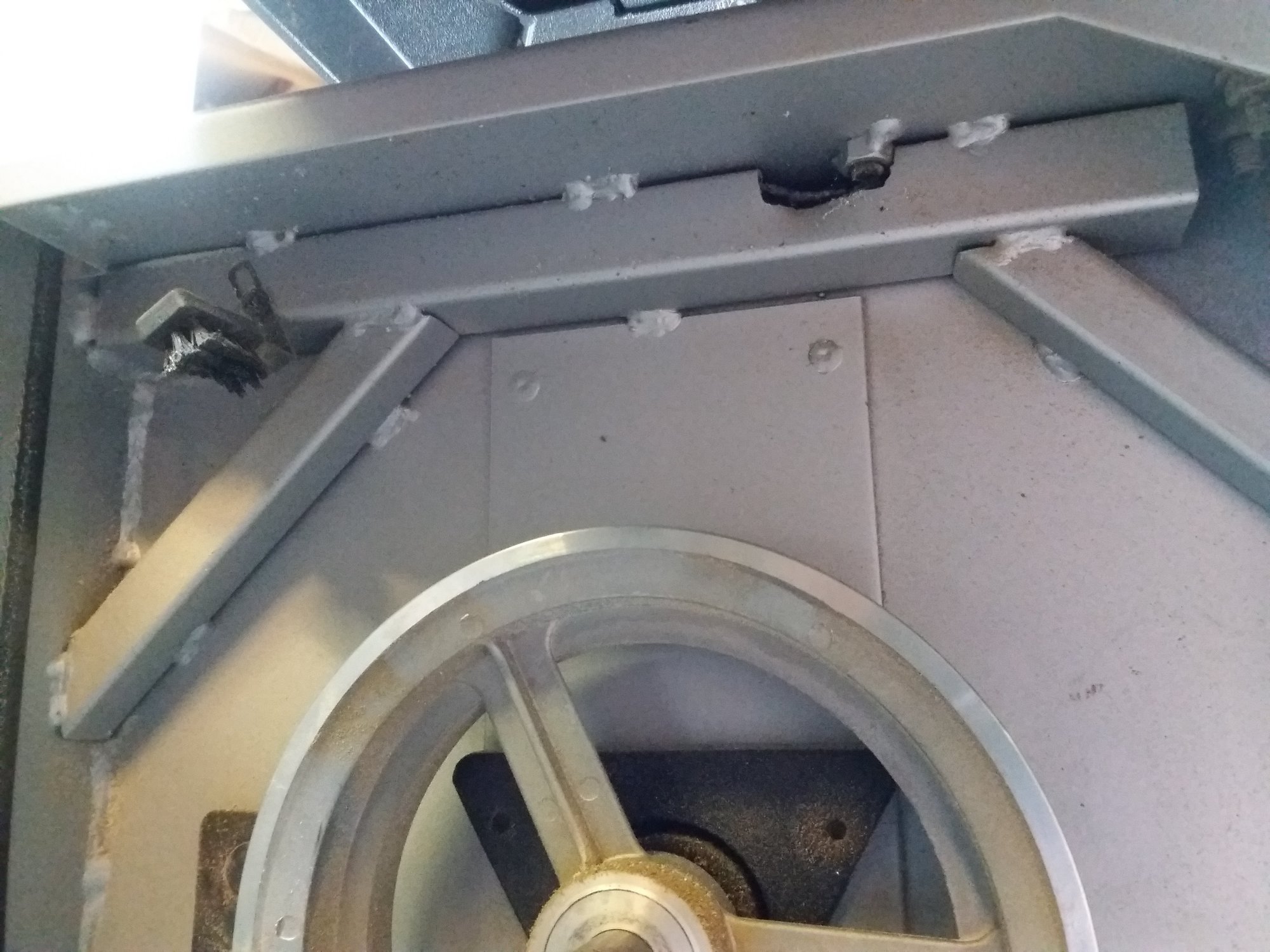

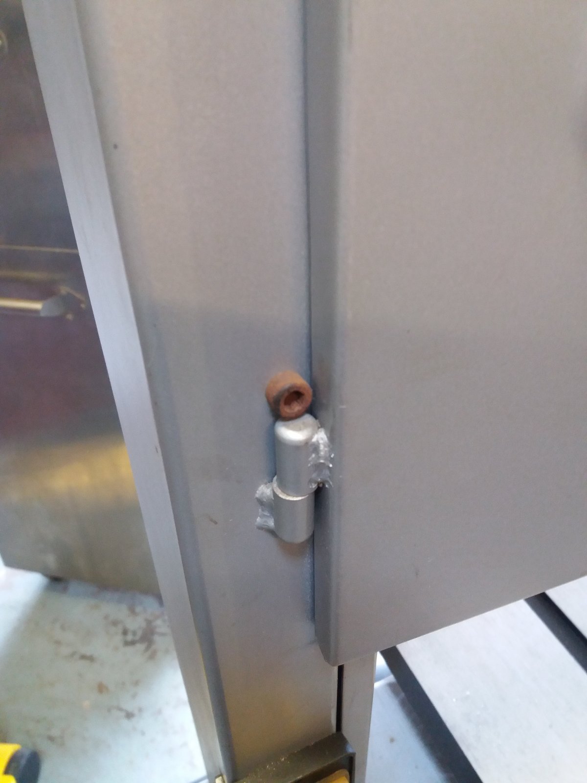

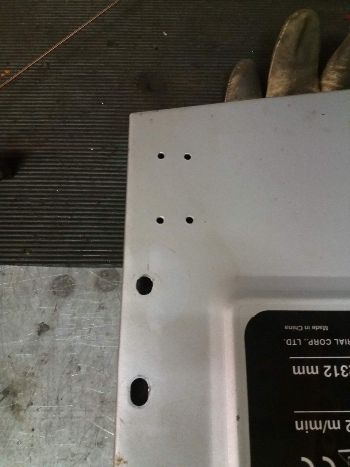

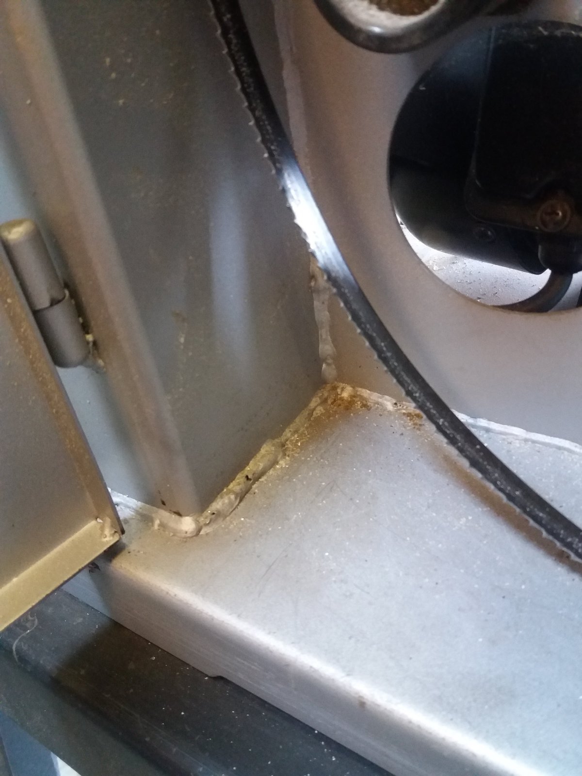

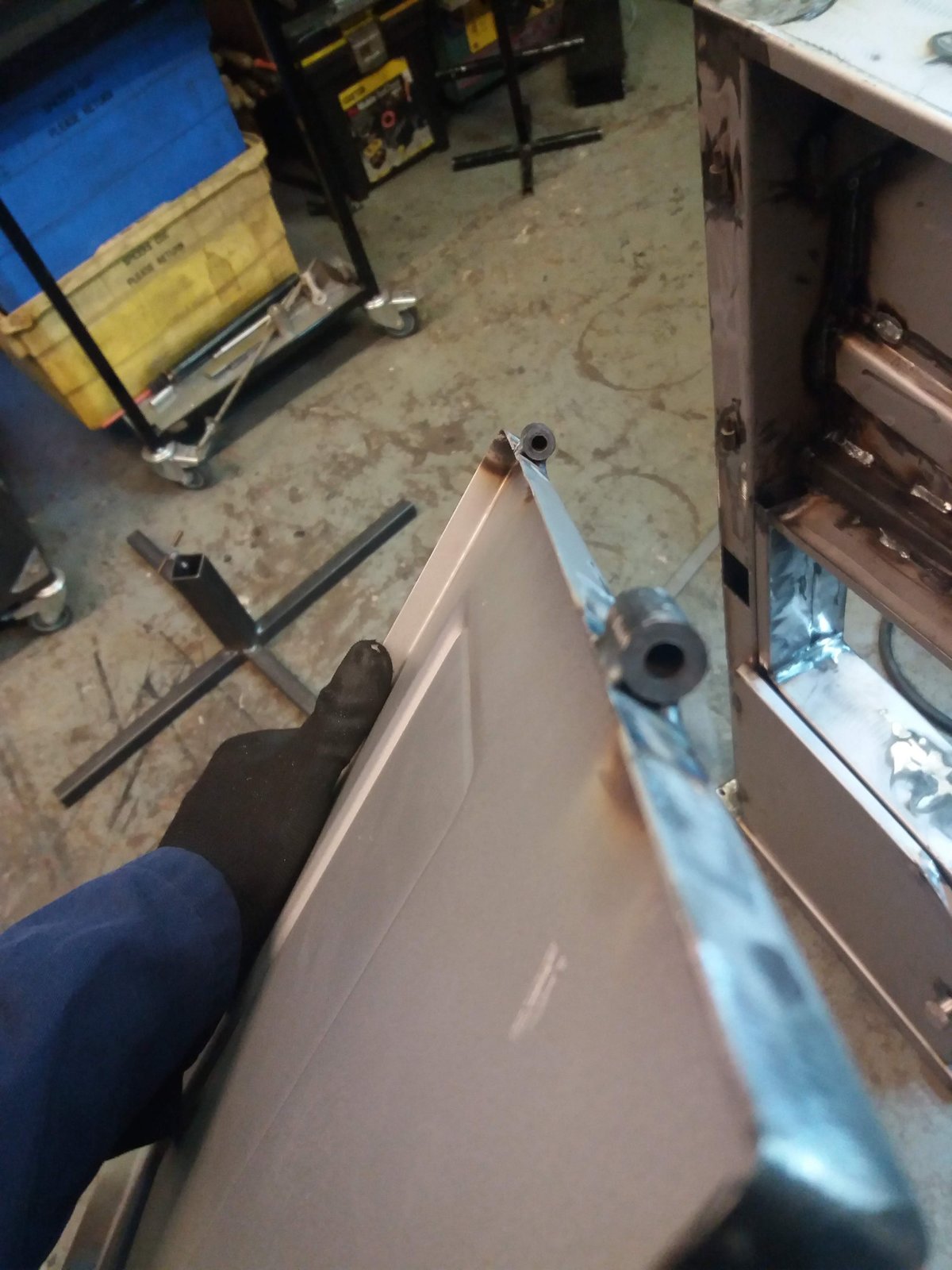

The hinges bugged me as they don't line up and it looks like someone had chewed through the box section to create a clearance hole.
