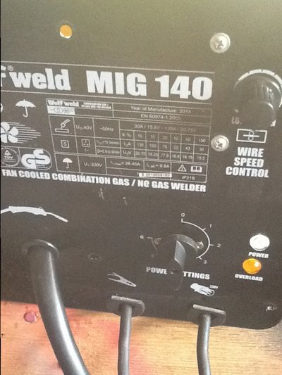

    hi I could really use some help with this one! I recently bought this mig, tested it beforehand. Worked ok, brought it home, hooked up new gas but as soon as it's turned on the overload light comes on, the fan runs, gas comes through the torch but the trigger does nothing!,, I've Checked the pc board for damage and the fuse is ok?? Any advice please?, thanks in advance,

    The overload light you mention is most likely an over-temperature light. With the power off have a look at the heatsink to see if there is a temperature sensor fitted, and if so that both the wires are securely connected.

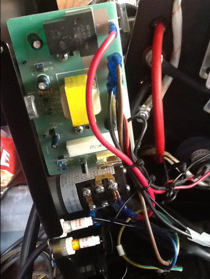

    Any chance of some close-up in-focus photos of the inside?
    Try operating the power selector switch(es) from one end of their range to the other a few times, dirty contacts & switches not quite in the right position have been known to stop welders working. It shouldn't account for the warning light, but any port in a storm.

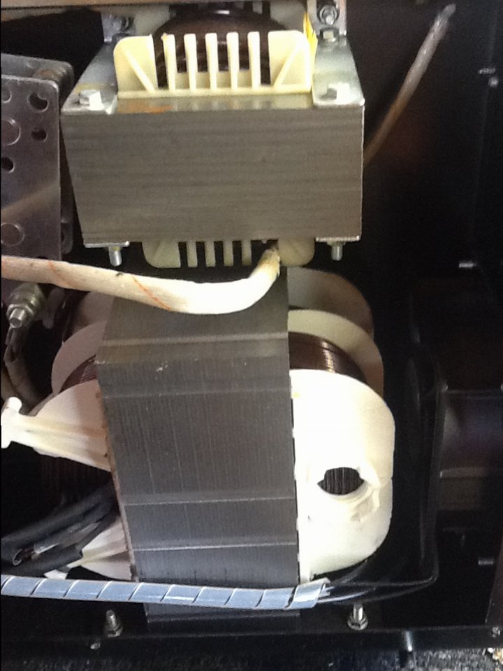

    Your gas will flow when the trigger is pulled as (if I am correct) you have a gas valve in the torch so no need for power to operate the flow.
    The fan should run even in a fault/over temp condition as it would need to cool the machine (main transformer)
    Not sure where you checked the "thermal cut" out on the rectifier as I can't see one there or even a pair of wires going to it !
    There MAYBE a thermal cut out burred in the main transformer (your pic number 3) bottom left is where the power selector switch wires go and there maybe an extra pair of wires for the thermal sensor.
    As some basic checks (remembering the gas valve in torch!)
    Have you checked (metered) the switch in the torch is working ? If you can sus where the wires exit at the machine end and go to pcb, it would be better to check there.
    Has the small transformer on the pcb got 240 (AC) volts in to one side ? Does it have 12 to 24ish (AC) volts out ?
    These basic checks should be done first.
