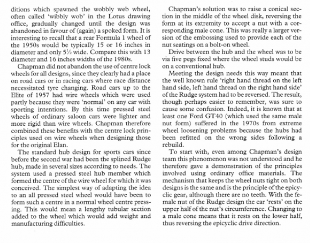

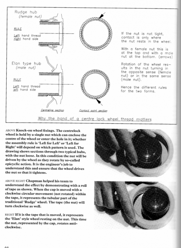

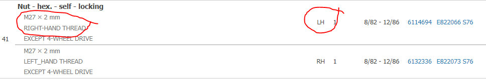

OK, so much reading and so many conflicting answers. Theories for both from piston heads to passion Ford. The Haynes manual has gone through a few revisions as well and they all say the same. I’m doubtful a mistake would have carried over through all the revisions.
The 4x4 version is the opposite, which makes sense as the nut holding the driveshaft in becomes an outboard nut, rather than this which has the nut inboard of the hub.
Will call a main dealer tomorrow and see if they still have the parts catalogue for a 1984 Sierra.
