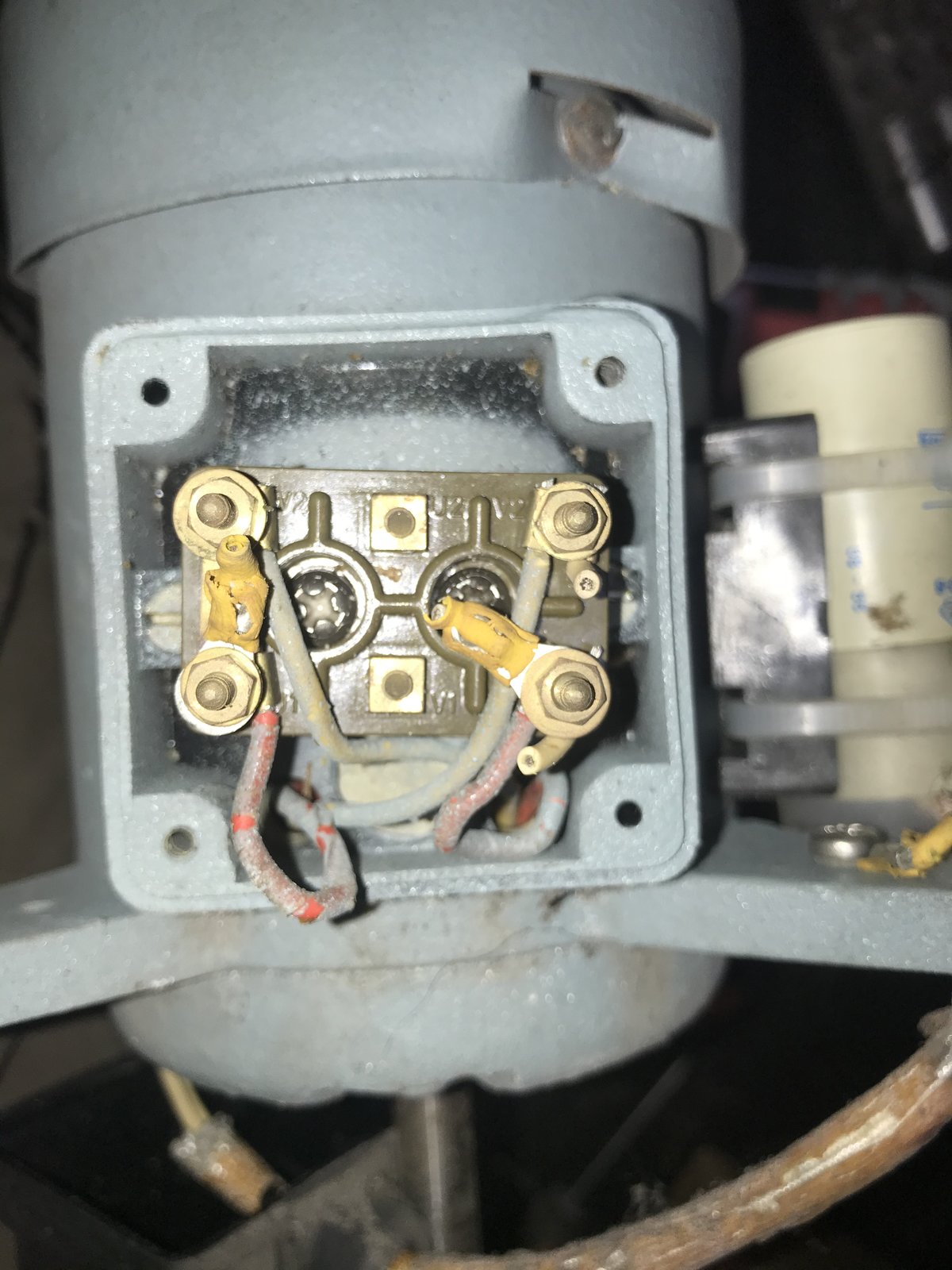

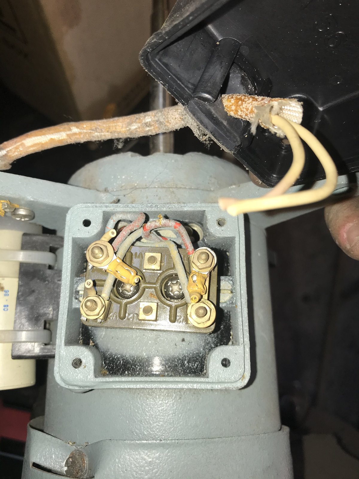

looks like the capacitor 2 wires go to the top and bottom left hand posts because the wires have been cut and live and neutral feed either way round on the 2 yellow crimp lugs.
Worked thankslooks like the capacitor 2 wires go to the top and bottom left hand posts because the wires have been cut and live and neutral feed either way round on the 2 yellow crimp lugs . don't blame me if its wrong![]()
Wanted to see if I could get it to work so I can start planning to use it for a projectChrist that was quick![]()
