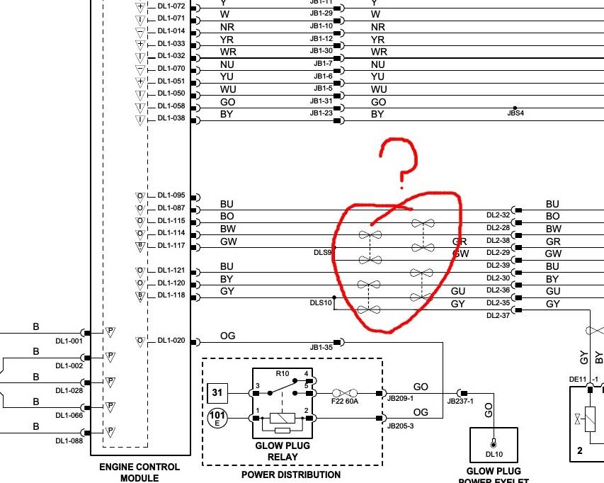

I assume its just a badly laid out indication that the 2 wires linked with the dashed line are a twisted pair.
They usually show the figure of eight over the wires being twisted together, but theses have other wires in between them.
Normally looks like this:
