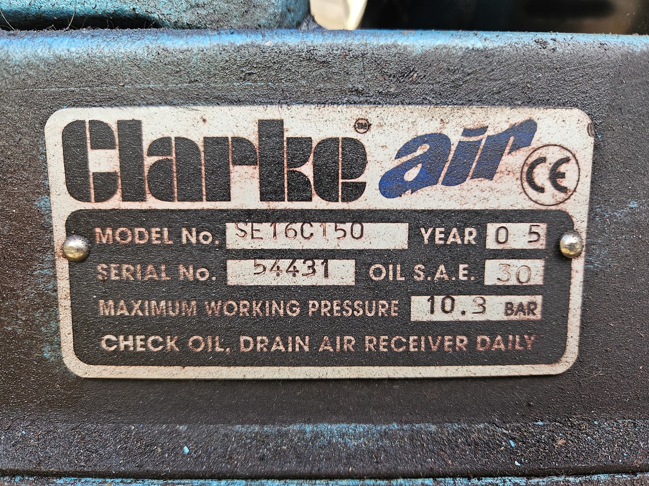

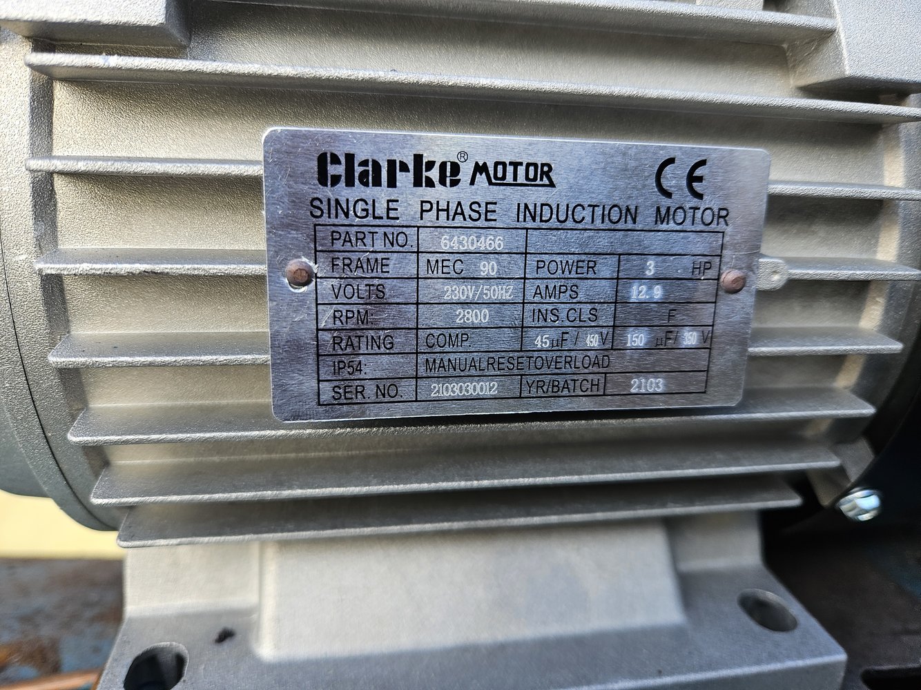

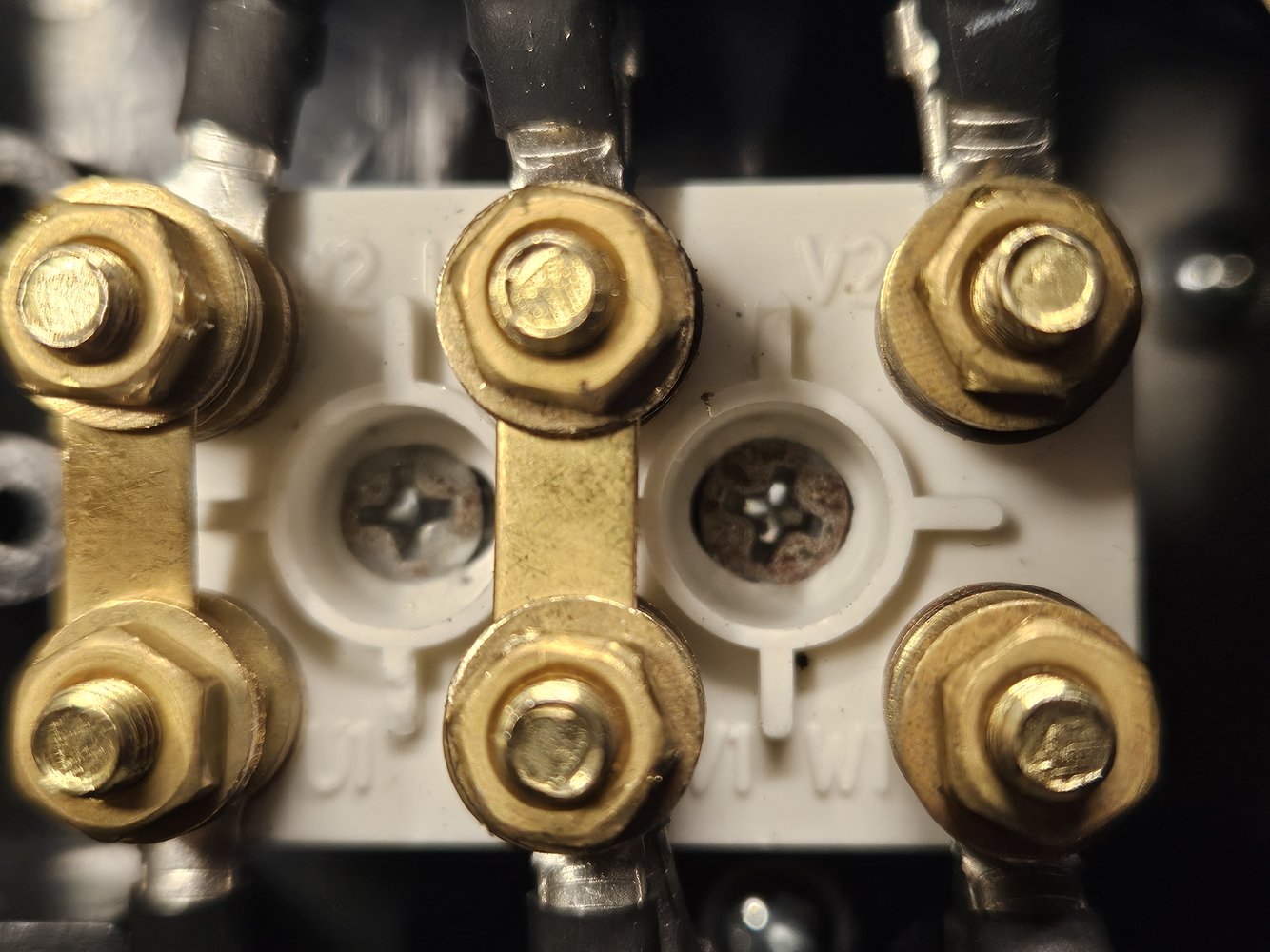

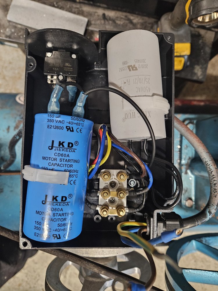

I have this. Ew motor with my compressor. Plated here.with motor plate.
It's has two capacitors and a cut out switch.
I ha e looked online for Machine Mart diagrams but unable to find a diagram.
Also would.it be better to wire to a 16amp plug ? I have a spare that I can run it off or spur from the socket I have fitted
cheers all
cheers all
only 12 amp flc but the starting current is 55 amps
