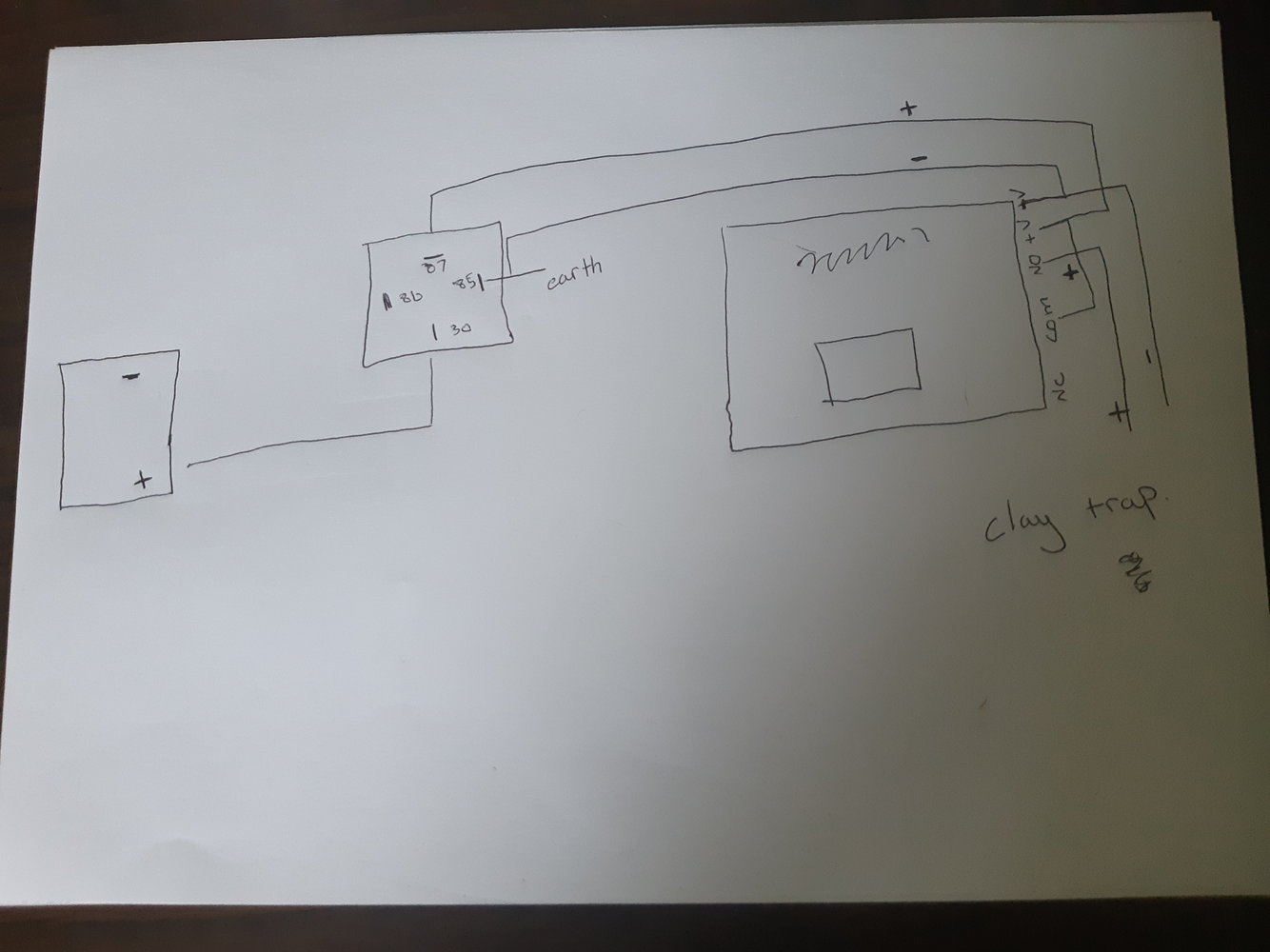

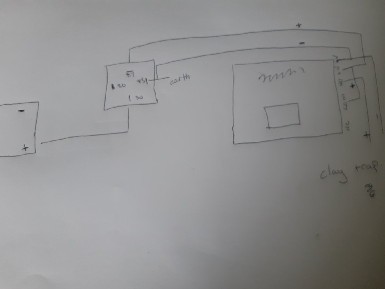

tried to make a diagram. i have bought a 12 volt 40amp relay.
any good
View attachment 347086View attachment 347087
Does that make sence though? As the relay takes 40amps where the wireless card won't be able to handle that oomph.thank you sorry for the hassle as you csn tell its not my thing.

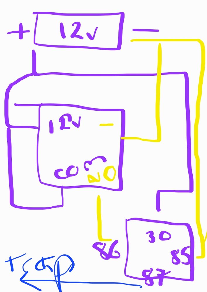

12v test lamps about my level tbh
i wont bother anyone on this thread again . you have all helped enough.
cheers for diagram i will gwt her wired up
thanks
