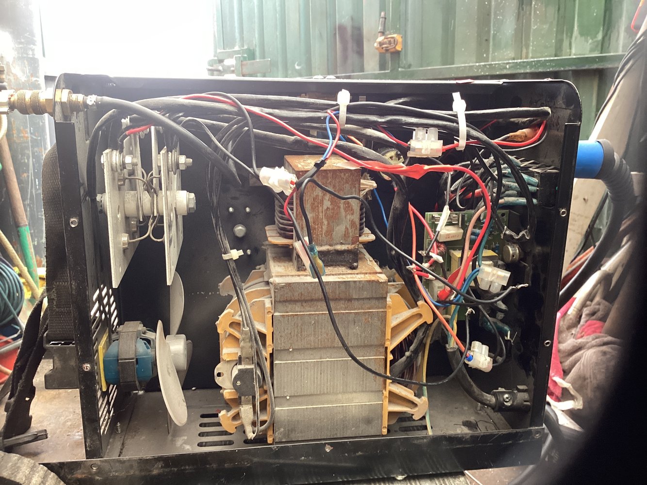

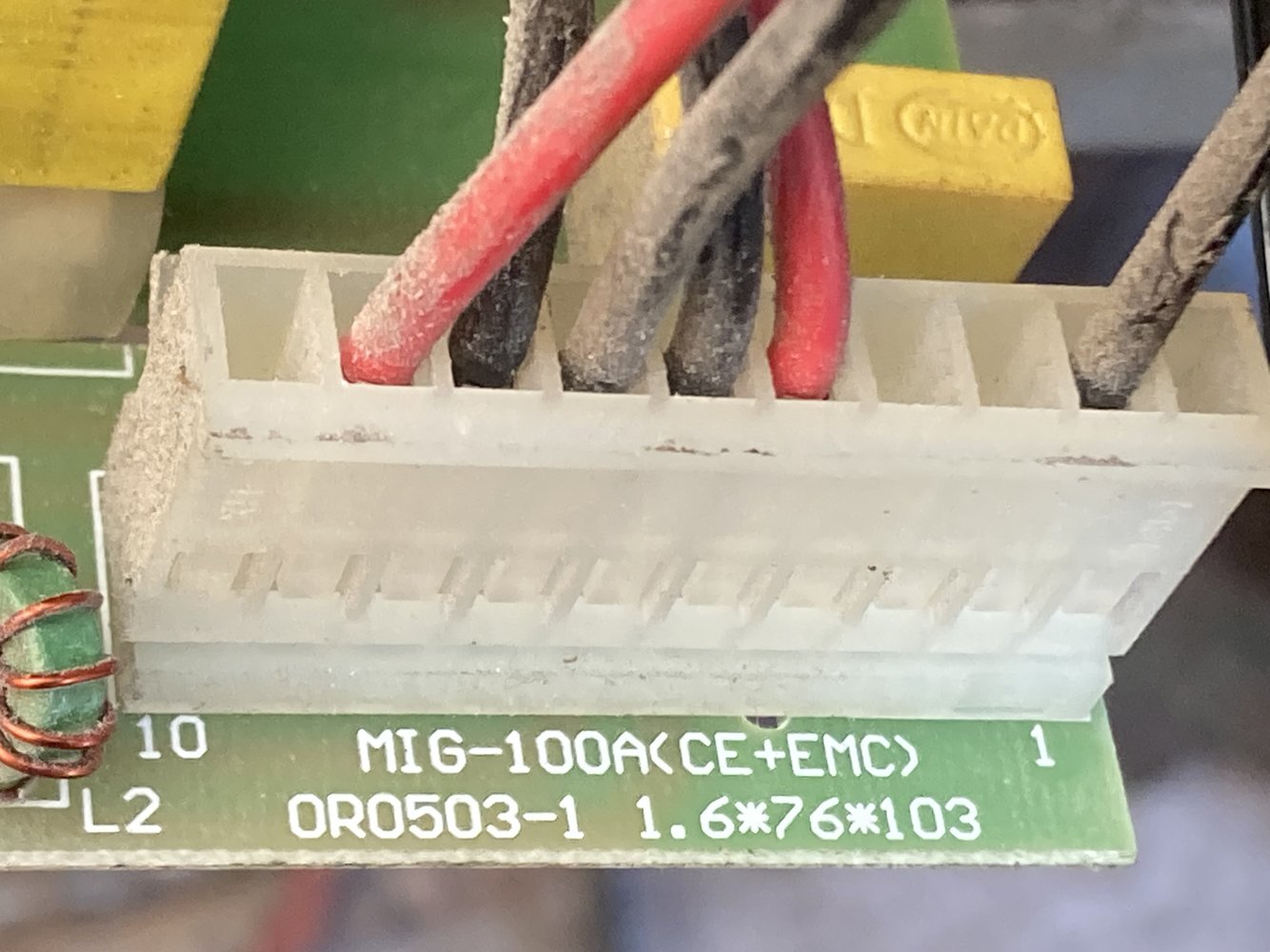

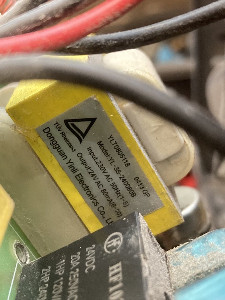

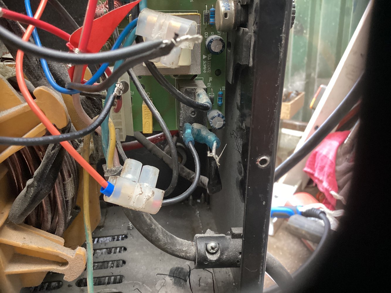

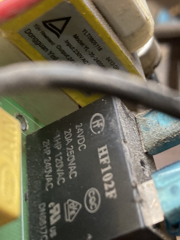

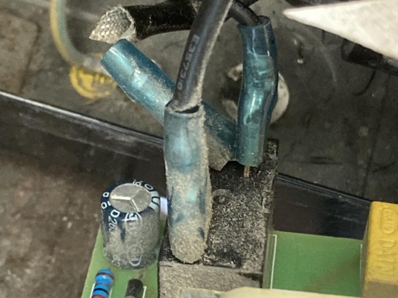

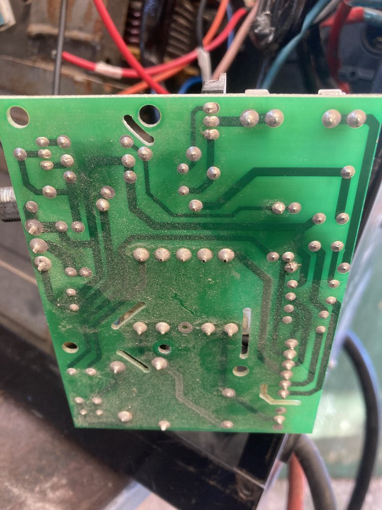

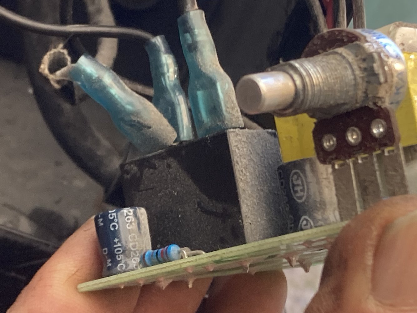

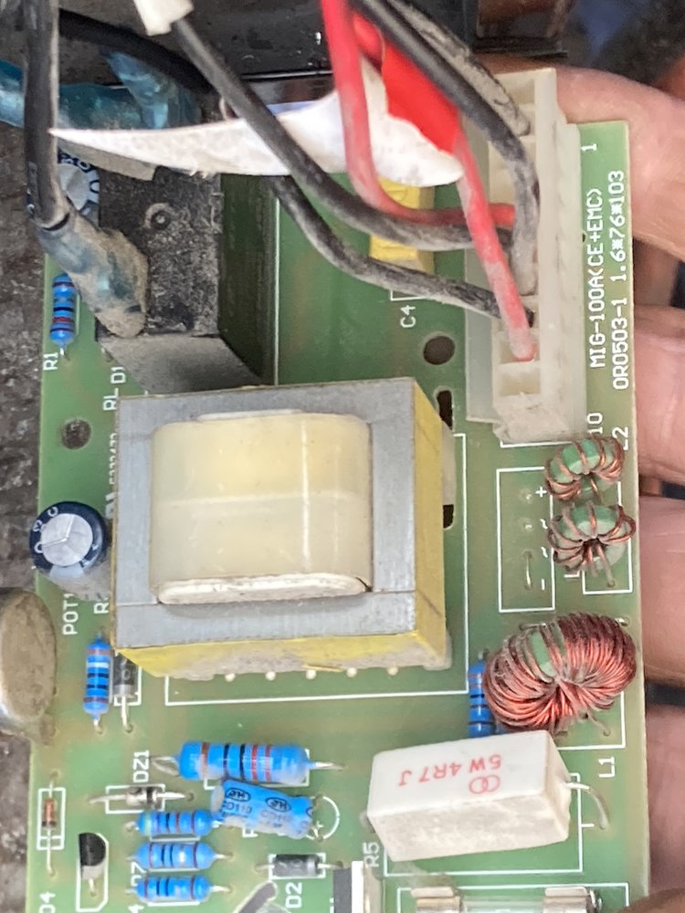

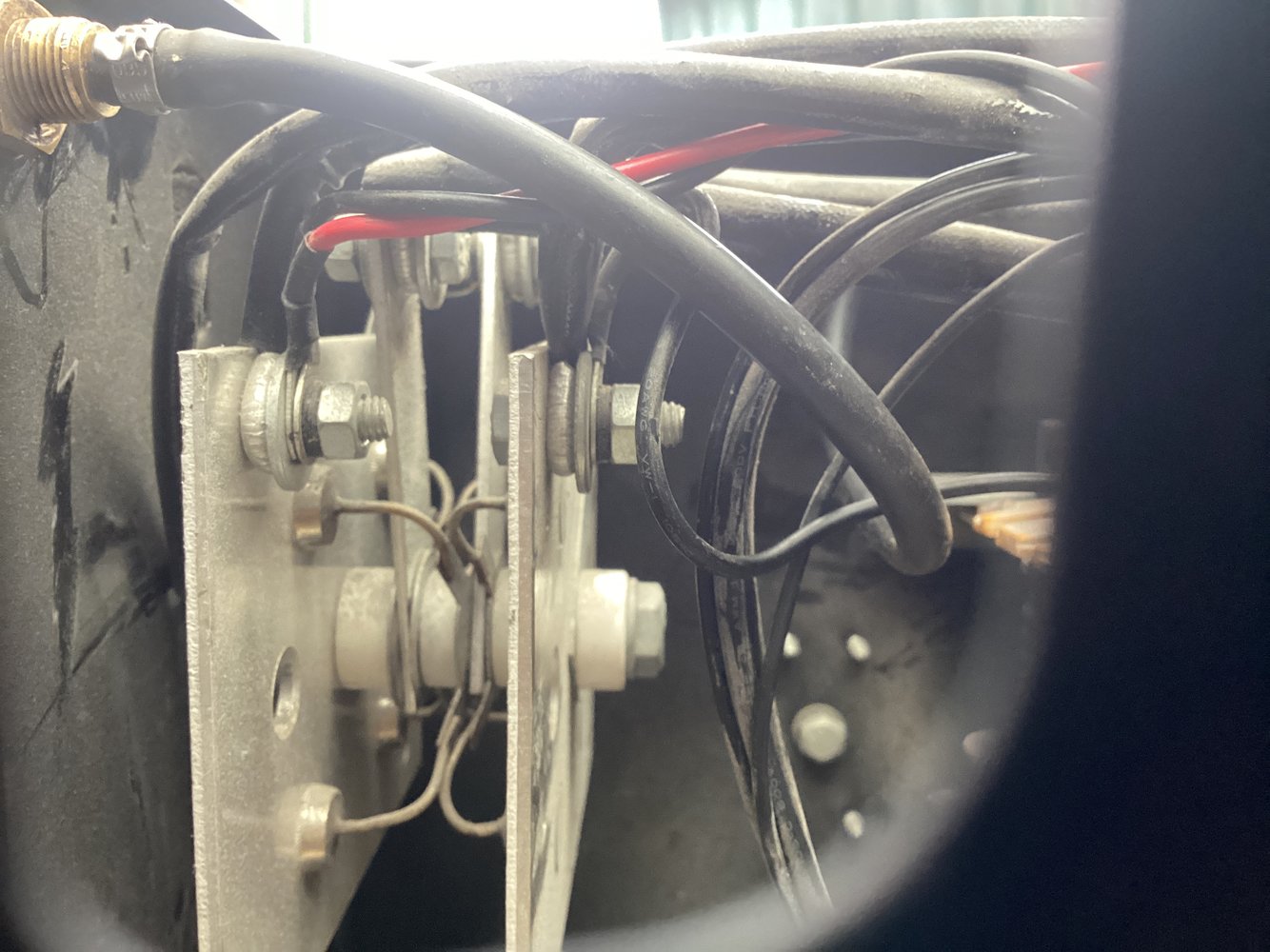

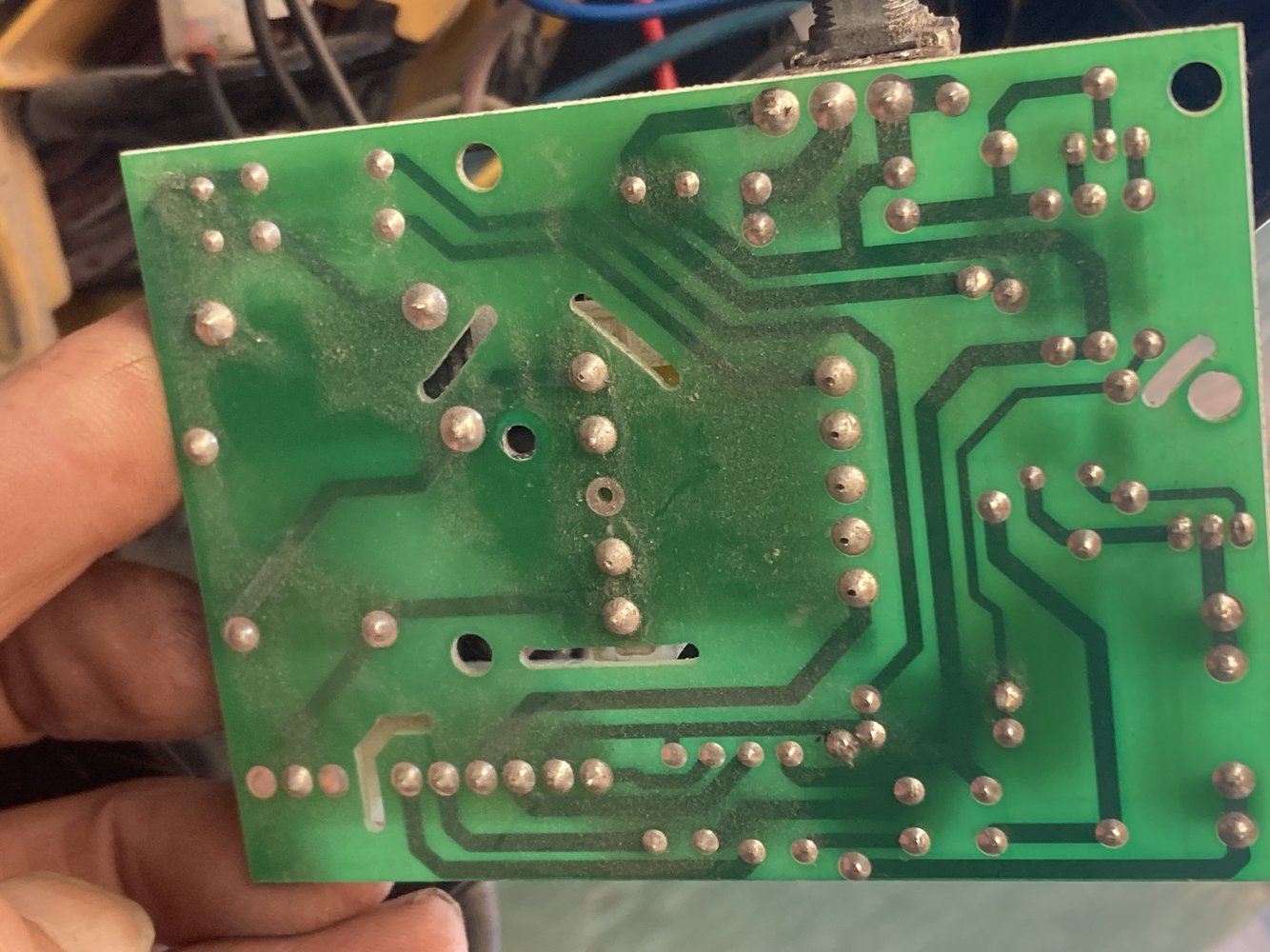

Thanks. Millers not in 4 t. Prob a fault in board ,I’ve got used to triggering it again after stopping, so I’ll carry on regardless, them 300 a contractors are dear just to try it, ! I’d buy one if I knew for sure, I’ll send photos of other later, but will try a separate 24v supply first,as you suggested thanks again ,ah I put euro on and gas valve 2 wires,and 240 v valve
