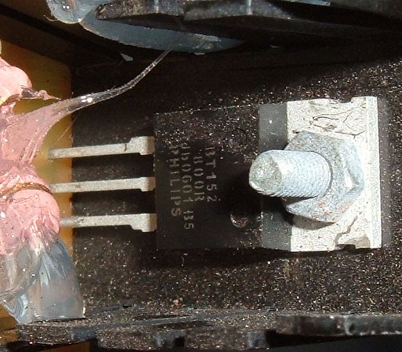

Malcolm, what is the part # on the transistor? Hope it is something like LM317 (voltage regulator) instead of just a transistor like the SIP's use. Probably a common part.
rtbcomp, that is a variable voltage drop. It sets drops the supply voltage by a fixed amount. It is effected by the gain of the transistor that changes with temperature. Does not regulate the motor voltage well.

Yes, looks like they use pulse-width to control the speed of the motor. I would have expected better for a higher-end machine.Strange that it didn't happen from new and that nobody else spotted if it's a design fault. I think something has broken somewhere on my machine.
Here's the transistor. Looked it up - it's a Thyristor - posh! Suggested applications include motor control.
Thyristors don't like inductive loads like motors. Takes a considerable amount of circuitry to do them well. Looks like the same circuit I saw on one of those Wolf welders
I'ld just replace the board. I would check the brushes first. If they are noisy they can make these circuits unstable.
). Though do we know what the circuit is? rtbcomp posted a SIP schematic, and the sketches in the manual aren't all that detailed (things just plug into the control unit according to that).Don't use the SIP circuit!
