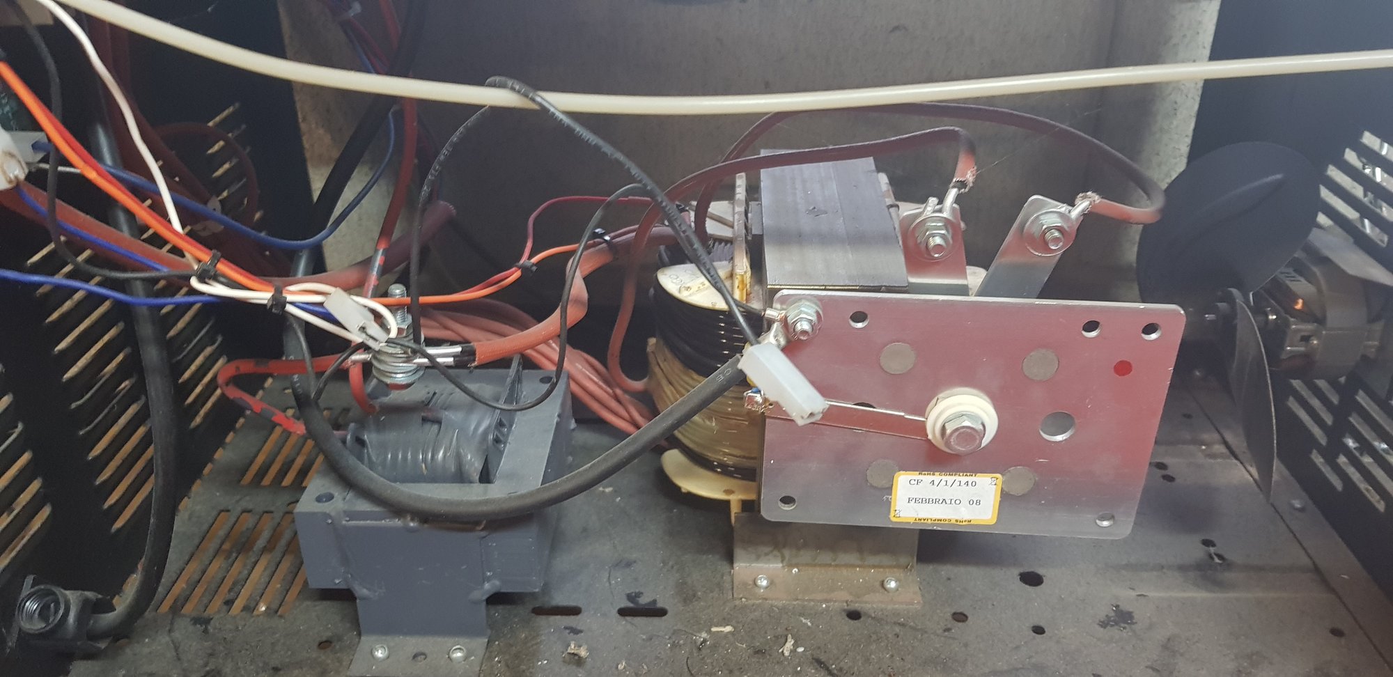

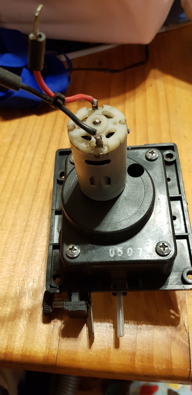

A number of years ago I did purchase a no name (Fema) machine based on its ability to weld down to 25A and due to not knowing if I would use the machine much after I had worked on a classic car. It has worked a treat. Late last year, I had a issue where one of the wires had vibrated off the transformer due to being transported from one location to another. Having dismantled the machine and fixed the transformer issue, I accidentally through haste mixed up the connection of a couple of wires. While the wire feed worked initially with this mix up, I burnt the wire feeder motor out. It has sat like that until now where I would like to fix it.

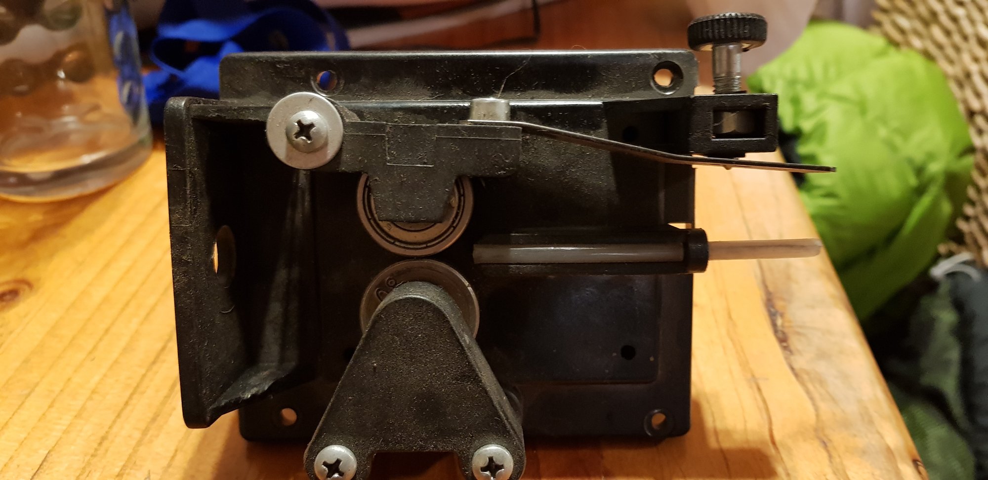

I hope someone may be able to give me some suggestions of what feeder I should buy.

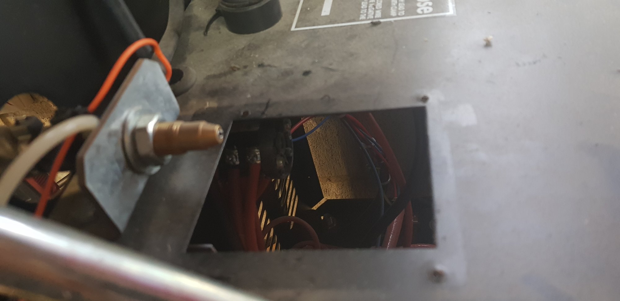

I have measured the voltages across the terminals with a mulimeter at different setting. Please see below.
Is there anyone who can recommend a wire feeder replacement? I can't find one online for this machine and while I am am it, it would be great to replace as I have read much on this site that these feeders commonly found in SIP's can cause spasmodic wire feed problems. The other issue for me I am not convince on what voltage the motor runs at. I see there a 12v, 24v and 48v motors that migs run.
