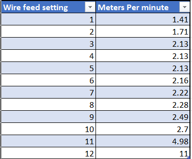

I have been using the wolf 140 but have always struggled with the wire speed. the following is the speeds I get when I check manually.
I would have thought the sensitivity would increase more lower down with 12 steps id expect 1m per step nearly. i assume the speed is set by the potentiometer switch so swapping it out might solve the issue
