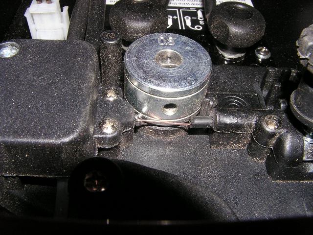

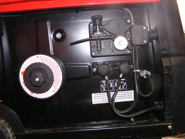

Been very happy with my new toy (Clarke 160en) except for a wire feed problem however being a total novice thought it was just me. Over the weekend my friends son who works in a body shop, needed a welder so I loaned him mine. I was not about at the time but the report I got back was nice welder apart from wire feed problems. This encouraged me to investigate further (see attached). When I bought the machine it was set for gassless and I was told to turn the roller round to use the thinner wire and it looks like I did not push it in far enough. I have repositioned it andthing work so much better now and will hopefully save time wire and paitence.
