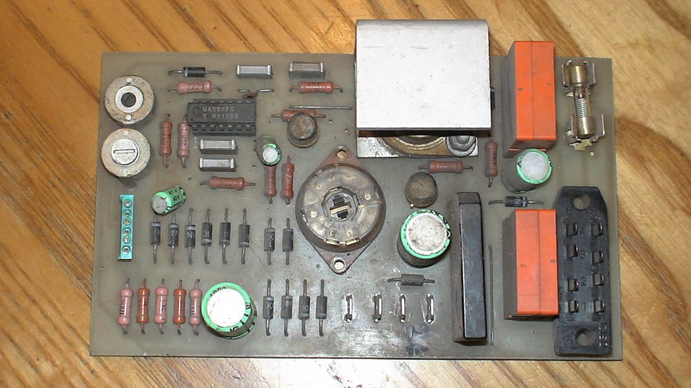

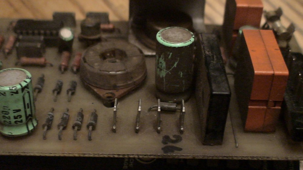

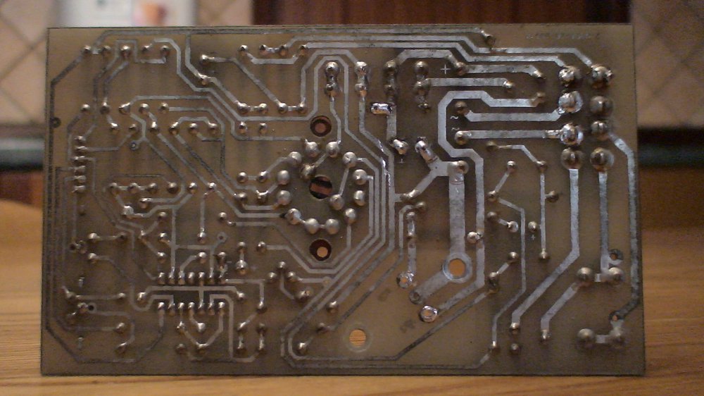

Hi,first time so here goes,

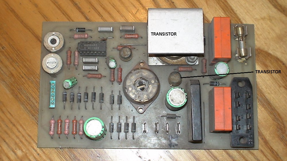

I have a problem with the wire feed not working on my ELAND160.There is nothing wrong with the 24v DC drive motor as it works OK when connected to a 24v battery.The transformer shows 27v AC supply to the PCB.When trigger is operated the motor terminals on the PCB show 27v DC,but when connected to motor show 0v.It won,t even generate a spark across the terminals.
Can anybody help,Thanks.
