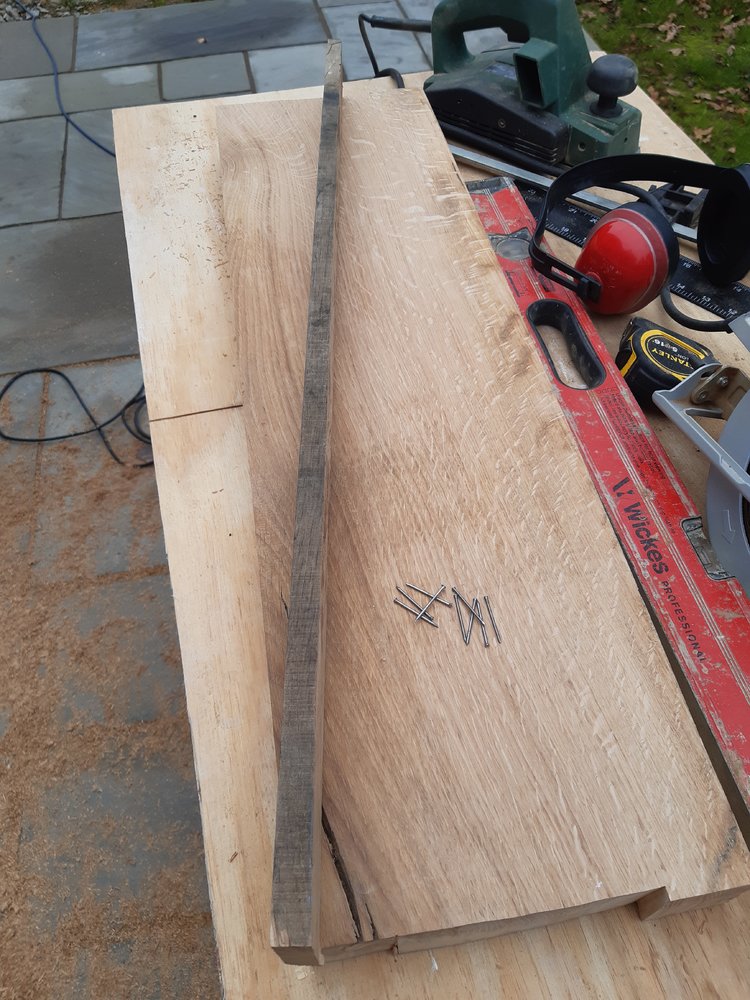

Done a bit of that myself working on older buildings. Gotta keep things in keeping.I've seen faux roof beams made to look old with an hand axe and angle grinder. Bang a few coach bolts and some square washers in here and there.

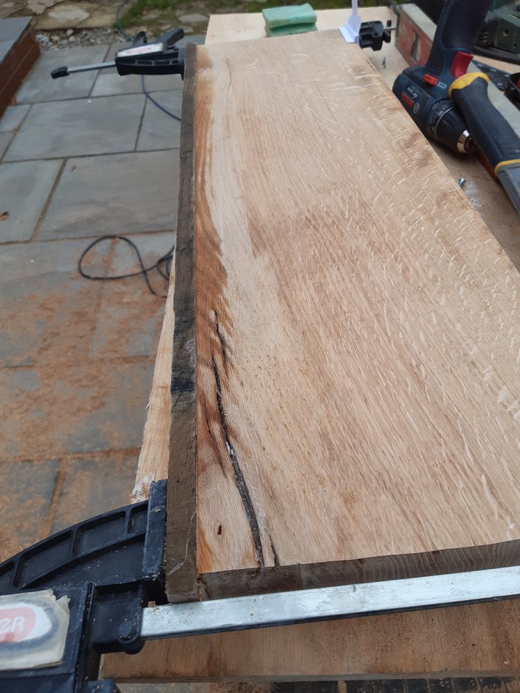

40 grit Flap disk and belt sander is my method. Did have a curved hand plane I made that was useful. Lost in the mists of time.
Na. Far to prone to grabbing a gnarly shake and breaking a chunk off. Prefer the flap diskDon't forget the spokeshave!

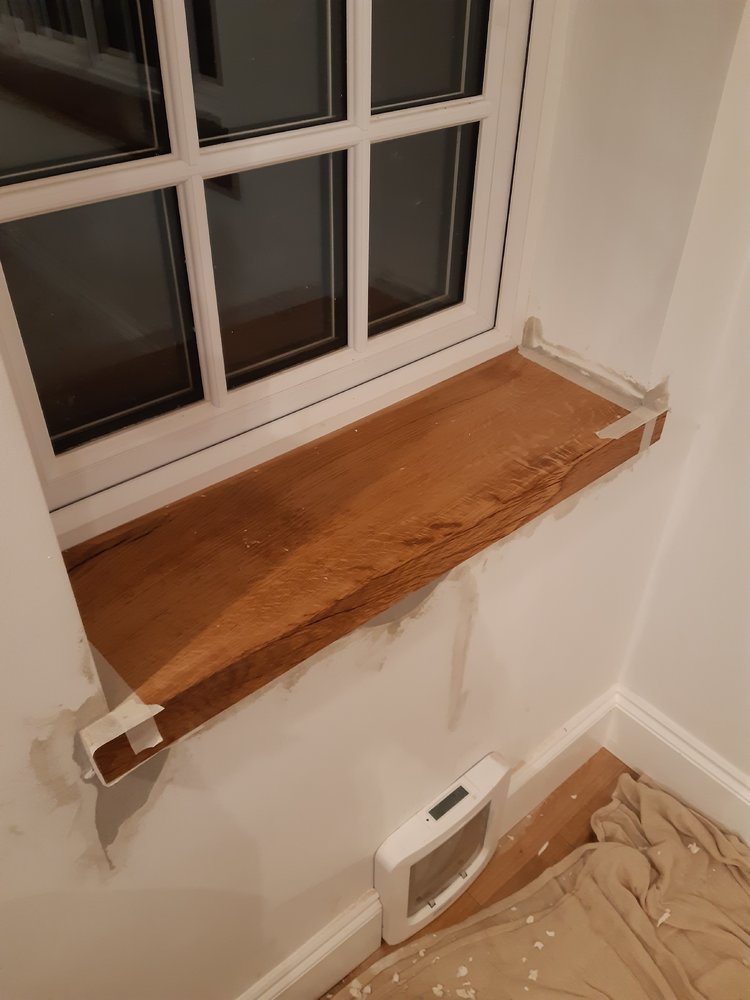

Yes it's had 3 coats of oil same as the others.
