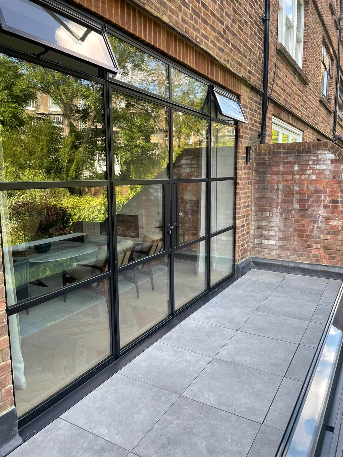

Ah thanks for those. Good leads. Not exactly the same profiles but that's at least something for me to go back to the client with, cheersIs it similar to the ones here:
The W40 Steel window profile | Steel Windows and Doors London
Upgraded W20 steel window, the W40 Steel profile allows for larger double glazed units. Beautiful doors with greater thermal performancewww.steelwindowanddoor.co.uk
They refer to the Steel Window Association:
Steel Window Association – Association of Steel Windows
steel-window-association.co.uk
Also:
Not exactly the same profiles...

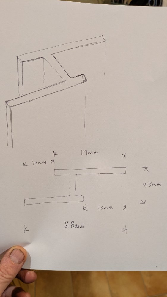

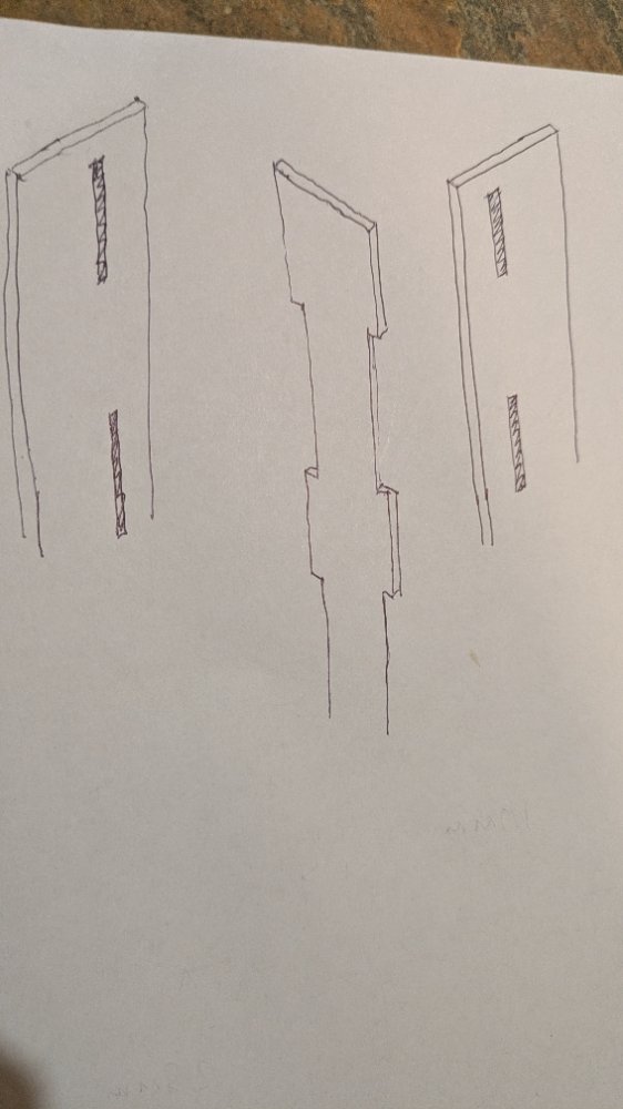

as good a method as anyJust had this an idea of how I could get it water cut & then assemble. If I welded on the outside faces of the tabs it could workView attachment 518839
