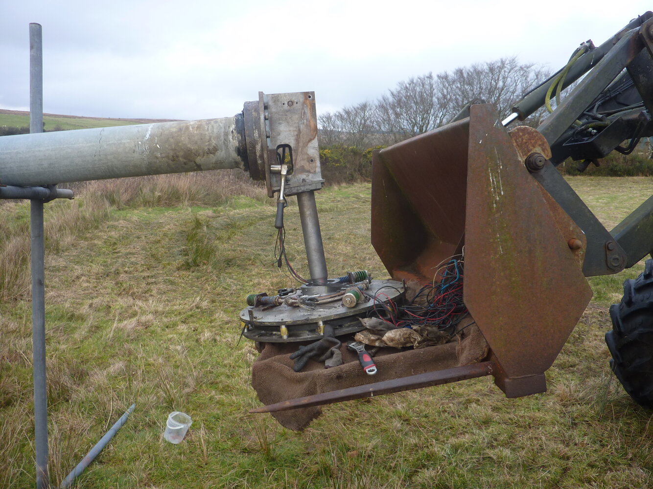

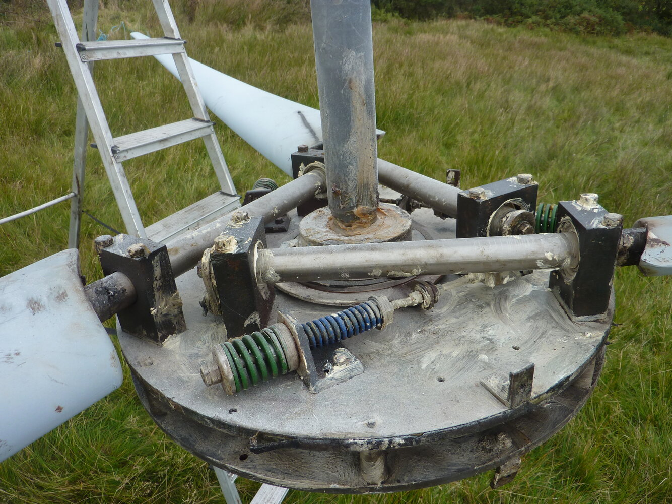

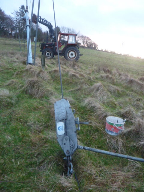

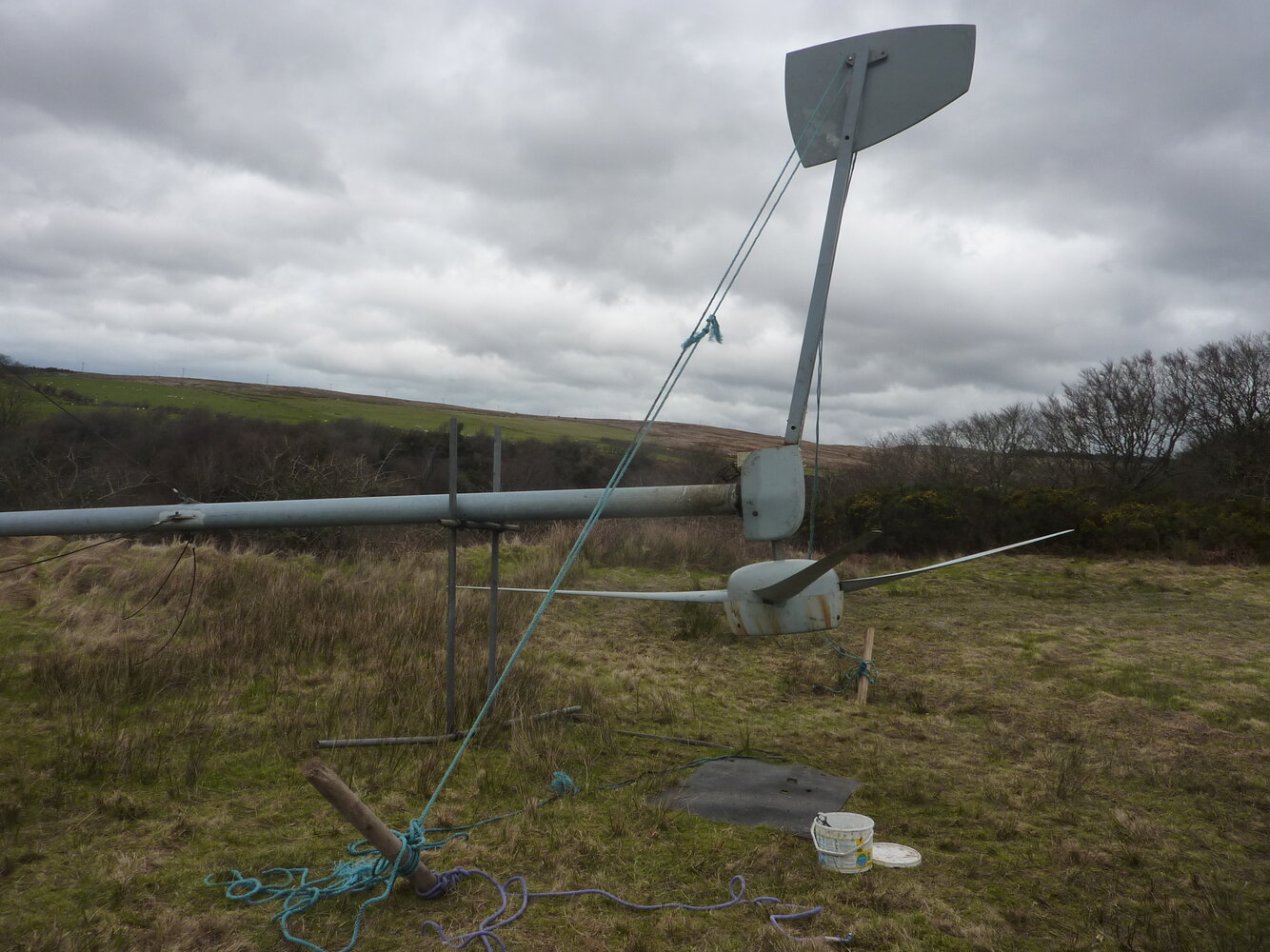

Last September I lowered my 5Kw wind turbine tower as it was taking stronger wind to get turning than it should, though strangely once spinning it would keep going in very little wind. With the hub pointing down and tail vane pointing up, it span without restraint, but lifting a blade and trying to turn it revealed it was rubbing, so the main bearing had failed. It was commissioned 19 years ago, and the main bearing went after 9 years, and the main hub/shaft was returned to the current manufacturer for renovation as they thought it not possible for home repair.
This time I thought I would do the repair. The problem was the bearing with housing and shaft that needed replacing as a unit was unavailable.

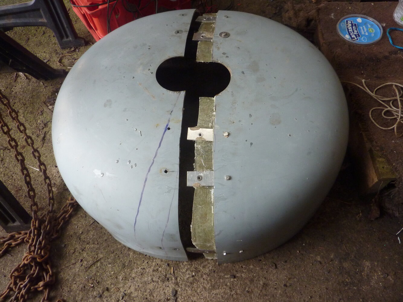

I perhaps too hastily had taken an angle grinder to the fibreglass hub cowling to get better access..... The blades and tail vane were taken off, then the main hub unit unbolted from the large swivel bearing at the top of the 12m tower, and taken back to work on.

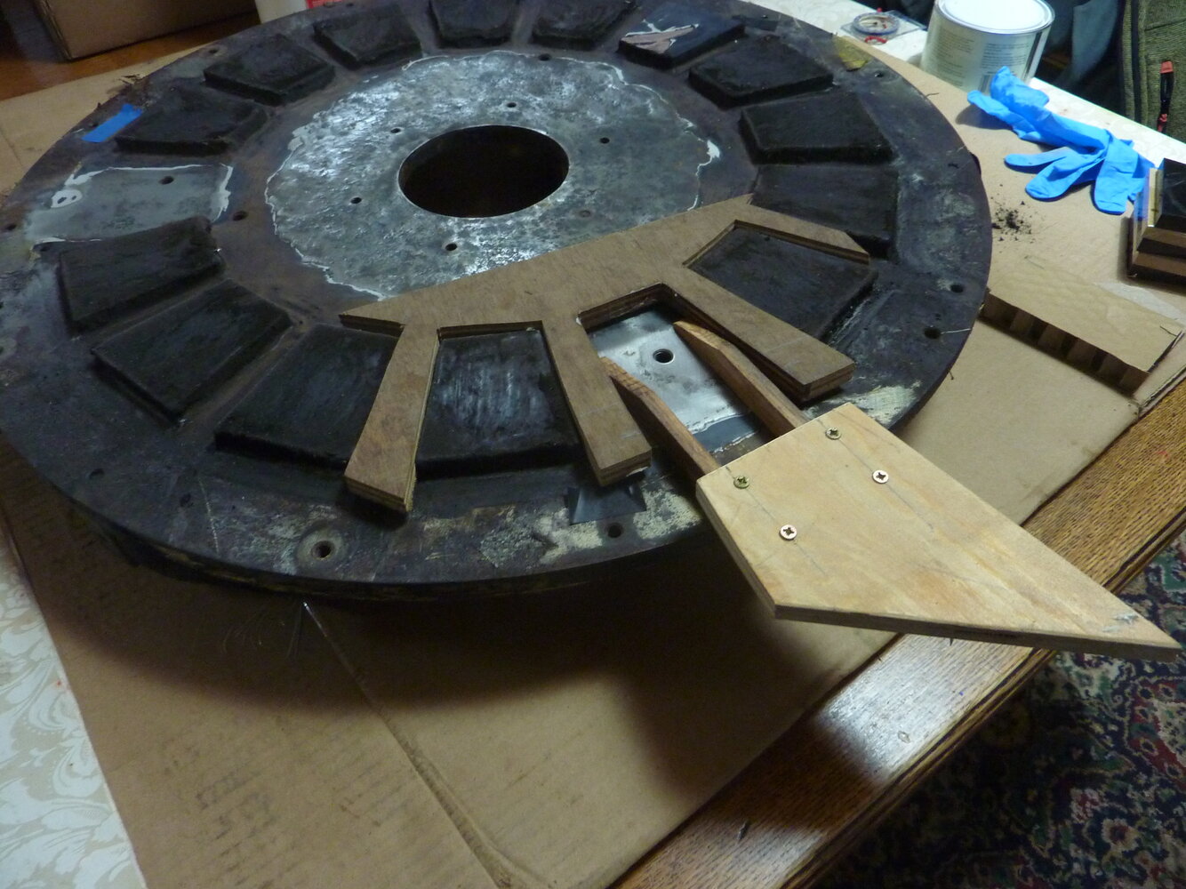

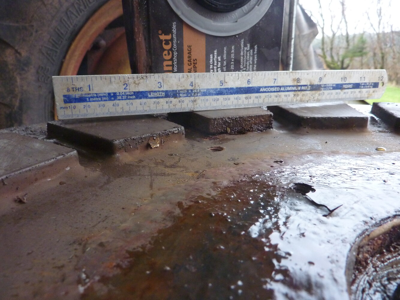

The rotor consists of 2 large 15mm plate discs each of which has 16 rare earth very powerful magnets. The stator sits between the 2 rotor/magnet discs and the coils are set in a resin disc, with about 4mm gap between stator and magnets. I was told there is a 4 ton magnetic force pulling the 2 rotor discs together!

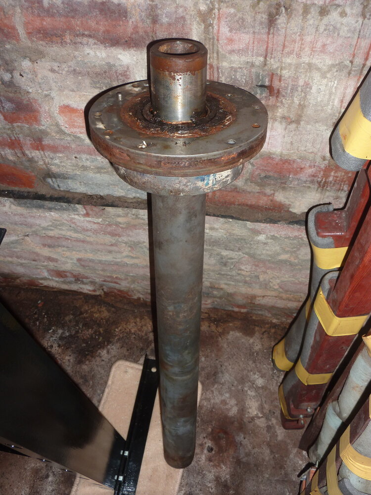

Eventually the bearing/housing/spindle assembly became available and sent to me, so I set about dismantling the hub. 3 of 8mm, 8.8 grade studding was screwed into the inner rotor and nuts and washers used to gradually wind the rotors apart. Had to be careful as if the spanner got a little too close to a magnet it would try to snatch it out of my hand. Once separated by about 7in, it was possible to carefully lift the rotor off and place it down on some wood.....with nothing ferrous close.
The stator was held onto the shaft with a Tollack fitting, which was new to me, but reasonably straightforward to remove.
The old shaft/bearing unit.
It weighs 62lb. Much of the difficulty was the sheer weight of everything as I was working on my own with occasional assistance from my wife.
