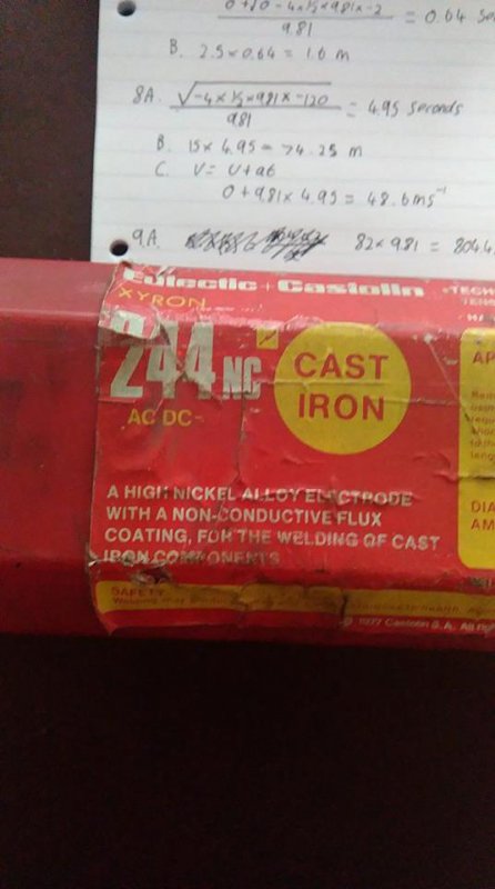

How does gas welding fair up against mma or tig? If you dont mind I'll have a dig through your posts for a readyou can get small repair packs. I know Al knows his onions on consumables but MMA just wasn't allowed by my old boss and we took in a lot of broken castings, turned a good few away but then I have posted about gas welding cast before.
My customer has said he is going to make some clamps to further strengthen the winch but having only seen the thing in the pocs i posted its hard to see the finished job being long lastingI'd still advocate fabricating a repair piece which you attach to the winch body after tidying up the break. Bolt and/or weld that on and have bolt holes where the original flange was. You're lucky to have both pieces relatively intact so dimensioning the repair should be easy peasy. The bonus is you can make it stronger than the original.
S.
So if i used mma would i not need pre/post heat?Sticks have a special graphite based coating that runs on very low amps. This restricts the heat but maintains the penetration whilst keeping the casting cool. You need to either keep it cool or very hot (over 538oC), in between causes more problems.
This is why little short runs and peening are recommended

Yes. If your welding cast iron you need to do some homework on how to do it properly. You don't want to pull bits of info out of this forum incase you select the incorrect bits.So if i used mma would i not need pre/post heat?
I've got a box of cast iron MMA rods, don't know if they'd be any use but I'd be happy to send you some if they are;
They're 3.2mm (Assuming you measure the metal, not the flux).
Any use?
Don't be sorry, disagreeing is what it's all about and makes for interesting reading. I don't think welding it cold is the way to go at all. It needs to be an even temp yes but welding it cold doesn't achieve that as you've got localised heat followed by rapid cooling. Bad combination IMO for cast iron. Also there is little point preening a weld that has cooled down. The preheat keeps the welds hotter for longer making the peen/stress relieve far more useful.Sorry to disagree with Richard, but you do not need preheat.
You do it cold with MMA, weld a small bit at a time (an inch at the most) all the time keeping it cool - you must be able to keep your hand on it comfortably. While it cools peen the weld (tap with a chipping hammer) to expand the filler metal. Then repeat until it is all done.
The thing with case is to keep the whole piece at an even temperature. Any heating or cooling must be done very gradually so it soaks through the entire piece. Easiest is to weld it cold slowly with MMA. And you can buy the rods in small packs, my local welding supplier sells them individually.
3.2 is the core diameter.I've got a box of cast iron MMA rods, don't know if they'd be any use but I'd be happy to send you some if they are;
Any use?
Any use?
The problem with cast iron is that it can change phase which involves a volume change. It happens on the more popular grades at 538oC. The volume change can crack it especially if there are big section differences. So its best to either heat it above 538 or keep it below (ie no preheat). A bit of preheat takes it nearer the 538.I'm not saying it's wrong as I've also been told this whole weld it cool or hot thing works so I'm sure there is a proven method I just don't like the thought of striking up on it cold. IMO I'd always weld it hot. Logically (to my mind) it seems a safer bet.
