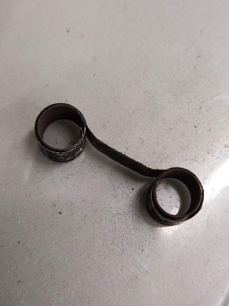

I think I need to bolt it all back together as the 2 bolts earth the 2 brushes
It might be how the picture is take but it looks like two of the brushes (right hand pair) have had it or are stuck as was mentioned before.
Free them up and plenty of electrical cleaner.
Same for the field windings, plenty of cleaner and ideally a vacuum cleaner to get the dirt out (compressed air is liable to drive the dirt further into the windings).
several hours in an oven is also a well proven way to revive motors that have got damp
