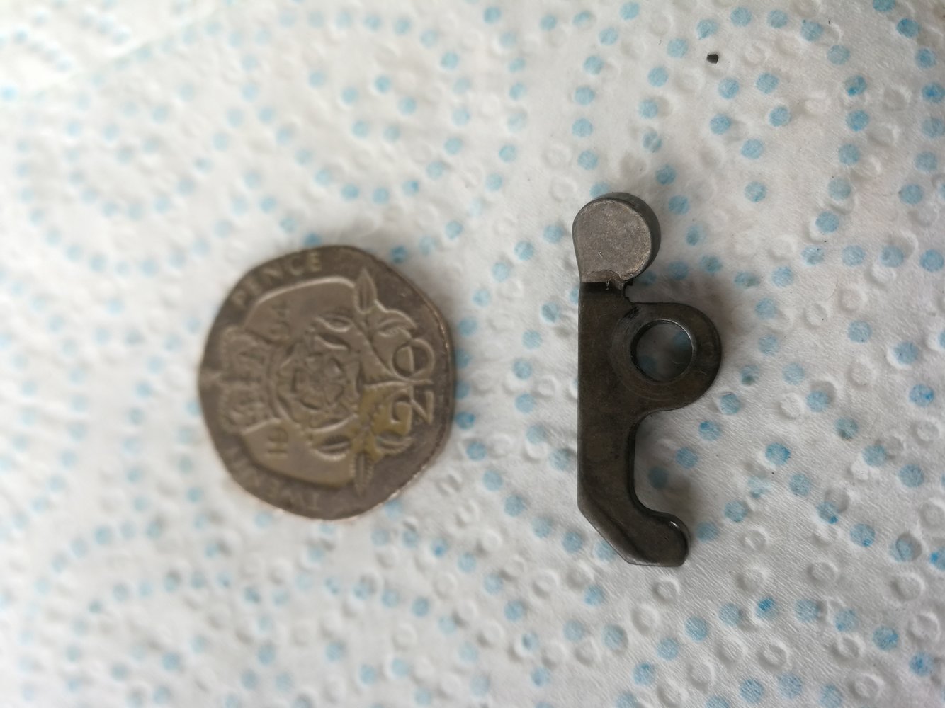

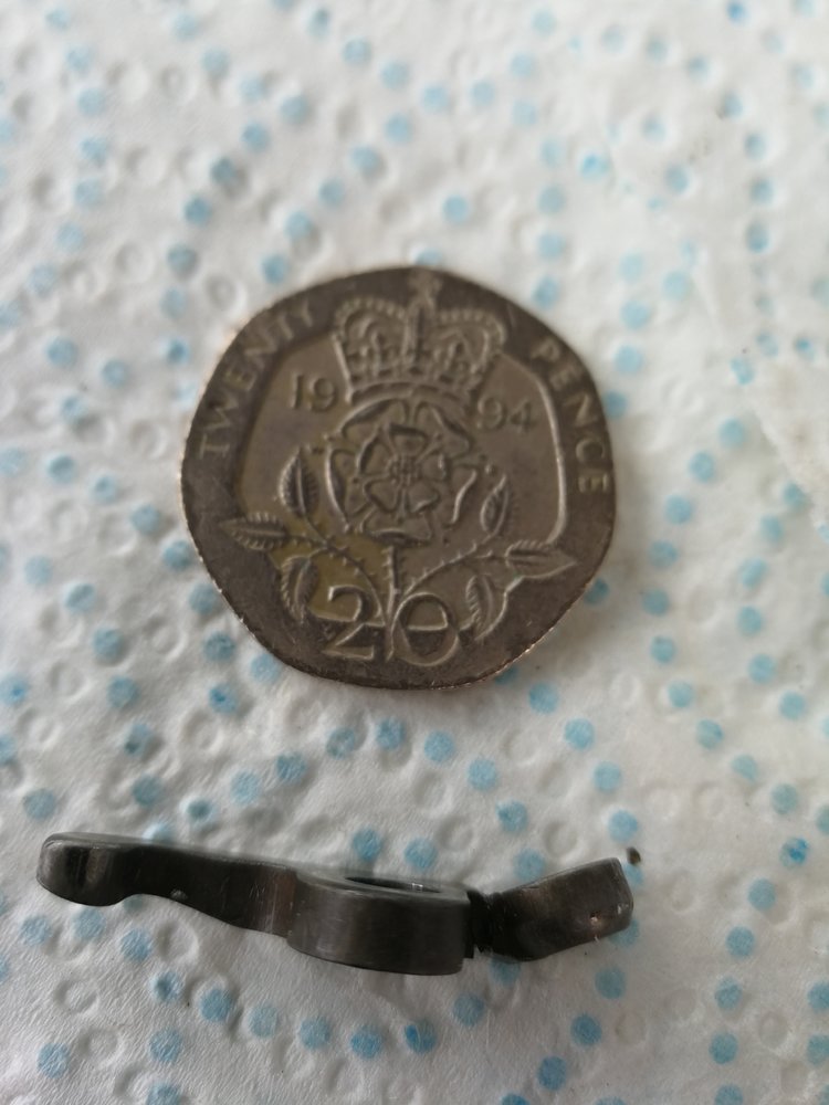

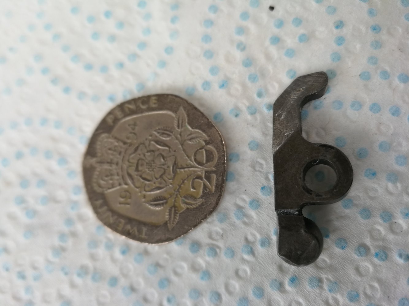

Nope under the governor cover......Heat to straighten, tig weld with full penetration+ extra meat then file back, I presume it's on the outside of the pump?
If not new part...

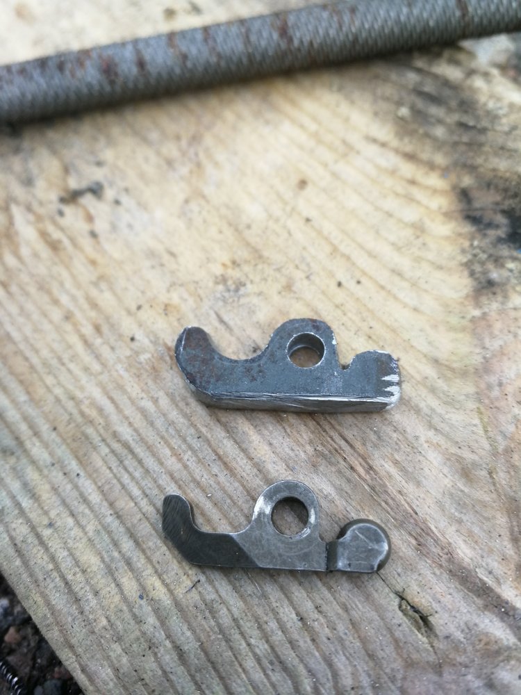

Hand filing is bloomin hard work!!!easy enough to make a new one.....
why risk it.
not enough meat on the bone for a decent weld......
brazeing ?????

Found a sliver of 5mm bar....
