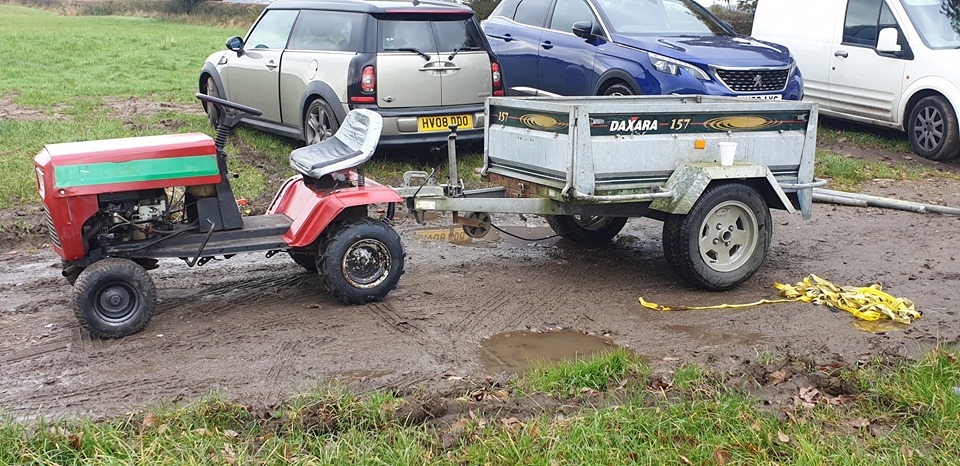

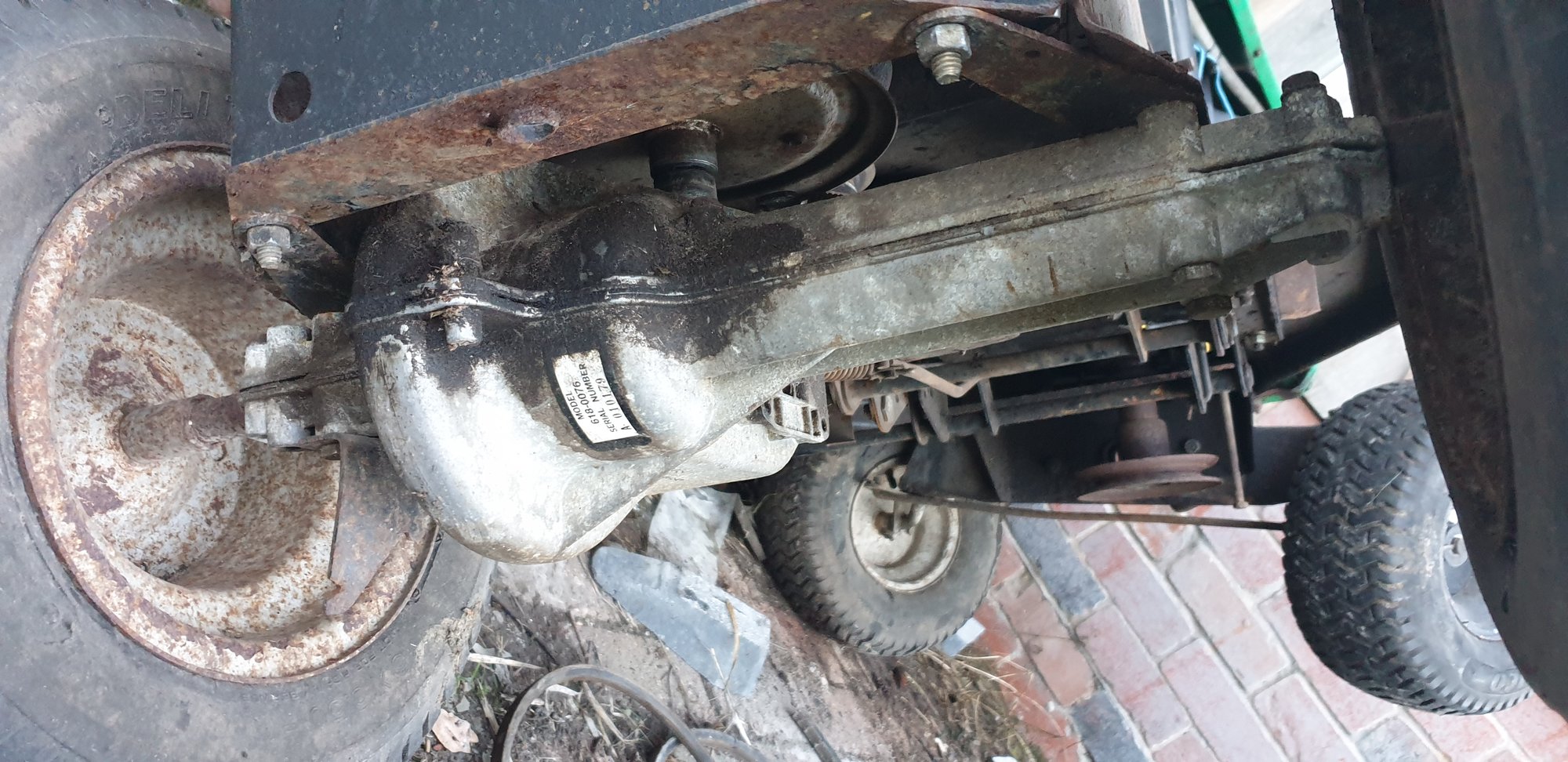

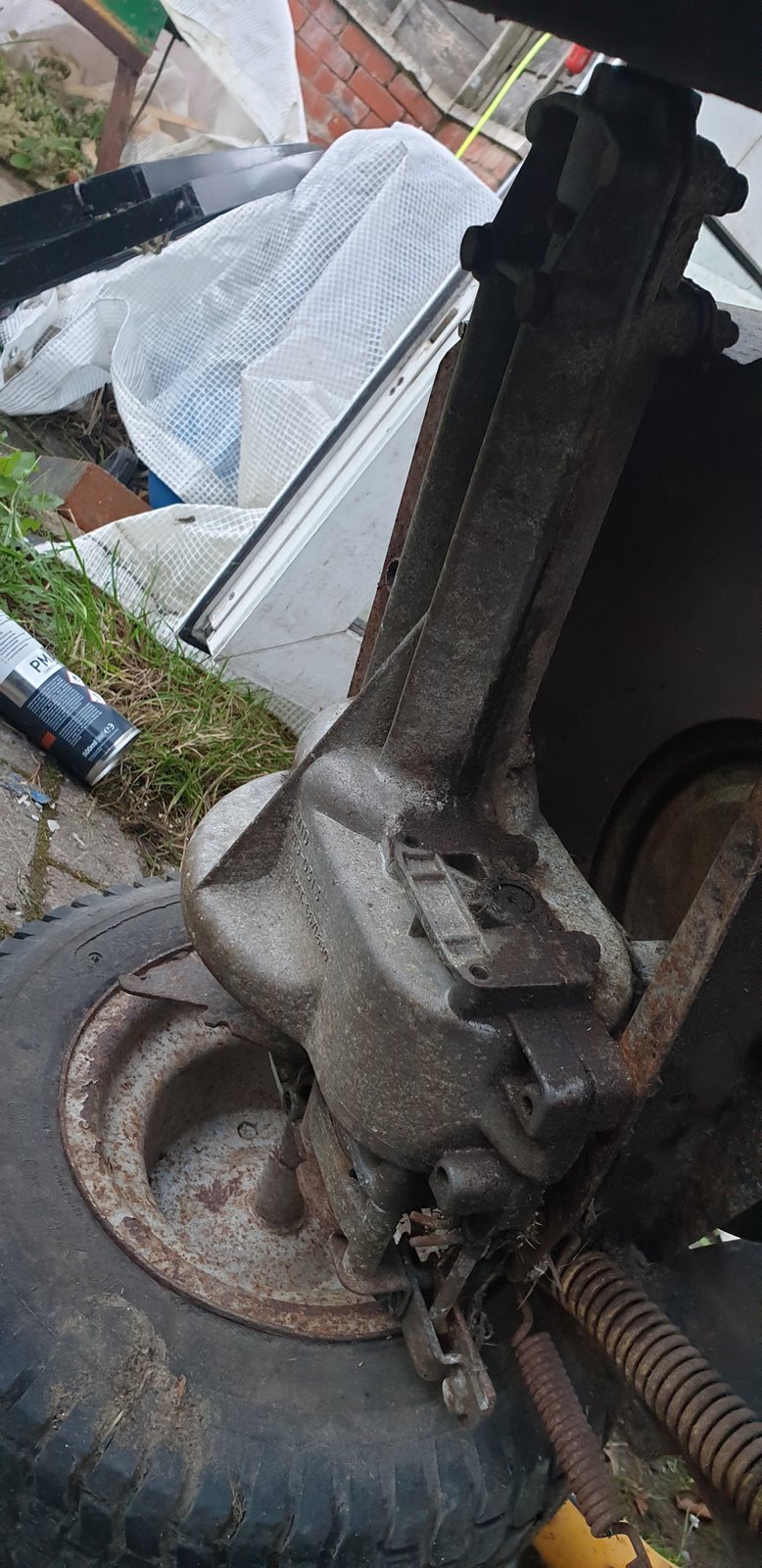

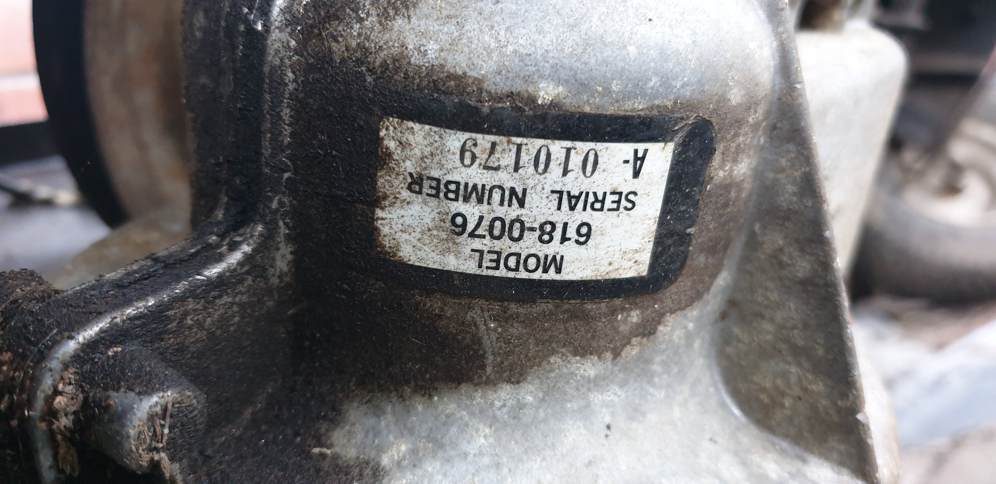

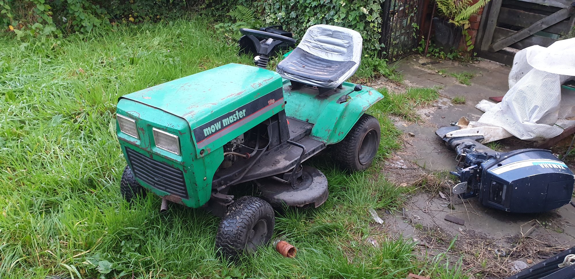

the fwd/rev -axle / diff has an MTD part number 618-0067 the dash looks very MTD like

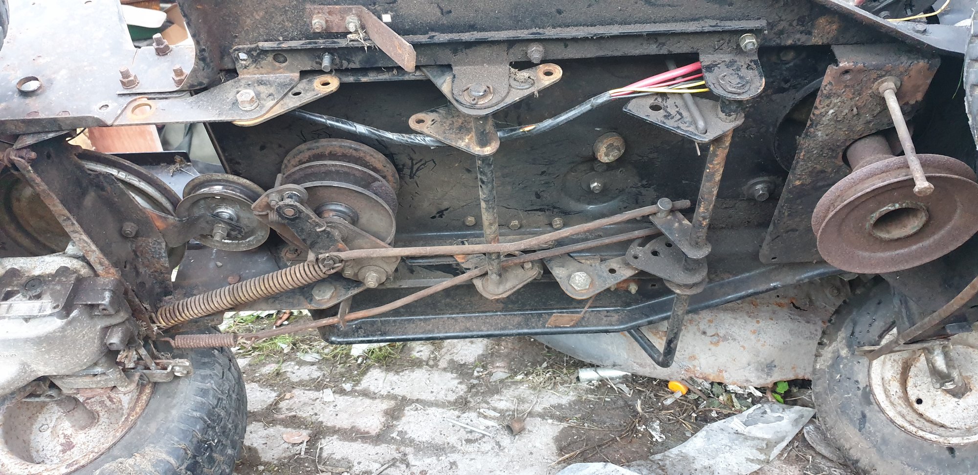

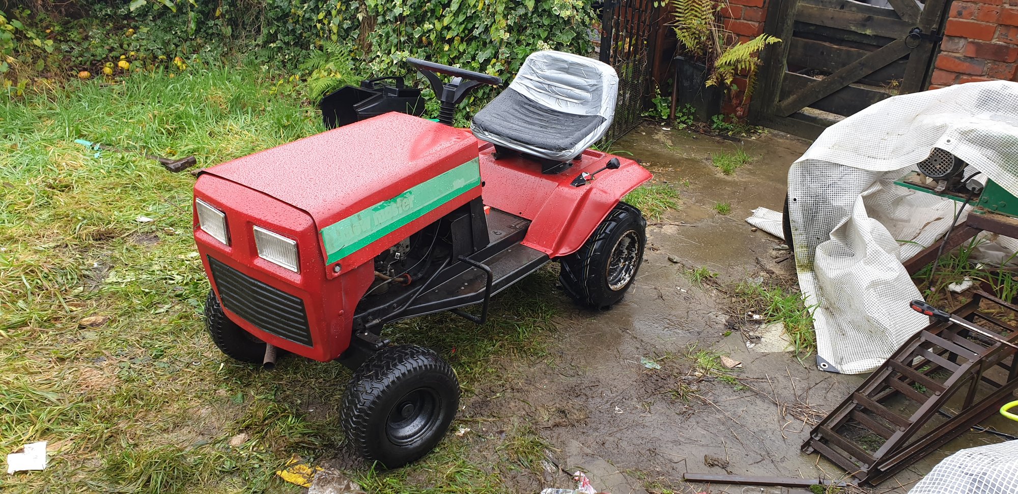

the centre pulley ( F ) is actually the bit that gives it variable speeds there is a belt either side ot the centre moving part
the front plate ( part G) between the top & bottom engine pulley has to be removed to install the front belt
you may also have to unbolt the gearlever bracket ( H )
the lower belt goes from the top engine small pulley to the upper groove on the variable pulley
the upper belt on the variable pulley goes to the axle with the sprung loaded idler ( E ) on the back of the belt

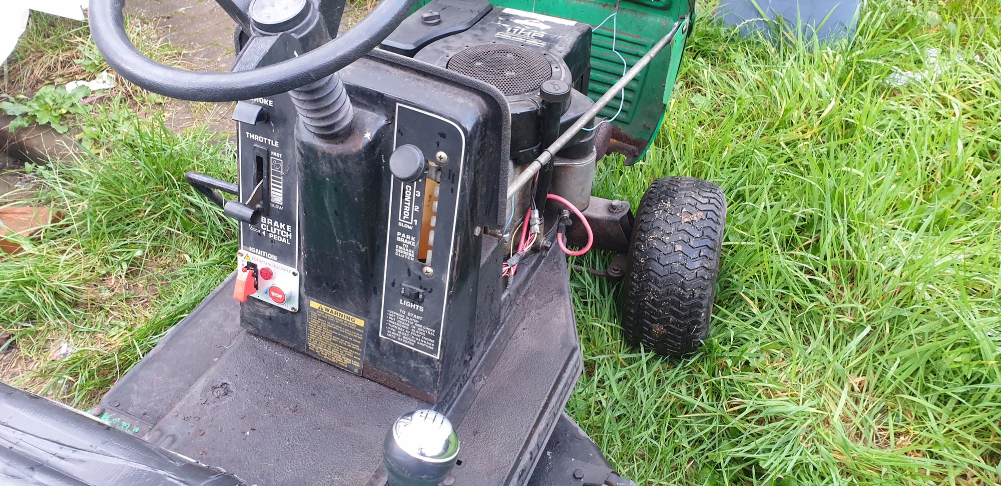

the variable pulley moves using the speed control lever on the right hand of the steering column
the clutch / brake pedal also works the variable speed to the maximum set by the control lever
the belt numbers are likely to be 754-0280 (front) & 754-0281 (rear) but will need confirming with the model number ( it could be near the seat)
there are belts on ebay just be cautious as they are USA sizes ( ie 5/8 section ) ( not A or B section ) and the Kevlar wrapped ones last longer
