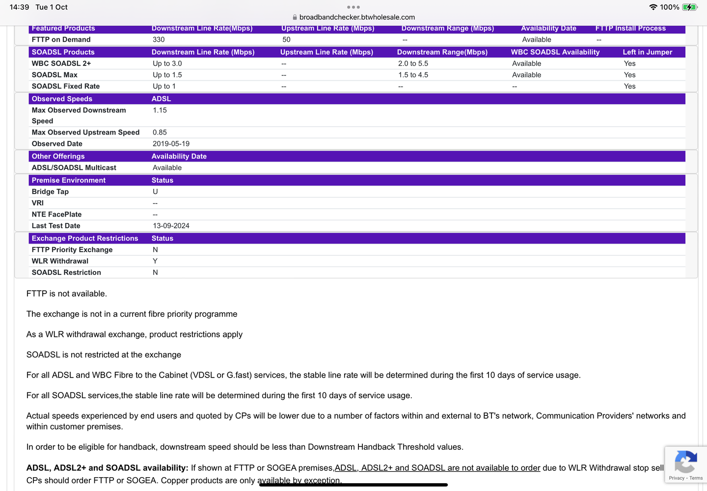

His line is copper all the way back to the exchange, maybe 4 or 5km. Possibly "exchange only" meaning there's no cabinet involved. Or maybe too far from the cabinet for VDSL, so FTTC isn't available.
